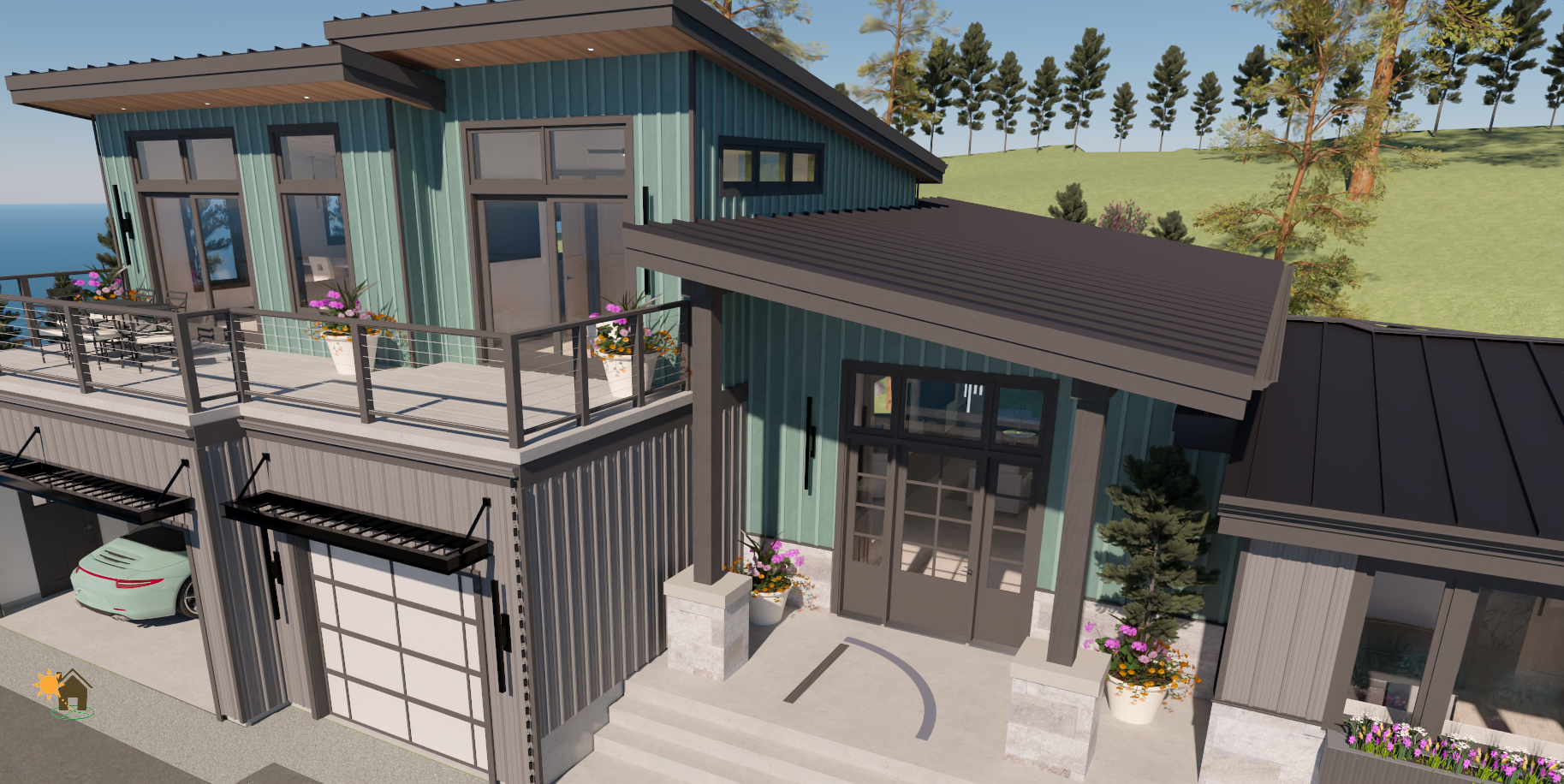

Solution scottharris Posted June 2 Solution Share Posted June 2 X18 is in development with some exciting new features. We expect to preview an open beta version in early July. A final release is expected later in the summer. This rendering shows off 3D siding and roofing. 3 2 Link to comment Share on other sites More sharing options...

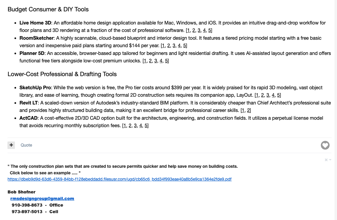

basketballman Posted yesterday at 02:40 PM Share Posted yesterday at 02:40 PM Don't know how Chief is gonna compete with the many free and low cost alternatives that are now available. Below are just a few; even Revit now has a lower cost option to chief A.I .has leveled the playing field in terms of beautiful 3D renderings and accurate detailed material and labor take offs . Why spend big bucks if you no longer need to. Budget Consumer & DIY Tools Live Home 3D: An affordable home design application available for Mac, Windows, and iOS. It provides an intuitive drag-and-drop workflow for floor plans and 3D rendering at a fraction of the cost of professional software. [1, 2, 3, 4, 5] RoomSketcher: A highly scannable, cloud-based blueprint and interior design tool. It features a tiered pricing model starting with a free basic version and inexpensive paid plans starting around $144 per year. [1, 2, 3, 4, 5] Planner 5D: An accessible, browser-based app tailored for beginners and light residential drafting. It uses AI-assisted layout generation and offers functional free tiers alongside low-cost premium unlocks. [1, 2, 3, 4, 5] Lower-Cost Professional & Drafting Tools SketchUp Pro: While the web version is free, the Pro tier costs around $399 per year. It is widely praised for its rapid 3D modeling, vast object library, and ease of learning, though creating formal 2D construction sets requires its companion app, LayOut. [1, 2, 3, 4, 5] Revit LT: A scaled-down version of Autodesk’s industry-standard BIM platform. It is considerably cheaper than Chief Architect’s professional suite and provides highly structured building data, making it an excellent bridge for professional career skills. [1, 2] ActCAD: A cost-effective 2D/3D CAD option built for the architecture, engineering, and construction fields. It utilizes a perpetual license model that avoids recurring monthly subscription fees. [1, 2, 3, 4, 5] Link to comment Share on other sites More sharing options...
portrait Posted yesterday at 03:06 PM Share Posted yesterday at 03:06 PM Well said. That being said, I still don’t think any of these programs can really compete with Chief Architect for residential design, especially in terms of user-friendliness, the relatively easy learning curve, the large built-in library, and the speed of producing presentable residential drawings and renderings. At the moment, AI’s first major impact on building design software seems to be in rendering and visualization. That is already changing very quickly. But I think this is only the beginning of a much larger shift. People are already starting to use AI to create plug-ins and small custom tools for their specific needs, especially for platforms like Revit, SketchUp, Rhino, Blender, etc. In a few years, I believe this kind of customization may become a normal expectation in design software. Chief currently has very limited customization options and does not support external plug-ins in the way some other platforms do. Personally, I am not a big fan of depending too much on plug-ins, because they can complicate a workflow and create compatibility issues. However, sooner or later, I think many users will expect to have that option available. The next stage may be even more interesting. Maybe not immediately, but perhaps in 5–6 years, AI could help people create highly specialized design software from scratch for very specific purposes. For example, instead of using one large general-purpose program and trying to adapt it to every workflow, a small office might be able to create a custom residential design tool tailored exactly to its own standards, drawing style, local code requirements, libraries, schedules, templates, and documentation process. This does not necessarily mean that large established programs like Chief, Revit, or SketchUp will disappear. More likely, they will need to become more flexible and more open to customization. Chief has a very strong base because it understands residential design extremely well. But as AI makes custom tools and plug-ins easier to create, I think users will increasingly expect software to adapt to their workflow, rather than forcing every user into the same workflow. 24 minutes ago, basketballman said: Don't know how Chief is gonna compete with the many free and low cost alternatives that are now available. Below are just a few; even Revit now has a lower cost option to chief A.I .has leveled the playing field in terms of beautiful 3D renderings and accurate detailed material and labor take offs . Why spend big bucks if you no longer need to. Budget Consumer & DIY Tools Live Home 3D: An affordable home design application available for Mac, Windows, and iOS. It provides an intuitive drag-and-drop workflow for floor plans and 3D rendering at a fraction of the cost of professional software. [1, 2, 3, 4, 5] RoomSketcher: A highly scannable, cloud-based blueprint and interior design tool. It features a tiered pricing model starting with a free basic version and inexpensive paid plans starting around $144 per year. [1, 2, 3, 4, 5] Planner 5D: An accessible, browser-based app tailored for beginners and light residential drafting. It uses AI-assisted layout generation and offers functional free tiers alongside low-cost premium unlocks. [1, 2, 3, 4, 5 Lower-Cost Professional & Drafting Tools SketchUp Pro: While the web version is free, the Pro tier costs around $399 per year. It is widely praised for its rapid 3D modeling, vast object library, and ease of learning, though creating formal 2D construction sets requires its companion app, LayOut. [1, 2, 3, 4, 5] Revit LT: A scaled-down version of Autodesk’s industry-standard BIM platform. It is considerably cheaper than Chief Architect’s professional suite and provides highly structured building data, making it an excellent bridge for professional career skills. [1, 2] ActCAD: A cost-effective 2D/3D CAD option built for the architecture, engineering, and construction fields. It utilizes a perpetual license model that avoids recurring monthly subscription fees. [1, 2, 3, 4, 5] Link to comment Share on other sites More sharing options...
para-CAD Posted yesterday at 04:58 PM Share Posted yesterday at 04:58 PM This appears AI generated. That's like phoning it in. 1 1 Link to comment Share on other sites More sharing options...
