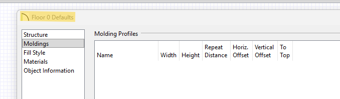

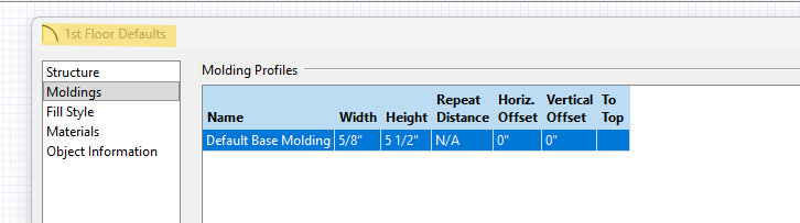

EmmaCox Posted December 4, 2025 Share Posted December 4, 2025 Hello, I'm trying to figure out how to deafult base molding for floor 0. I have it set up for floor 1, but my issue is on my template file I don't have floor 0 created yet, as I wait to draw the main floor and then build the foundation (floor 0) based on the main floor footprint. So in the default settings there is only floor 1 showing, no floor 0. I tried building the foundation plan on my template file, then adding the default baseboard, then deleting the foundation to see if the setting would stay, but it goes back to no base molding. Any ideas on how to add to add this? Should I already have floor 0 created on my template file? Thanks in advance! Link to comment Share on other sites More sharing options...

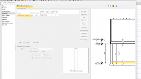

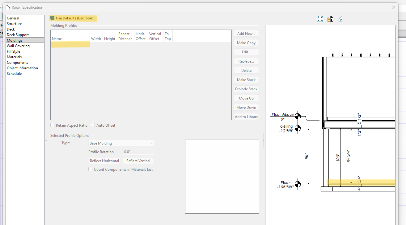

EmmaCox Posted December 5, 2025 Author Share Posted December 5, 2025 Thanks everyone for your input! After much thinking I think I will keep using floor 1 as main floor and floor 0 as foundation / basement if I can make it work. I can work around the baseboard issue once the foundation / basement plan is made I can then add molding to the entire floor level (or just the finished areas in each room). 10 hours ago, joey_martin said: @EmmaCox once you add some rooms to the basement the default base trim should be there. Check your template plan to ensure you don't have trim turned off by default and now it isn't showing. I leave it on and just remove it from unfinished areas, so you should have base trim in there. @joey_martin it's not showing the default baseboard trim even specific to rooms, only on the foundation / basement plan. For example, bedroom room type the default is to have baseboard trim on, once I create the foundation / basement plan I make the entire area bedroom room type, and it shows no baseboard. Link to comment Share on other sites More sharing options...

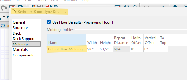

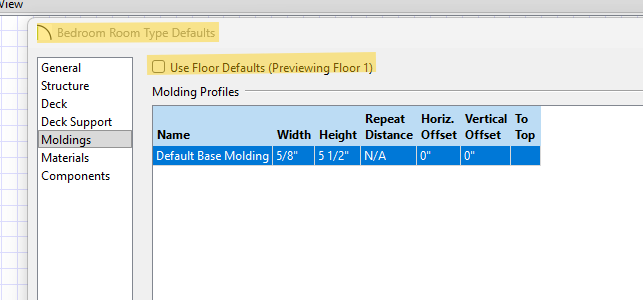

JonathanK Posted December 5, 2025 Share Posted December 5, 2025 (edited) @EmmaCox Are you 100% positive that you edited the molding in the room type through the Default Settings? I just tried what you said in your last post, and it works for me when I change my room type to Bedroom. Can you just do a test plan and attach it here so we can poke around? EDIT: I think I see the issue. On your room type default box, UNCHECK the "Use Floor Defaults" box. Then set the molding that you want to use for it. That should get it done for you. Edited December 5, 2025 by JonathanK NA Link to comment Share on other sites More sharing options...

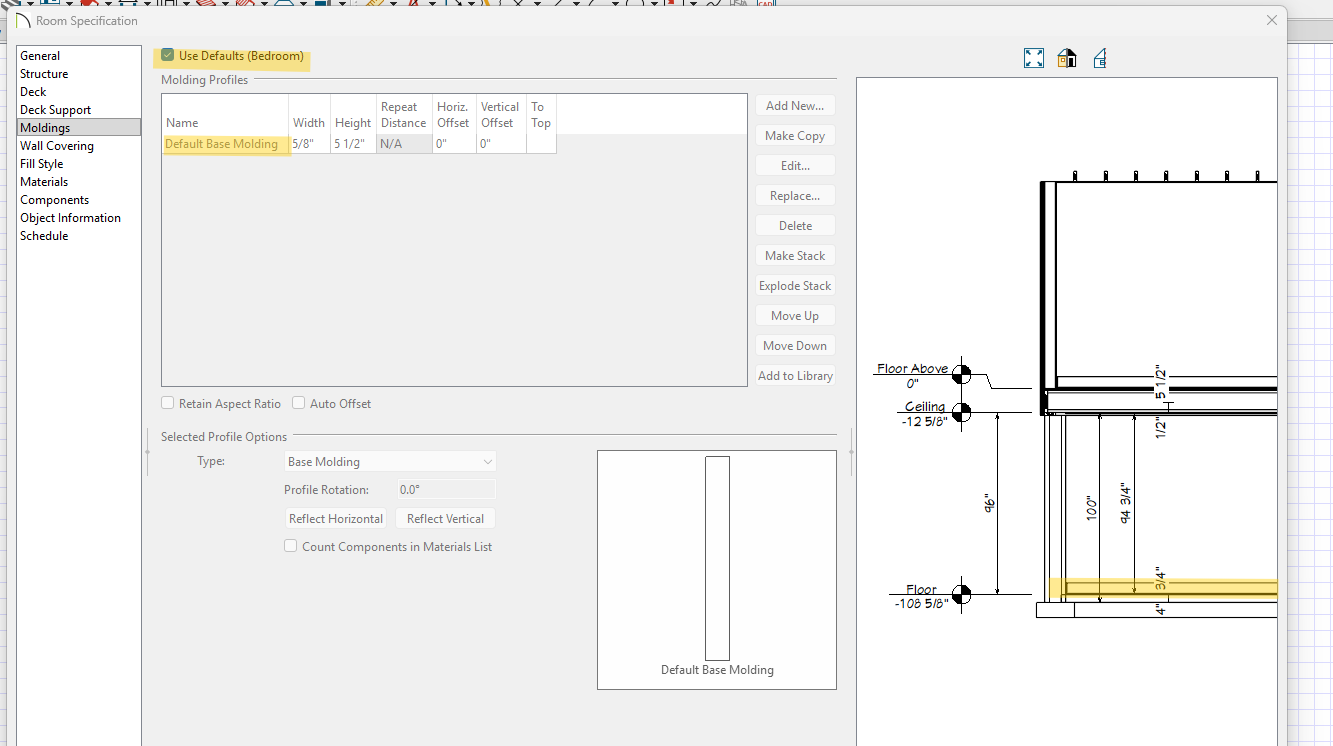

JonathanK Posted December 5, 2025 Share Posted December 5, 2025 (edited) @EmmaCox I think I see the issue. On your room type default box, under moldings UNCHECK the "Use Floor Defaults" box at the top. Then set the molding that you want to use for it. That should get it done for you. Edited December 5, 2025 by JonathanK clarity Link to comment Share on other sites More sharing options...
EmmaCox Posted December 5, 2025 Author Share Posted December 5, 2025 (edited) 4 minutes ago, JonathanK said: @EmmaCox I think I see the issue. On your room type default box, UNCHECK the "Use Floor Defaults" box. Then set the molding that you want to use for it. That should get it done for you. @JonathanKThat worked, thank you! Guess I will need to uncheck that option on all room types. Edited December 5, 2025 by EmmaCox Link to comment Share on other sites More sharing options...
JonathanK Posted December 5, 2025 Share Posted December 5, 2025 @EmmaCox To make it easy for you, if you go to Edit>Default Settings>Floors and Rooms>Room Types, before you open the room type, you can click, hold, and drag to select multiple rooms. Then go to Edit on the right side, and edit the moldings. It works even with CTRL + click as well so you can select specific rooms you want to edit (i.e. only the bedrooms, and not the garage and attic, etc...) 1 Link to comment Share on other sites More sharing options...
