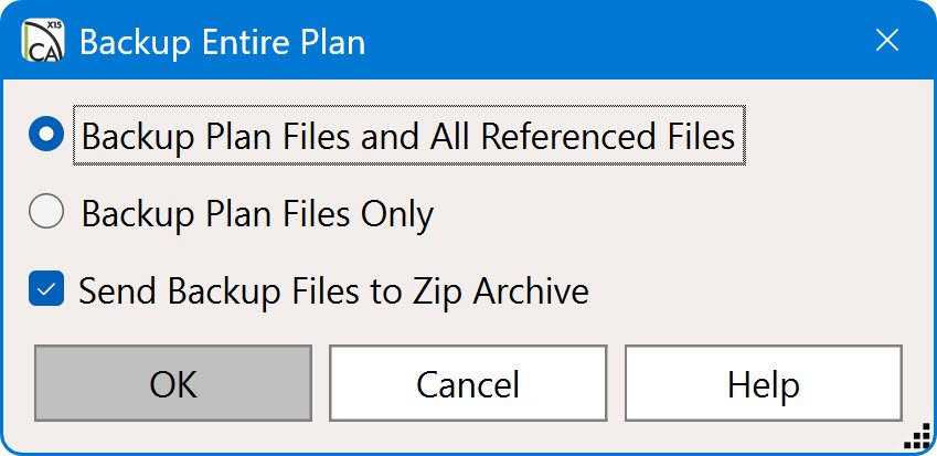

CharlesVolz Posted Thursday at 02:49 PM Share Posted Thursday at 02:49 PM (edited) 3 hours ago, tchomes said: We version our designs during the design process by keeping the .plan and .layout file in sync and using a "letter" to denote version number. Example - Smith Residence a.plan & Smith Residence a.layout. I would suggest not renaming the .plan and the .layout files as a routine. This requires relinking, as you mentioned. That system is more error-prone the more plans you have linked to the layout file and the more users involved. Better to save your versions by saving the project using "File> Backup Entire Plan ..." while in layout, saving it as a zip file and naming those zip files in a meaningful archival way. This also keeps all your materials and referenced files together which is helpful if you are not using Project Management. [Edit: Sorry Bob! We replied together...] Best, Charles Edited Thursday at 02:51 PM by CharlesVolz Link to comment Share on other sites More sharing options...

tchomes Posted Thursday at 10:03 PM Author Share Posted Thursday at 10:03 PM Thanks everyone! Glad to know that i am not alone. I have requested for Chief to turn off the automatic view updates when relinking a file to save us time and liability for views being updated that we don't necessarily need or want to be updated. I am ok with check box that states "Update all linked views" and the user can choose to check it or not. Charles, I understand your approach, but that would create "thousands" of unnecessary files. As we get to the sixth or more revisions, we would have six copies of a tile image and every other image/material that we used in the plan, which could be hundreds. Then there is the mess of working with zip files and opening them. I do feel this is the best way to export the "full" file and all materials, but we place all of our materials on a general folder on our server that Chief can hit when it opens so that each user has access to any custom materials that were created. Thanks to everyone for their replies. I don't peruse Chief Talk as much as I used to years ago, but glad that it is still a supportive community. Link to comment Share on other sites More sharing options...
CharlesVolz Posted Thursday at 10:07 PM Share Posted Thursday at 10:07 PM 2 minutes ago, tchomes said: Charles, I understand your approach, but that would create "thousands" of unnecessary files. Hard drive space is cheap. Nothing says that you have to keep every old version. That is my preferred approach. But I understand it may not be everyone's preference. Best, Charles Link to comment Share on other sites More sharing options...

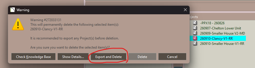

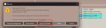

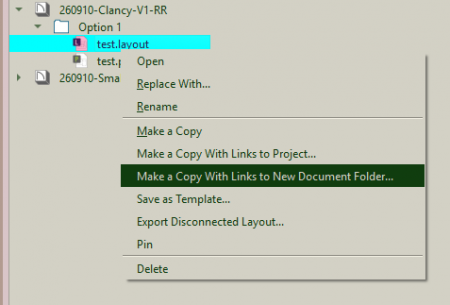

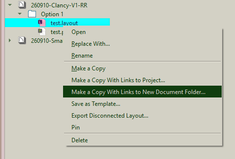

Renerabbitt Posted Friday at 05:36 AM Share Posted Friday at 05:36 AM (edited) fun fact, the templates I sell are project management based. When you include the number of distributed copies multiplied by the number of revisions, patches and updates, testing, these project files have been effectively installed over 10,000 times. There is no better method for distributing projects than project management... it simply takes less management, less instructions, and less networking. Method is simple, in project management, name your project yymmdd-street/client name-version-technicians initials, such as 260910-Clancy-V1-RR. Done with your work, select your project, hit the delete key, Then this pops up Click Export and Delete Export it to your NAS/Cloud etc. When the next person needs to work on it, they just go to the cloud location and double click it to open it It's a single file that contains all assets. It also can contain additional information and multiple design iterations. There is also no easier way to create a design iteration which includes a layout pre-linked with populated views, but independent from the design it originated from Which results in: Just to reiterate about how to share with a team...you get to press a button(delete key), then click a button(export) to store a single file (with all of its incluuded images assets/pdfs/design iterations/other files) on your favorite cloud service for the next person to work on. The only complicated part about the inter-office sharing part of this, is training people to unlearn the complicated things they were doing before PM was created. If people want to learn about the more complex things you can do in project management, such as creating warehouse detail plans, complicated link swapping, reference file swaps, and pre-loaded linked layout templates etc. PM can do some crazy things, but sharing across a team is not a complicated part of PM, its just ..Delete...click...done. Edited Friday at 05:45 AM by Renerabbitt 1 1 Link to comment Share on other sites More sharing options...

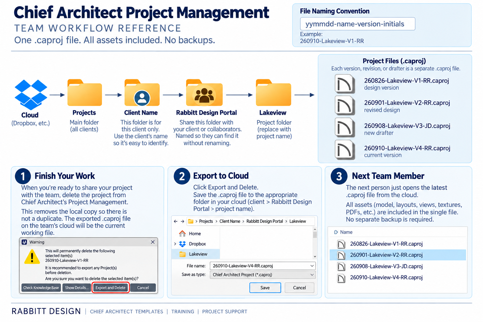

Renerabbitt Posted Friday at 08:37 PM Share Posted Friday at 08:37 PM (edited) Distribute this graphic to a team Edited Friday at 08:41 PM by Renerabbitt 1 Link to comment Share on other sites More sharing options...
