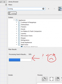

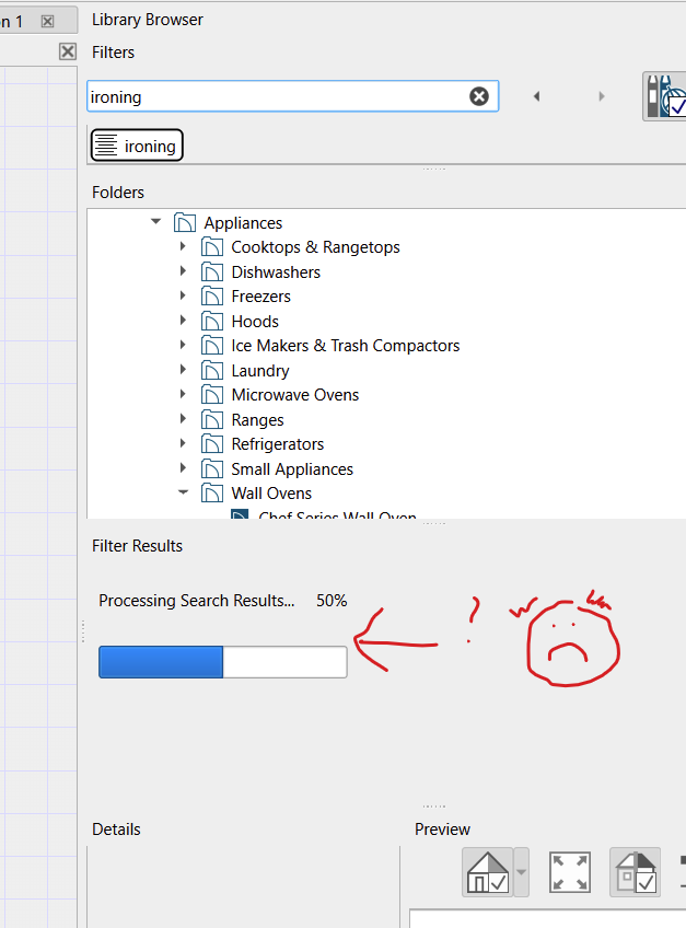

JKEdmo Posted August 12 Share Posted August 12 (edited) Switched over to X18 and noticed I often get the blue spinny Windows "circle of lag" when I try to drag and drop a Library Browser item into my plan. Don't remember this in X17. Any fix for this? I think this was brought up in a previous thread, but couldn't find it. Thanks again, Jim Edited August 12 by JKEdmo Image added Link to comment Share on other sites More sharing options...
Eric_S Posted August 12 Share Posted August 12 15 minutes ago, JKEdmo said: Switched over to X18 and noticed I often get the blue spinny Windows "circle of lag" when I try to drag and drop a Library Browser item into my plan. Don't remember this in X17. Any fix for this? I think this was brought up in a previous thread, but couldn't find it. Hello Jim, Something that may make a difference is if you have an antivirus program with real-time protection. Since Chief Architect Premier X18.exe is a new program, it may not be in the list of exclusions (whitelist), and you can try adding it, then restarting your computer. Here are some other questions / things to experiment with: Does it happen only for the first selection in a program session? This can take a lot longer as the library browser is initializing. Are you using Project Management? Does it happen the same for items from the core catalogs V.S. your user catalog? Does it happen even with the preview panel hidden? Is your current plan template particularly complicated? Have you cleaned your Temp directory recently? Link to comment Share on other sites More sharing options...
Eric_S Posted August 12 Share Posted August 12 33 minutes ago, JKEdmo said: It looks like I was responding to your post pre-edit. If searching is slow, here are some more troubleshooting options: * Does turning off Include Web Results help? (the top-right icon) * Is your System Library Database Folder on a slower / network drive? Link to comment Share on other sites More sharing options...

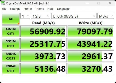

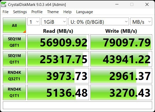

Smn842 Posted August 31 Share Posted August 31 13 hours ago, Renerabbitt said: Ah understood, thank you I'll give it a test when I'm back in the office mon For reference, on a 14900K with 6400Mhz DDR5 (and a lot of background software) this is what I get with the RAM file system I mentioned: This is similar large sequential, but much faster figures for the others than the RAM disk software I used before. Link to comment Share on other sites More sharing options...
