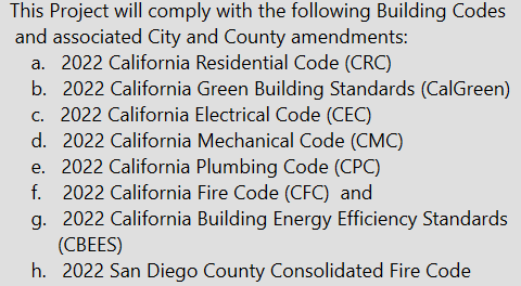

Joe_Carrick Posted October 8 Author Share Posted October 8 (edited) This is an example of the codes list I use in San Diego County. Can you provide a list your jurisdiction requires? I'm trying to create a comprehensive macro for as many locals as possible. Edited October 8 by Joe_Carrick Link to comment Share on other sites More sharing options...

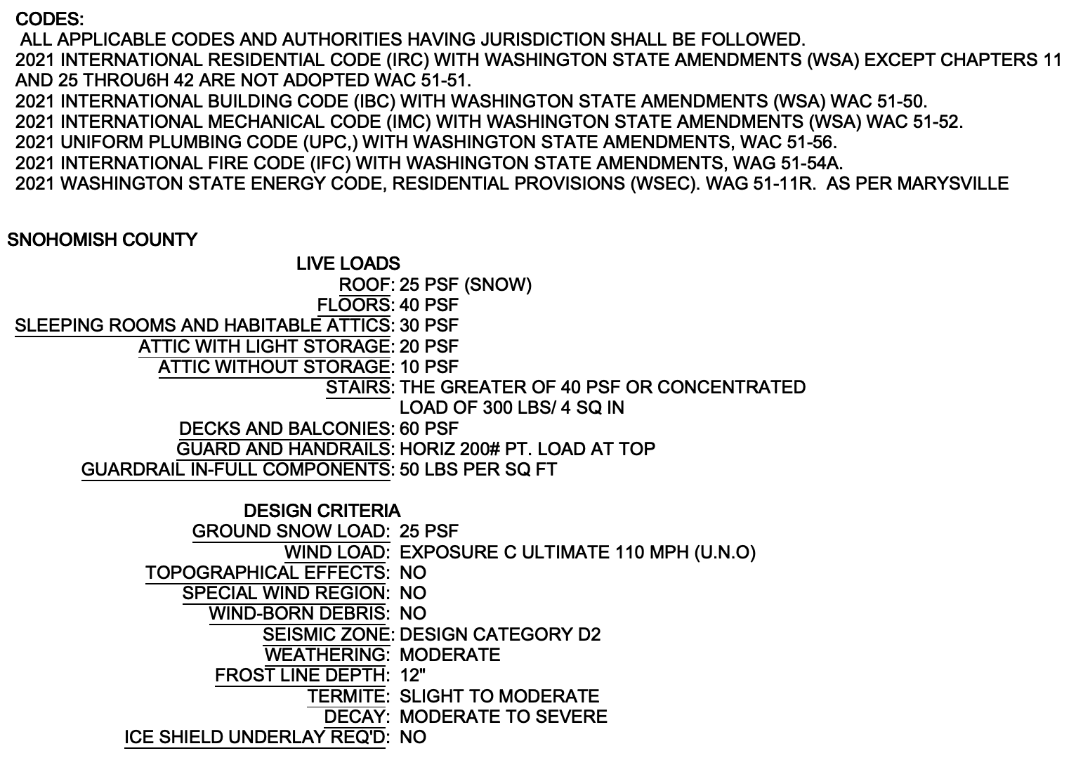

para-CAD Posted October 8 Share Posted October 8 (edited) W. WA state I know you didn't need Design Criteria, but here it is anyway...........it varies slightly by AHJ here (snow loads and seismic mostly) Edited October 8 by para-CAD Link to comment Share on other sites More sharing options...
Joe_Carrick Posted October 8 Author Share Posted October 8 14 minutes ago, para-CAD said: I know you didn't need Design Criteria, but here it is anyway...........it varies slightly by AHJ here (snow loads and seismic mostly) Thanks. Live Loads and Design Criteria I handle separately (as Structural). My "Codes" macro will list the codes for Washington as you show - without the indication of what sections are not adopted. 1 Link to comment Share on other sites More sharing options...

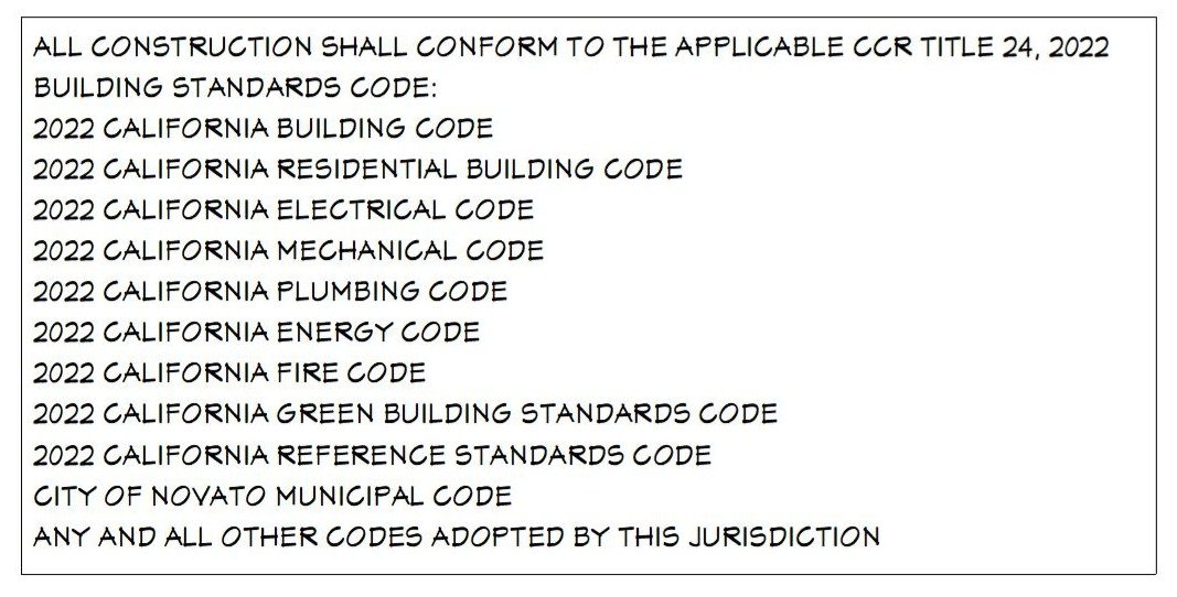

SteveNovato Posted October 8 Share Posted October 8 In the San Francisco Bay Area it seems that every city and county wants additional items from their jurisdiction. I finally added a line "any and all codes adopted by this jurisdiction". Seems to work so far... 1 Link to comment Share on other sites More sharing options...
