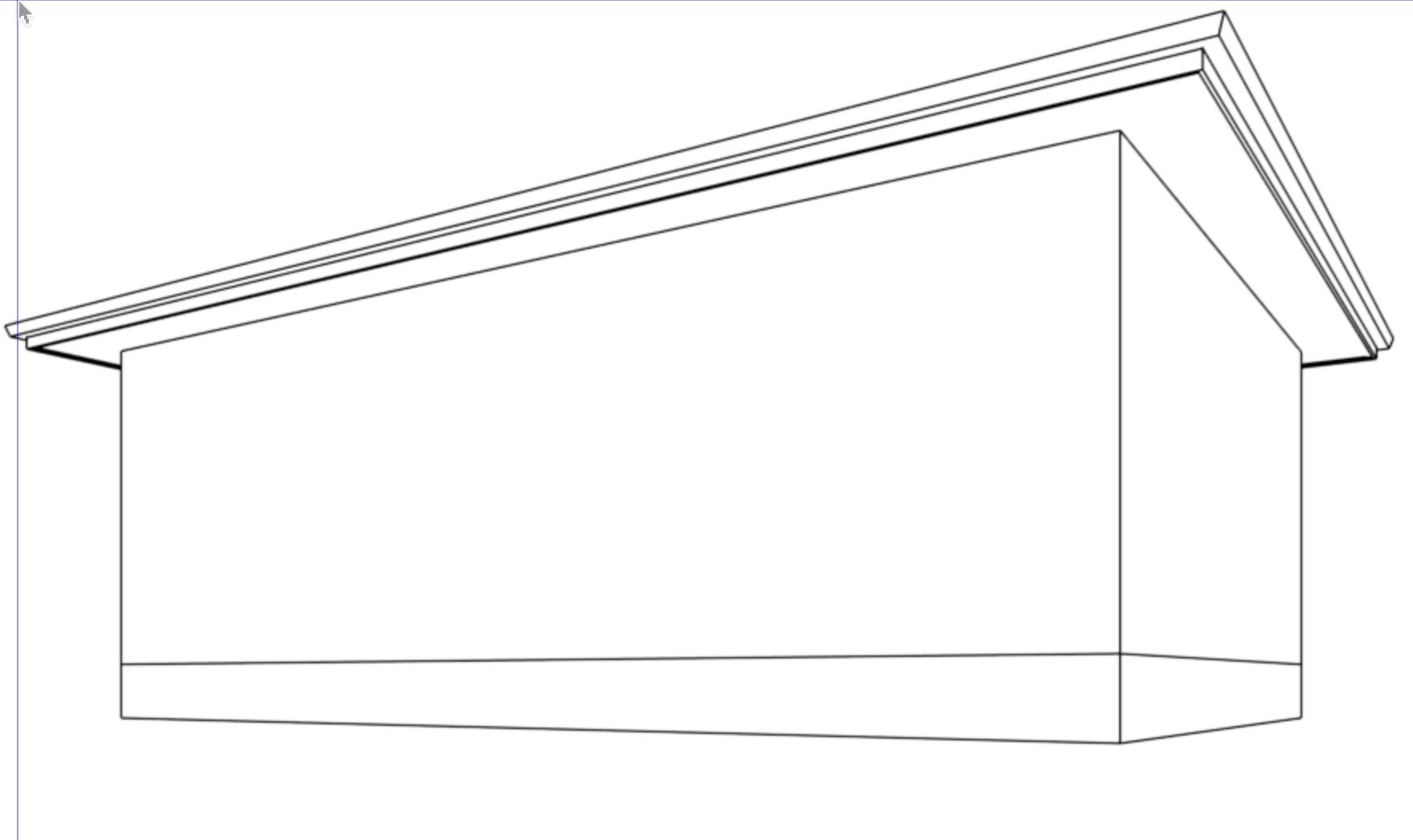

Gawdzira Posted March 21, 2025 Share Posted March 21, 2025 A birds eye view tend to work better with the orthographic full overview. I try to position them at about 30 deg for a true isometric. Link to comment Share on other sites More sharing options...
robdyck Posted March 21, 2025 Share Posted March 21, 2025 14 hours ago, Chrisb222 said: Not exactly the same. Not trying to be argumentative, but it looks the same to me. Perspective crop mode is just a zoom function, no? Create a camera, select PCM, zoom in and then press F6 (Fill Window) which resets the camera view. Undo Zoom tool goes back to the PCM view. It's perhaps a more flexible way of zooming in using the scroll wheel, but I can't tell any difference. Zoom and PCM allow you to zoom in tight on a portion of a view without affecting the camera position. What other benefits do you find using PCM? Link to comment Share on other sites More sharing options...
SHCanada2 Posted March 21, 2025 Share Posted March 21, 2025 i tend to interpret birds eye view as not directly on top, but further away. As I question the value of mostly roof...but then again I am asked to do this mostly from a sales perspective, not a technical perspective Link to comment Share on other sites More sharing options...
Alaskan_Son Posted March 21, 2025 Share Posted March 21, 2025 On 3/19/2025 at 5:45 AM, decorators3 said: l need it in PB for an MLS listing You can also optionally use a standard Orthographic Camera, 3D>View Direction>Front View, and Edit Active View>Camera>Options and set Field of View to 10 (the lowest it will go). This won't be perfect, but its close. This may be what Robert was alluding to when he said... On 3/19/2025 at 3:11 PM, robdyck said: ....for exterior views, positioning the camera much further away from the house and then reducing the camera view angle (NOT using the Zoom tool). By the way, I think the real ticket was what Robert mentioned just before that... On 3/19/2025 at 3:11 PM, robdyck said: using the zoom tool which can be used for smaller details, or for exterior views, the camera can be positioned much further away and then 'cropped' using the Zoom tool He seemed to be mostly responding to Chris' mention of the Perspective Crop tool. but it was also a very good option for creating a PBR of a nearly Orthographic View. You just need to be viewing front the front, Zoom way out, and then use the Zoom tool to crop your view (zoom back in again). Link to comment Share on other sites More sharing options...
Alaskan_Son Posted March 21, 2025 Share Posted March 21, 2025 3 hours ago, robdyck said: Not trying to be argumentative, but it looks the same to me. Perspective crop mode is just a zoom function, no? Create a camera, select PCM, zoom in and then press F6 (Fill Window) which resets the camera view. Undo Zoom tool goes back to the PCM view. It's perhaps a more flexible way of zooming in using the scroll wheel, but I can't tell any difference. Zoom and PCM allow you to zoom in tight on a portion of a view without affecting the camera position. What other benefits do you find using PCM? You're right that Perspective Crop Mode is very similar to the Zoom tool. I still use it when working with very small details though for some of the exact reasons you mention...it allows for infinite zoom while freely panning, orbiting, and scroll-wheel zooming with my mouse. The zoom tool is not nearly as fluid and easy to use. Link to comment Share on other sites More sharing options...
Chrisb222 Posted March 21, 2025 Share Posted March 21, 2025 6 hours ago, robdyck said: Not trying to be argumentative, but it looks the same to me. I didn't say they were totally different, I said they're not exactly the same. One of the main differences in MY workflow is being able to deactivate Perspective Crop Mode, which returns the camera to it's normal foreshortening behavior, allowing me to tailor perspective views in ways I can't using the more simple Zoom tool. For instance, activate PCM, zoom a little, orbit a little, deactivate and zoom in/out, orbit, reactivate. It gives me great flexibility in fine-tuning a view. You may operate differently, and that's ok. In fact, PCM completely eliminated my need for the Zoom tool, and I have none of them on my toolbar because PCM and the scroll wheel do all they do and more, in one tool. It really is a great tool that shouldn't be deprecated, IMO. 6 hours ago, robdyck said: Perspective crop mode is just a zoom function, no? No. 6 hours ago, robdyck said: It's perhaps a more flexible way of zooming in using the scroll wheel Thanks for agreeing they're not exactly the same. Link to comment Share on other sites More sharing options...
