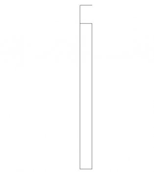

cjanderson66 Posted May 12, 2023 Share Posted May 12, 2023 Has anybody got any idea of how to do a recessed Baseboard detail like the one shown here. I have a contemporary style home and the client wants this as the base. I have no idea of how to show this to him in my renderings. Link to comment Share on other sites More sharing options...
TeaTime Posted May 12, 2023 Share Posted May 12, 2023 Huh. Ponywalls would probably be the easiest...depending on what your walls look like. Though honestly that's such a small detail for renderings I'd probably just apply a low, thin Wall Covering a little darker than the wall color, then just mock up some detail elsewhere. 2 1 Link to comment Share on other sites More sharing options...
TeaTime Posted May 12, 2023 Share Posted May 12, 2023 Though the benefit of the ponywall is that the base attaches to the lower wall, so it essentially automatically recesses -- I set my lower wall to have 1/16" drywall, just to avoid seeing framing: 2 1 Link to comment Share on other sites More sharing options...

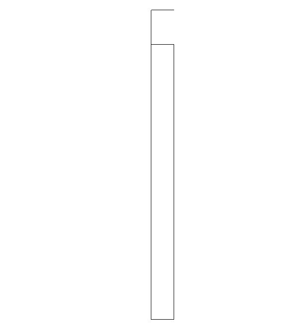

Adam_Gibson Posted August 16, 2025 Share Posted August 16, 2025 (edited) Rene's video prompted me to find a simpler way: Create a recessed baseboard like the one attached. Change the walls into pony walls, with the lower wall being a copy of the upper wall. Give the lower pony wall a 0” drywall thickness on both or one sides, depending on whether it's interior or exterior. Make the lower wall height the same as the baseboard plus the floor thickness (same color too, if that's the look). Align the main layers, if needed. Save the molding and wall types. You're done. Edited August 16, 2025 by Adam_Gibson 1 Link to comment Share on other sites More sharing options...
