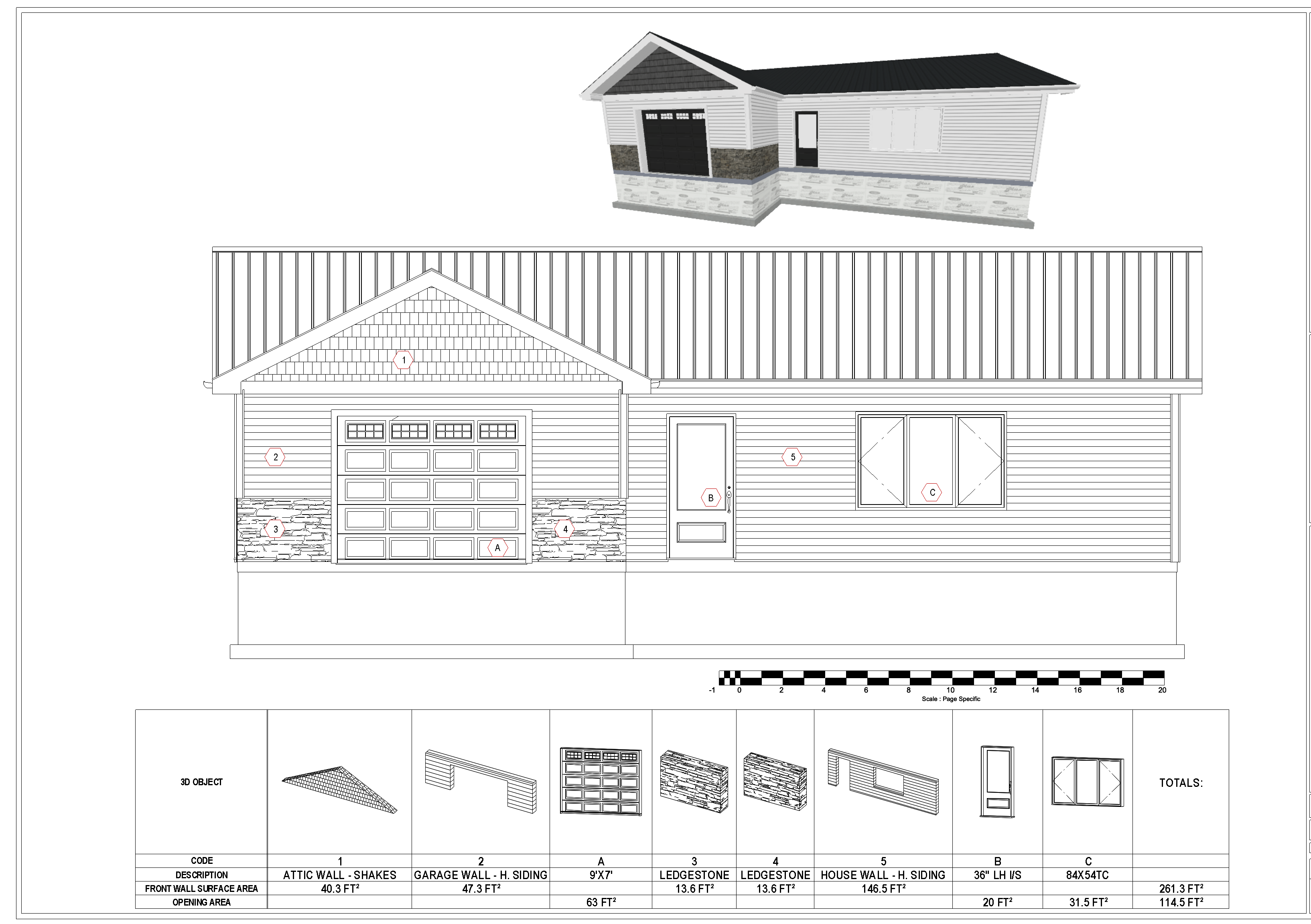

joey_martin Posted December 22, 2025 Share Posted December 22, 2025 The information lives in the materials list but, while in elevation camera create a polyline and aim that polyline to a custom schedule. 1 Link to comment Share on other sites More sharing options...

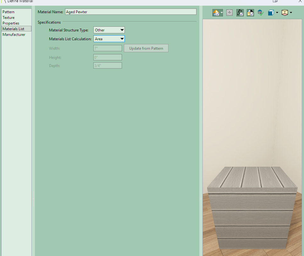

JiAngelo Posted December 24, 2025 Share Posted December 24, 2025 My problem is the materials selected. For instance, James Hardie lap siding reports in linear feet, as does Certainteed's D5 Monogram siding. My contractors charge by the square foot. Changing all the walls to stucco or Certainteed Board & Batten would give me the correct square footage, but it is easier for me to add a 0 width layer for paint to the siding walls and get their square footage when necessary. I can ignore the paint color if I don't need it. (And its not a paint color anyone ever selects inside the home.) Link to comment Share on other sites More sharing options...

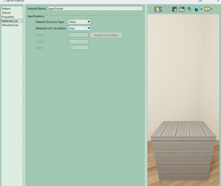

tundra_dweller Posted December 24, 2025 Share Posted December 24, 2025 (edited) 51 minutes ago, JiAngelo said: For instance, James Hardie lap siding reports in linear feet, as does Certainteed's D5 Monogram siding. You can control how a material reports qty to the material list with the "Adjust Material Definition" tool. Also I'm thinking maybe a material region with air gap as material might be a quick way to tally up siding coverage in sq ft. I don't remember if you can assign material regions to schedules at the moment though. Edited December 24, 2025 by tundra_dweller Link to comment Share on other sites More sharing options...

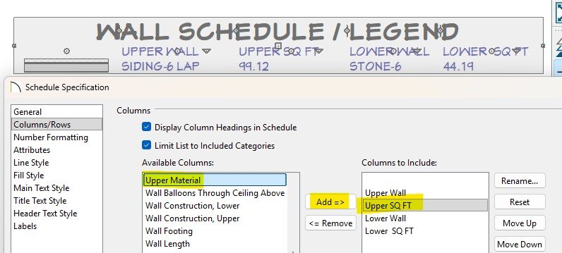

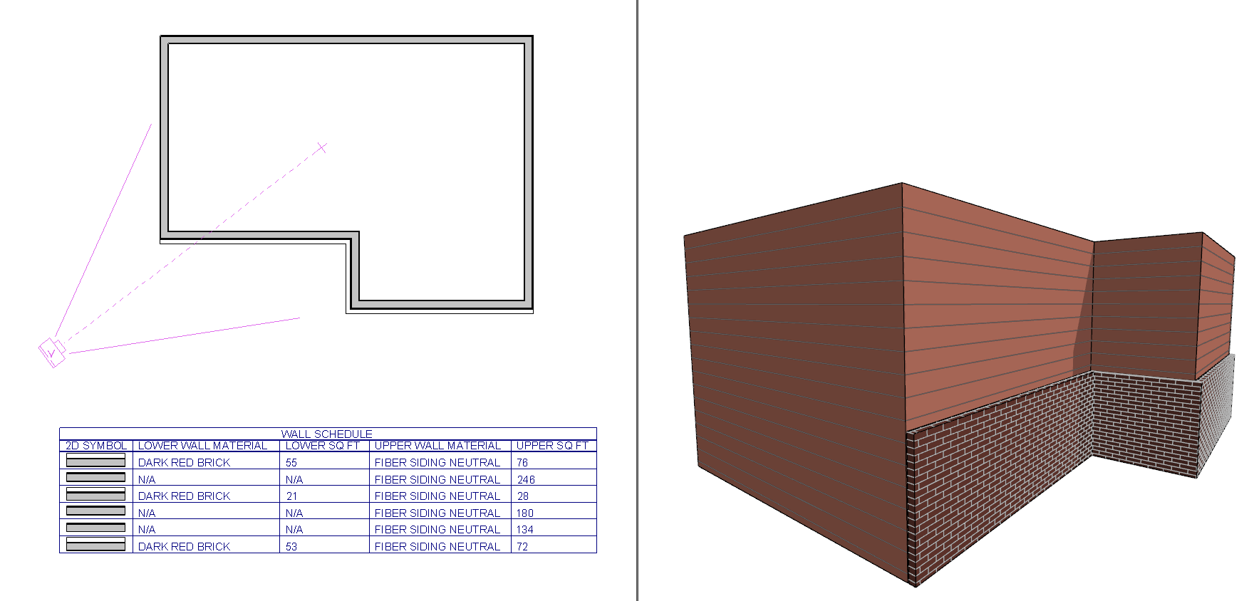

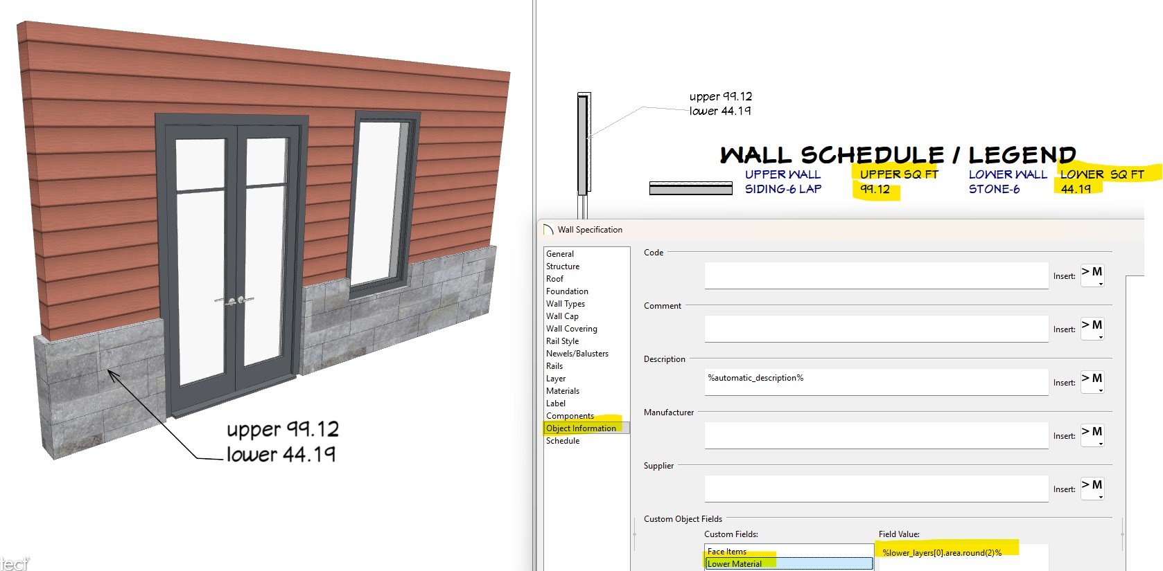

scottharris Posted December 26, 2025 Share Posted December 26, 2025 You might try using a macro on your wall in the ‘object information’ panel. Then, you can use that variable in your schedule. Note walls can have an upper and lower; and, the [0] is the outer layer of your wall. I exported the wall with the macro if you want to import it. Macros: %upper_layers[0].area.round(2)% %lower_layers[0].area.round(2)% Wall SQ-FT.calibz 2 1 Link to comment Share on other sites More sharing options...

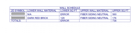

Chrisb222 Posted December 31, 2025 Share Posted December 31, 2025 (edited) On 12/26/2025 at 1:28 PM, scottharris said: You might try using a macro on your wall in the ‘object information’ panel. Scott, I'm getting an error when there isn't a pony wall. I got the script to recognize the presence - or lack - of a pony wall, however every wall segment with a different sq ft area generates its own row in the schedule. I also couldn't use the Total command to sum the areas of the wall segments. 1: Is there a way to cause the schedule to combine all like wall types into one row, regardless of differing sq ft areas? 2: Can the schedule total numeric results of macro scripts? Edited January 2 by Chrisb222 Link to comment Share on other sites More sharing options...
DBCooper Posted December 31, 2025 Share Posted December 31, 2025 (edited) Quote 1: Is there a way to cause the schedule in the attached example file to combine all like wall types into one row, regardless of differing sq ft areas? 2: Can the schedule total numeric results of macro scripts? I almost got it. You need to set your sq ft custom object fields to "format as a number" and then you can set your schedule to "calculate total" and "sum similar rows" for these columns. Unfortunately, your custom macro gives you an "error" for the non-pony walls but this might be something you can fix in your custom macro by having it just return 0 for these cases instead of "n/a". Edited December 31, 2025 by DBCooper 1 Link to comment Share on other sites More sharing options...

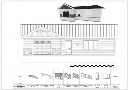

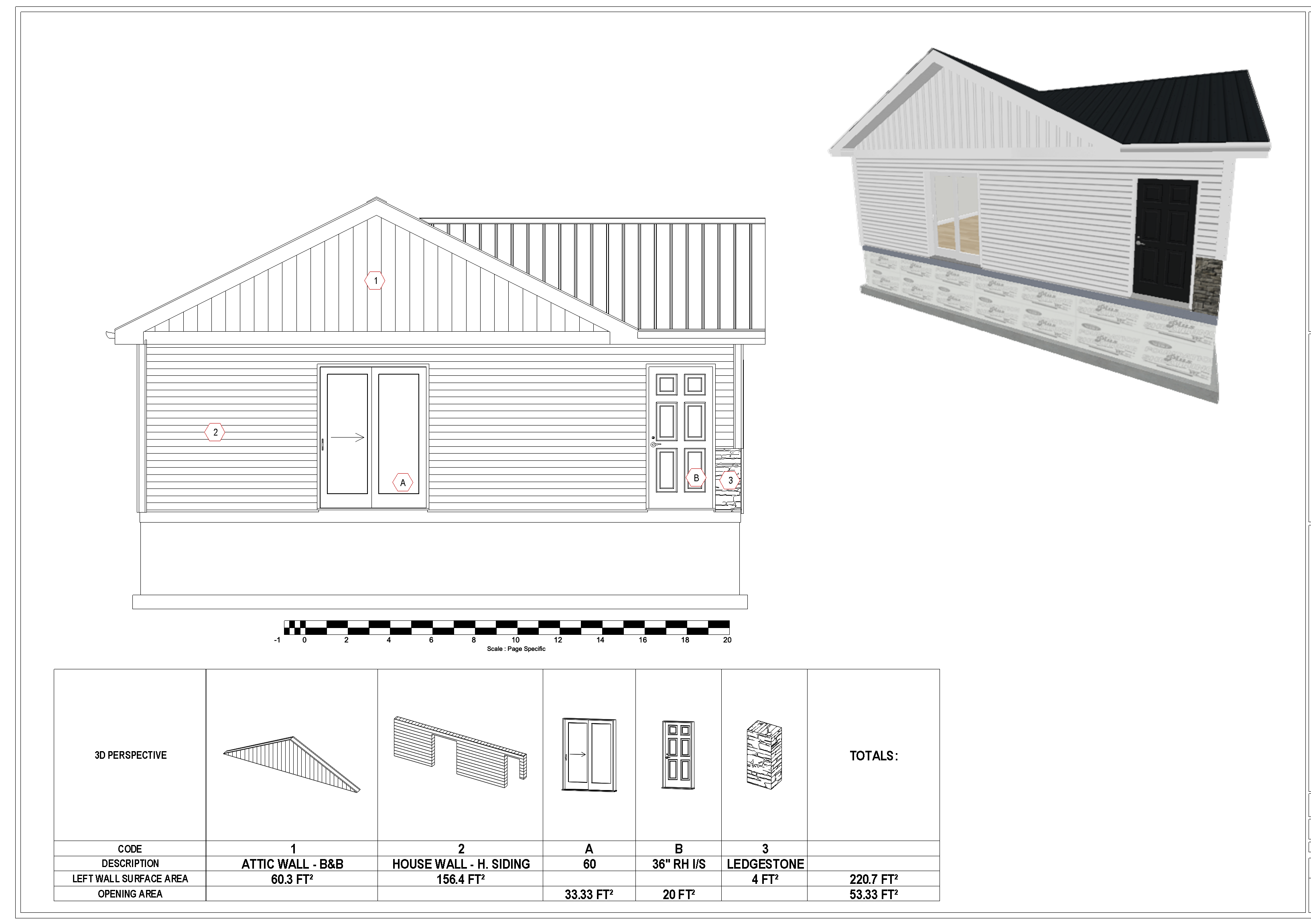

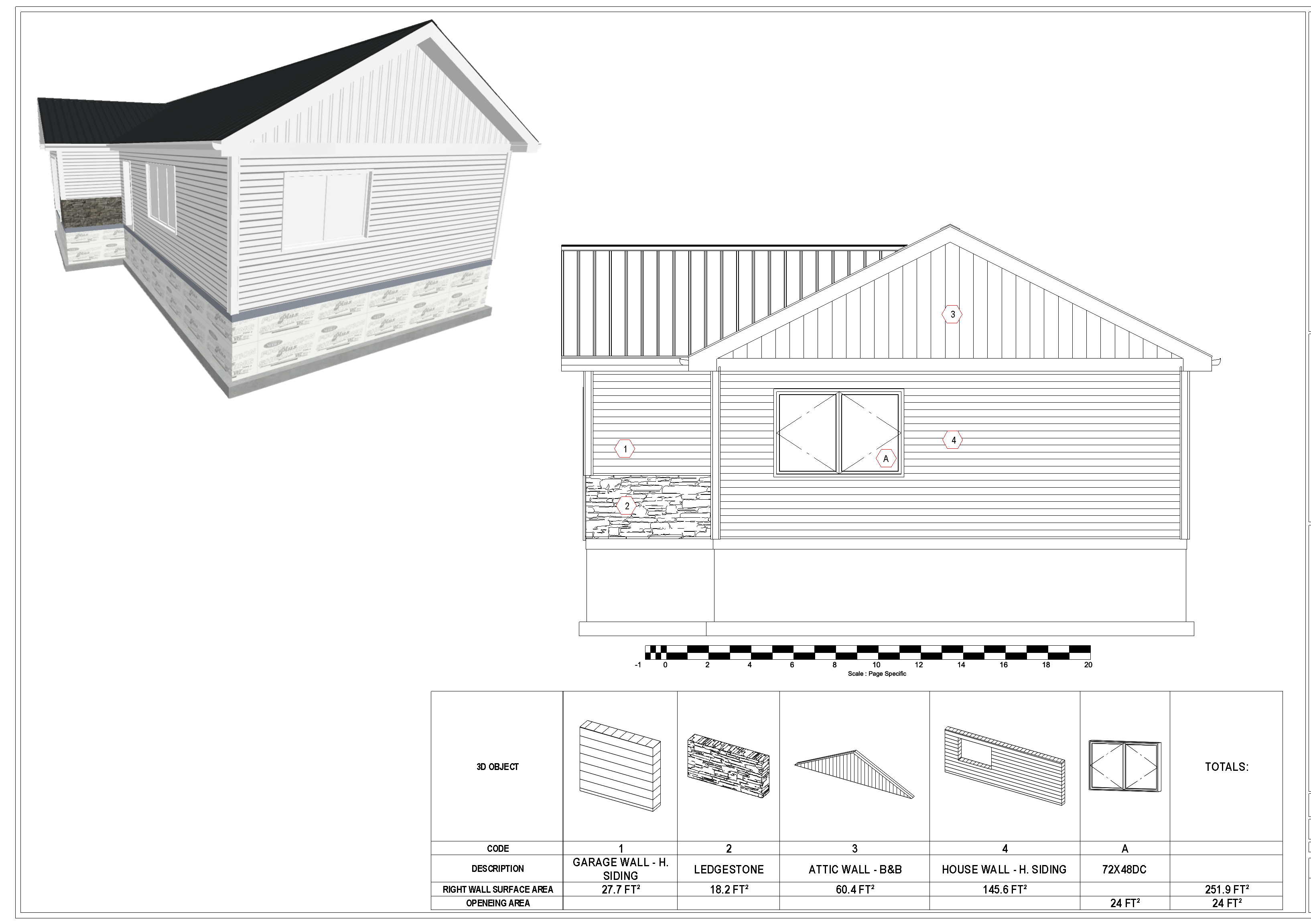

ValleyGuy Posted January 5 Share Posted January 5 @LegacyChief I'm not sure if presentation is a factor, but you can use 3D solids nicely in a schedule too. It's not automatic (polyline method), but visually effective, and only takes a couple more minutes to turn the polylines into solids. It kind of combined three schedules (the window / door schedule, the fenestration schedule, and the exterior finish area schedule) into more clear and elevation specific information tables. Link to comment Share on other sites More sharing options...
Alaskan_Son Posted January 6 Share Posted January 6 On 12/31/2025 at 12:15 PM, DBCooper said: Unfortunately, your custom macro gives you an "error" for the non-pony walls but this might be something you can fix in your custom macro by having it just return 0 for these cases instead of "n/a". Add a simple inline rescue to fix this: %lower_layers[0].area.to_f.round(2) rescue 0% 1 Link to comment Share on other sites More sharing options...
