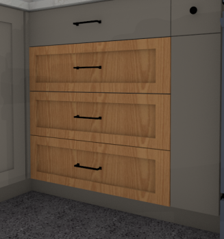

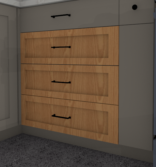

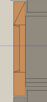

GeneDavis Posted May 3 Share Posted May 3 I wanted 5 piece drawerfronts all drawers below the top slab, and wanting less-wide rails than the stiles, made my own with solids. My drawer stiles are one material, the rails and center panel another. I did this so if I want a natural wood finish, I can get the grain displayed in 3D the way I want. You can see that I get stile/rail delineation just like the blind cab adjacent at left has. That cabinet door is from the OOB Chief library. My drawerfront, if I use the same library material "red oak - natural" for my two materials in the drawerfront, the stiles, and the rail-panel-rail group, comes out like shown in the pic with woodgrain. If I go to the blind corner cab to the left and open for spec, I'll get see one material set for the frame of the door and one for the panel. Assigning wood to the frame results in proper wood graining. What is the difference between Chief's symbol and mine? Link to comment Share on other sites More sharing options...

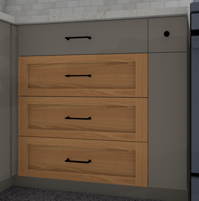

GeneDavis Posted May 3 Author Share Posted May 3 I went and made a rotated copy of Chief's "red oak - natural" texture, and used it to paint the door parts needing it. Pic attached. @DBCooper has me convinced there is some code behind this, and it's used in every door in Chief's libraries that has stile and rails, that was done to make material choice selection easy for users. For us the users (not the losers!) who want to do doors or drawers or cabinet doors with stiles and rails and want to see woodgrain texturing, there is always the workaround of doing it with multiple materials and texturing the way you need. Link to comment Share on other sites More sharing options...

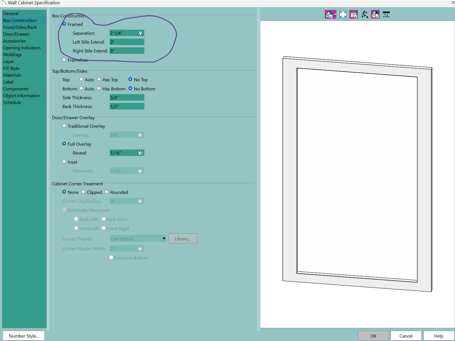

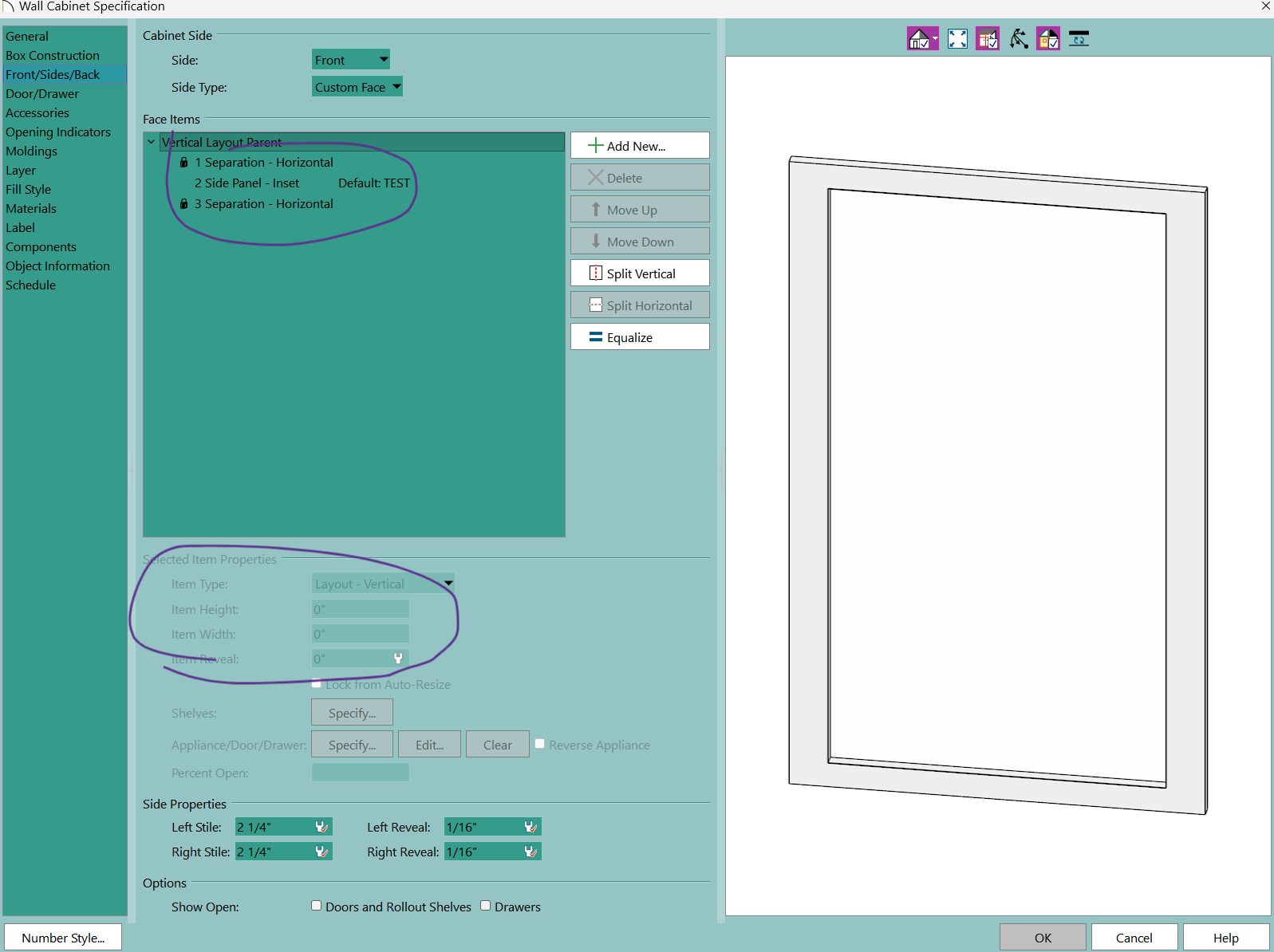

MarkMc Posted May 7 Share Posted May 7 First I make the panel AND the framing beads as a door symbol starting with a countertop with moldings for the framing bead. Convert to cabinet door symbol, rotate during conversion (can also be used as a wainscot symbol for cabinet sides). I set the framing bead molding to the same material I will be using for the frames, I set the panel to something else so I can change it to glass if needed when finished. You could go use solids and molding lines but more work THEN For the frame use a framed wall cabinet with no top, back or sides full overlay. Set separations to suit. Then for the front place your wainscot symbol as a "side panel inset" (so there is no reveal around it, using an inset cabinet will give a reveal). If you set materials as shown above you will still be able to specify all to use the default in the final symbol. The grain will automatically be in the correct direction without copy or rename so you can set your new door to use the default material. Change to drawer as needed. I didn't check to see if still around but years ago and more than once I had posted a "door maker" plan. 1 Link to comment Share on other sites More sharing options...
GeneDavis Posted May 7 Author Share Posted May 7 Thanks, @MarkMc! Make a door or drawerfront from a cabinet! That is out-of-the-box thinking, and you are using Chief's hard-coded grain orientation for the one-click-to-assign-oriented-texture thing. But, I see no way to do the drawerfront I did with its top and bottom rails at 1-1/2" width and its stiles at 2-1/4". How would one make a cabinet's face frame to that spec? Link to comment Share on other sites More sharing options...
MollyNDG Posted May 7 Share Posted May 7 @MarkMc, wow, I love this! I never thought to use a framed cabinet to create the stiles and rails allowing the material to maintain the correct orientations! Thank you so much for this tip, it is going to save me a lot of time and hassle. @GeneDavis You can set the stiles at 2 1/4" under the Box Construction - Framed - Separation; then change the individual separations of the front of the cabinet to 1 1/2" in the Front/Sides/Back panel. Then just be sure to set your stretch planes correctly for the symbol so you don't lose those dimensions. 1 Link to comment Share on other sites More sharing options...

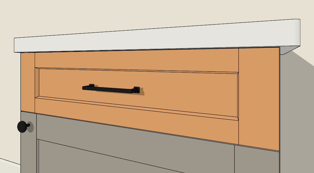

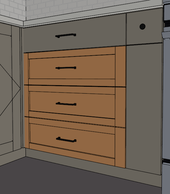

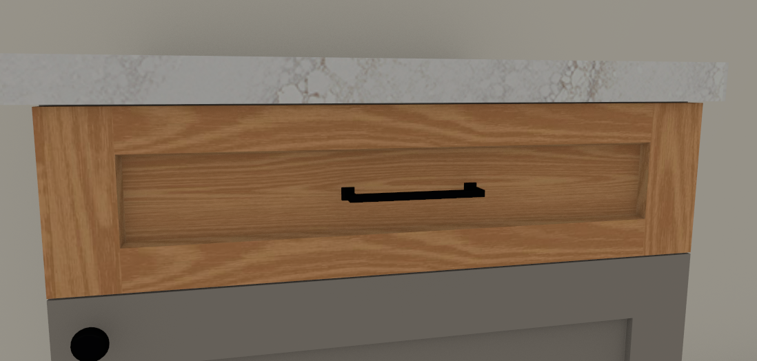

GeneDavis Posted May 8 Author Share Posted May 8 Thanks, @MollyNDG! Worked great, and I gave the recessed panel (the countertop) a little bevel molding to emulate a simple framing bead. See the pics. I can make a second symbol for doors with the wood grain rotated, so my doors and drawerfronts all have the same panel with framing bead. Link to comment Share on other sites More sharing options...
