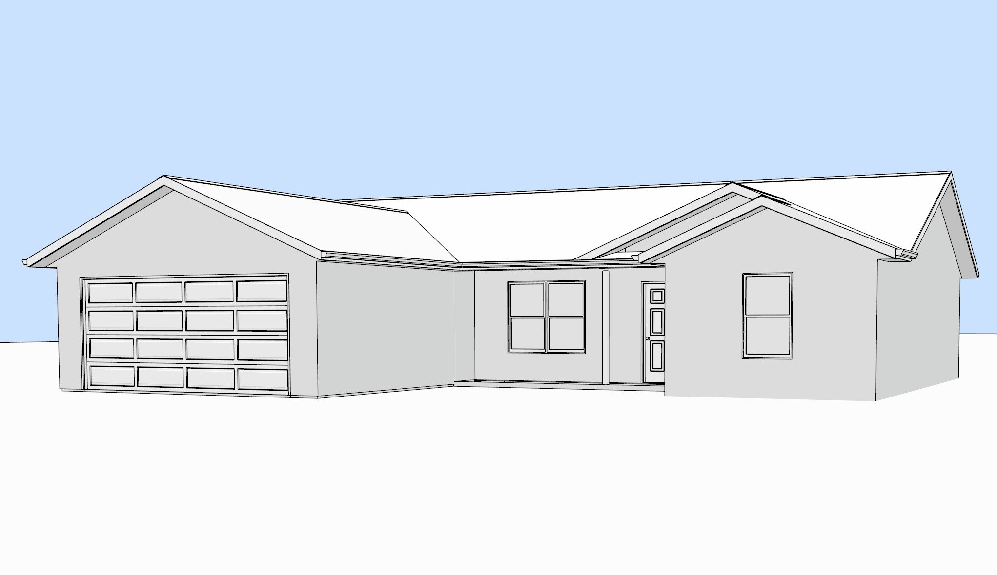

JonathanK Posted Monday at 09:56 PM Share Posted Monday at 09:56 PM Basically...if you upload a Chief render, and say "Make this more realistic", the AI will take all the stuff and enhance it slightly. But it will mostly just use all your textures, etc... But...if you upload a technical illustration and tell it what you want for materials, backgrounds, etc.. then it finds them and applies that to your illustration. The biggest challenge I ran into was that no matter what I did, it was always too clean and cartoony. The technical illustration shows the differences in the sidings, roofing, stone, etc.. so AI has context. You just need to tell it what you want...and it will fill in the gaps. Think rendering engine, not photo enhancer. It will do the photo enhancement, but if you feel like you're hitting a ceiling, that's the next step. 1 Link to comment Share on other sites More sharing options...

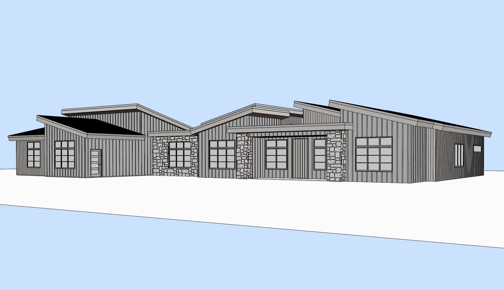

Michael_Gia Posted Tuesday at 10:04 AM Share Posted Tuesday at 10:04 AM (edited) 17 hours ago, JonathanK said: I have found if you want AI to enhance a picture, it takes your textures and basically just makes them looks somewhat "real". But the problem with that is that a lot of the textures in Chief are poorly tile-able. I would be curious if @Joe_Carrick took a Technical Illustration of the same angle on his cabin, and told AI what materials to use for roofing, siding, trims, background, etc... if it would generate a much more realistic looking render. The scene he posted has a lot of context, which AI needs. But it has too much for textures, etc.. so it basically just makes it look "meh" level realistic. You can just feed it an elevation with only the pattern lines, along with the sample swatches of whatever material you want to use, and it will generate the seamless textures itself. like this…. Edited Tuesday at 10:12 AM by Michael_Gia Link to comment Share on other sites More sharing options...

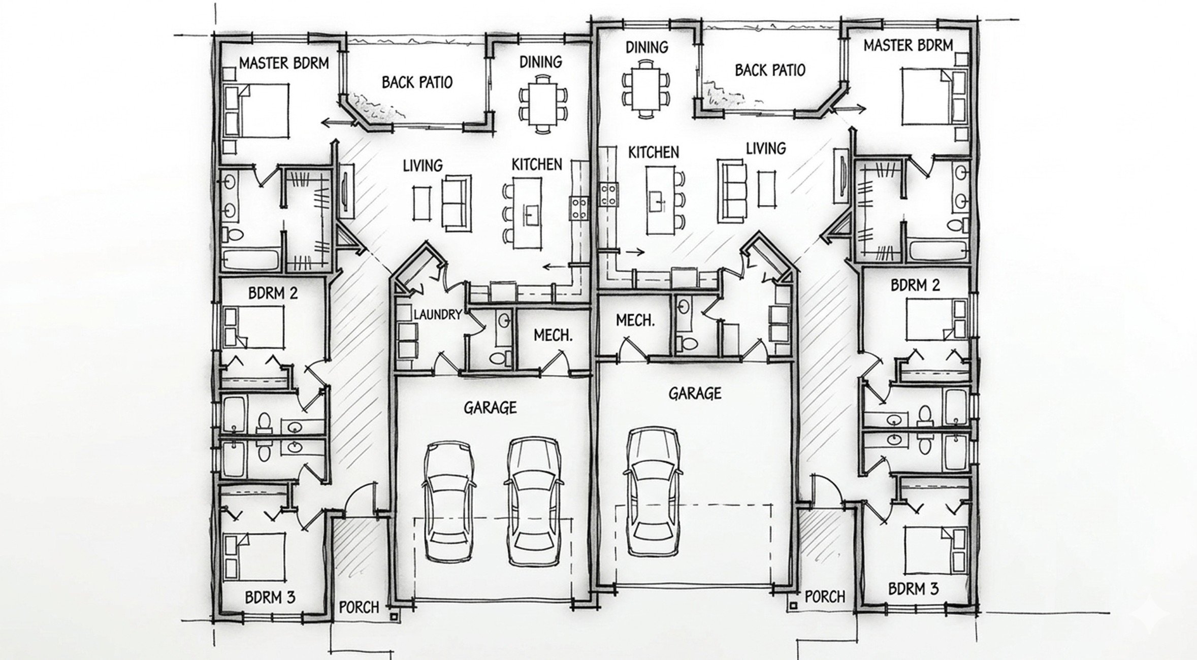

JonathanK Posted Tuesday at 03:55 PM Share Posted Tuesday at 03:55 PM Other options I've dabbled in...but haven't spent a ton of time perfecting these. 1 Link to comment Share on other sites More sharing options...

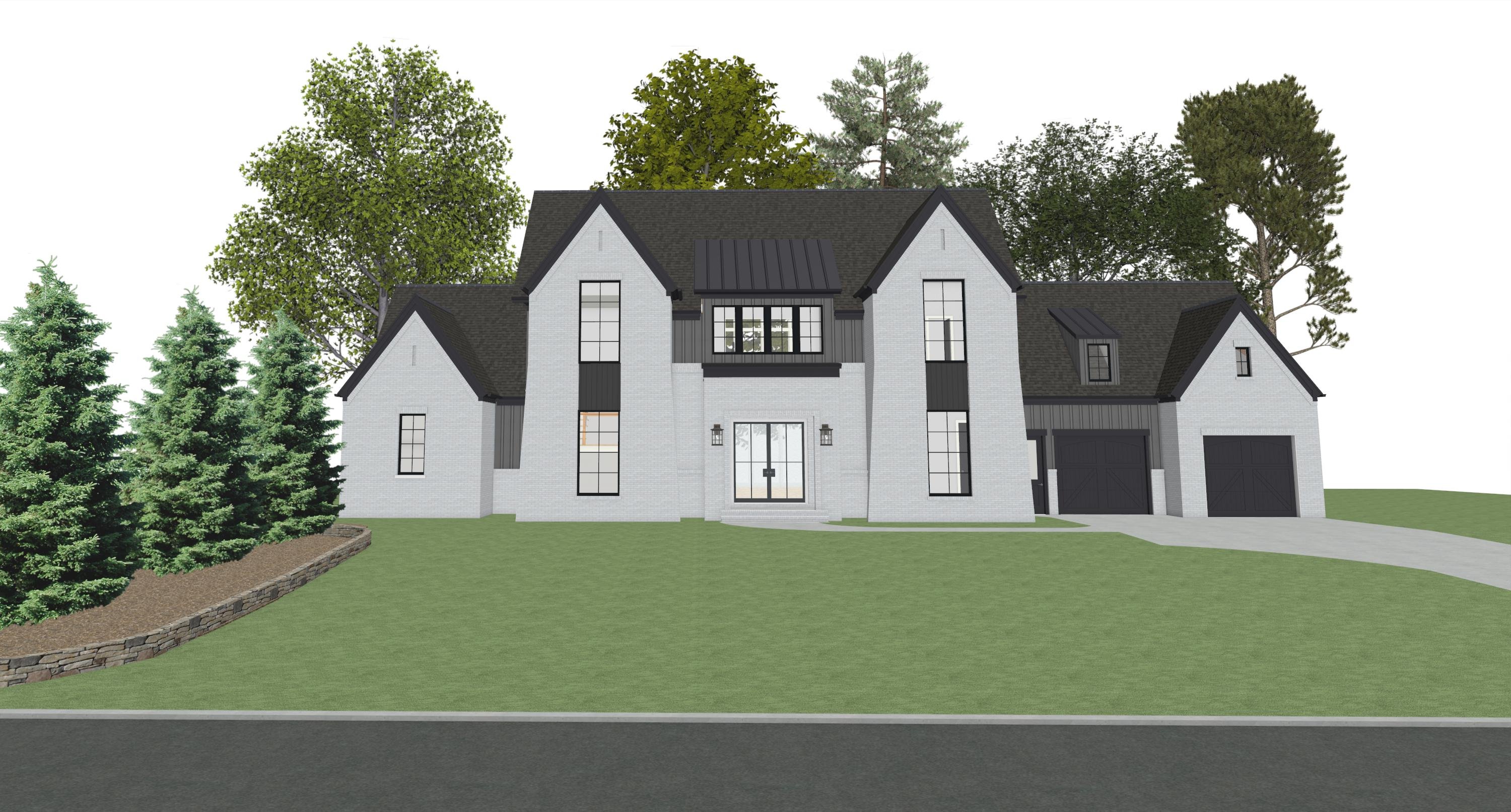

VisualDandD Posted 2 hours ago Share Posted 2 hours ago Been using. Can get finicky at times, but works well. This simple std render where I placed some evergreens that exist in the front yard and gives very good results. I asked for 'golden hour' look. I have experimented with using PBR and found the AI does a much worse job if you start with a more detailed render. I have found the simple standard renderings are a great balance as they convey intended colors...etc, but dont pollute the level of realism that AI will bring to final rendering. 1 Link to comment Share on other sites More sharing options...
JonathanK Posted 1 hour ago Share Posted 1 hour ago @VisualDandD, that looks AMAZING! Great job. 1 Link to comment Share on other sites More sharing options...
VisualDandD Posted 1 hour ago Share Posted 1 hour ago Yes, key I have found is starting with LESS detailed pictures as odd as that sounds. Link to comment Share on other sites More sharing options...
