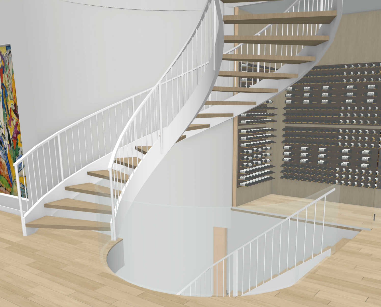

Michael_Gia Posted October 7, 2025 Share Posted October 7, 2025 I want to achieve this style railing. This is what I have created so far. How to get the spindles to go horizontal? If I apply a horizontal tube railing style from the catalogue it does not want to curve and follow the staircase. Is there a style of railing in the catalog that can produce a horizontal 1/2” tube that spirals to follow a spiral staircase like this? Link to comment Share on other sites More sharing options...

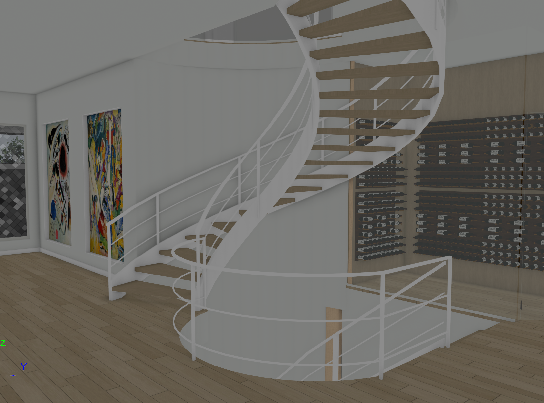

Michael_Gia Posted October 7, 2025 Author Share Posted October 7, 2025 2 hours ago, ericepv said: In the 'Railing' tab of your DBX,select 'Open with Middle Raii' Ok thanks Eric, and as @DBCooper mentioned I was only able to get 2 rails but then I checked, "include bottom rail" and was able to get at least 3 horizontal rails that follow the spiral staircase. Not to code yet but maybe close enough to give the client a visual. Link to comment Share on other sites More sharing options...

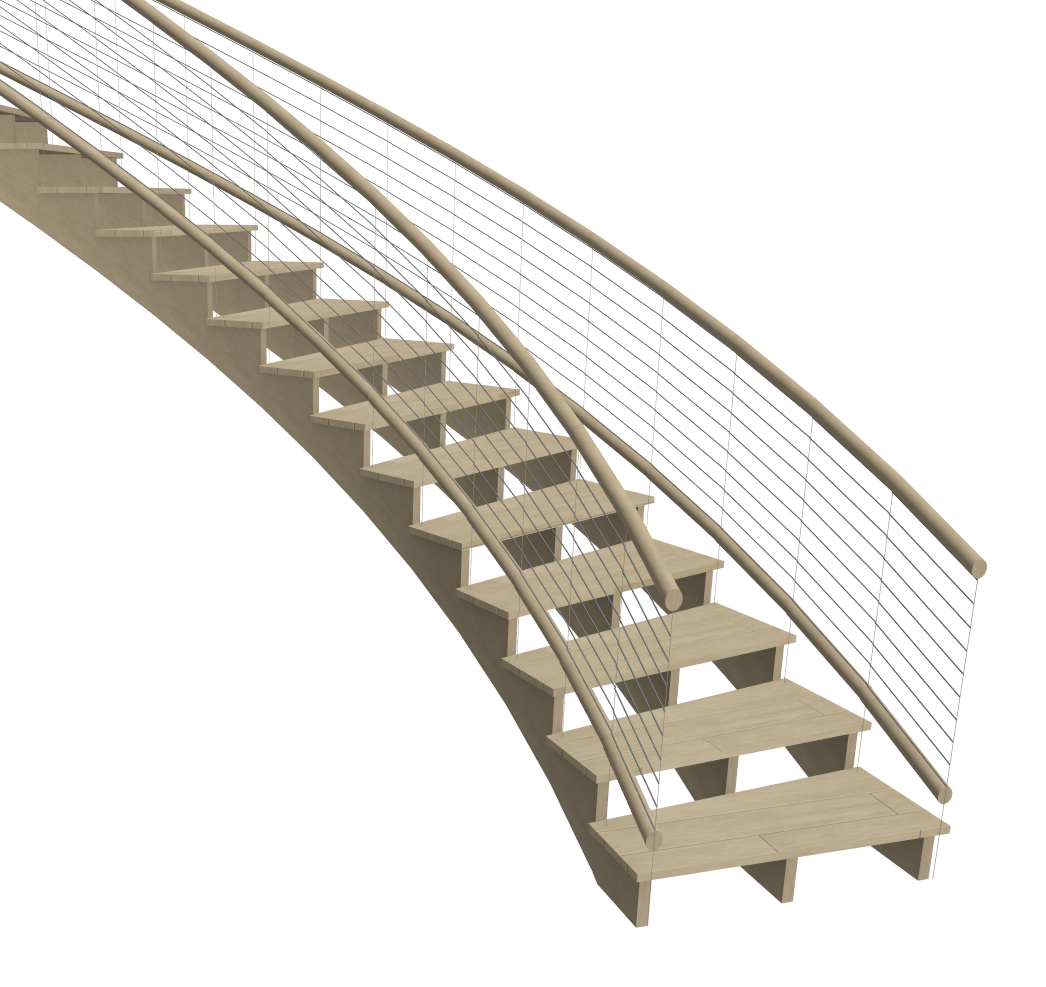

JKEdmo Posted October 7, 2025 Share Posted October 7, 2025 30 minutes ago, Michael_Gia said: Panels of any sort don't curve unfortunately, which is what DBCooper predicted. Was able to approximate the look of curved panel infill by setting newel spacing to 12" o.c. and then setting the newel thickness to 1/16" so that they disappear (material can be set to "air"). Not sure about actual guard post placement. Maybe manually? Anyways, maybe you can finesse to make work... Link to comment Share on other sites More sharing options...

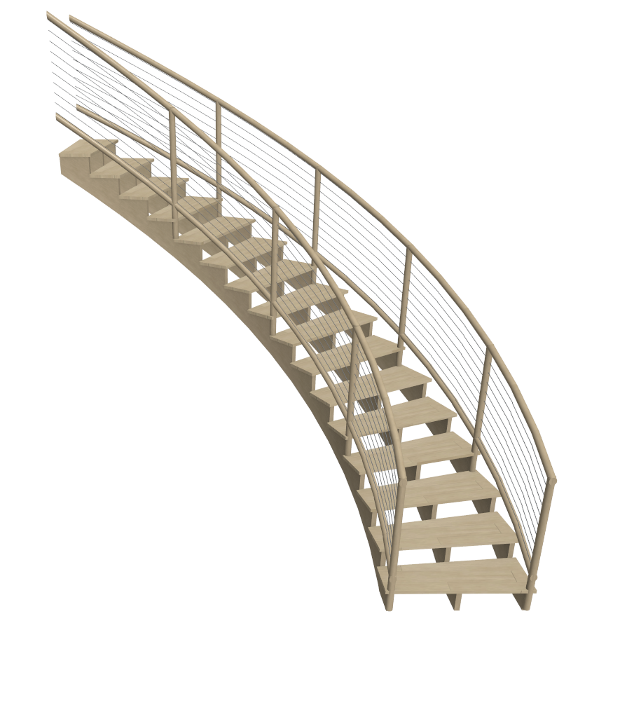

JKEdmo Posted October 7, 2025 Share Posted October 7, 2025 Ok, here's some more: I made a duplicate of the stair and then tweaked it to show posts only. In other words, two stairs on top of each other with different settings to achieve the desired look. Not sure if this is Chief "pure", but my best attempt. 1 Link to comment Share on other sites More sharing options...
robdyck Posted October 7, 2025 Share Posted October 7, 2025 uncheck auto height. Adjust middle rail down. copy the stair and paste-in-place. adjust middle rail up. Link to comment Share on other sites More sharing options...
