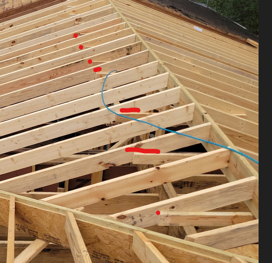

mtldesigns Posted September 6, 2025 Share Posted September 6, 2025 We have builder (from not in our area) decide to do an addition to a 50+ yr old home here wo a permit. He got busted and now is in a hurry for a drawing set to get made and engineers review and stamp, I am trying to match his build as close as possible for an engineers to use. One of the things he has done is a rafter roof package. I want to show the Rafter Collar Ties that he has built.. however I am not seeing this option. Am I missing it, or so I need to manually model them and copy paste? Link to comment Share on other sites More sharing options...

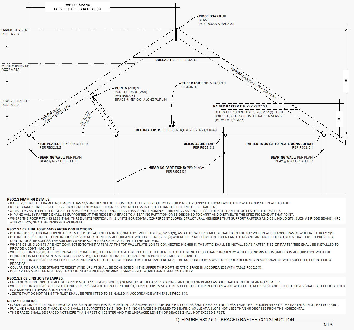

para-CAD Posted September 8, 2025 Share Posted September 8, 2025 Link to comment Share on other sites More sharing options...

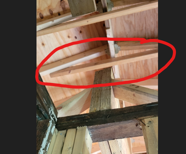

Kbird1 Posted September 11, 2025 Share Posted September 11, 2025 On 9/8/2025 at 2:22 AM, Gawdzira said: I believe the engineer will correct the term "collar tie" in this case to "firewood". I was thinking the same I think it is just a 4' wide flat ceiling area to install lighting, smoke alarms air-con etc into perhaps, they are too high to be ties as seen in Para-CAD's pic. M. Link to comment Share on other sites More sharing options...
mthd97 Posted September 11, 2025 Share Posted September 11, 2025 Not tornado proof BTW . Structural connection details are not shown here for the wind speed category either ??? I don’t know what USA timber framing requirements are for this region but you would think that you would need more than just nails for the uplift force ??? Link to comment Share on other sites More sharing options...
