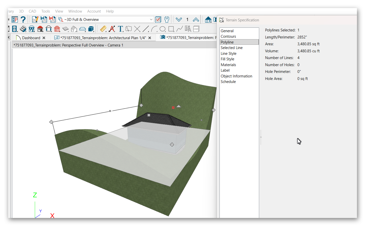

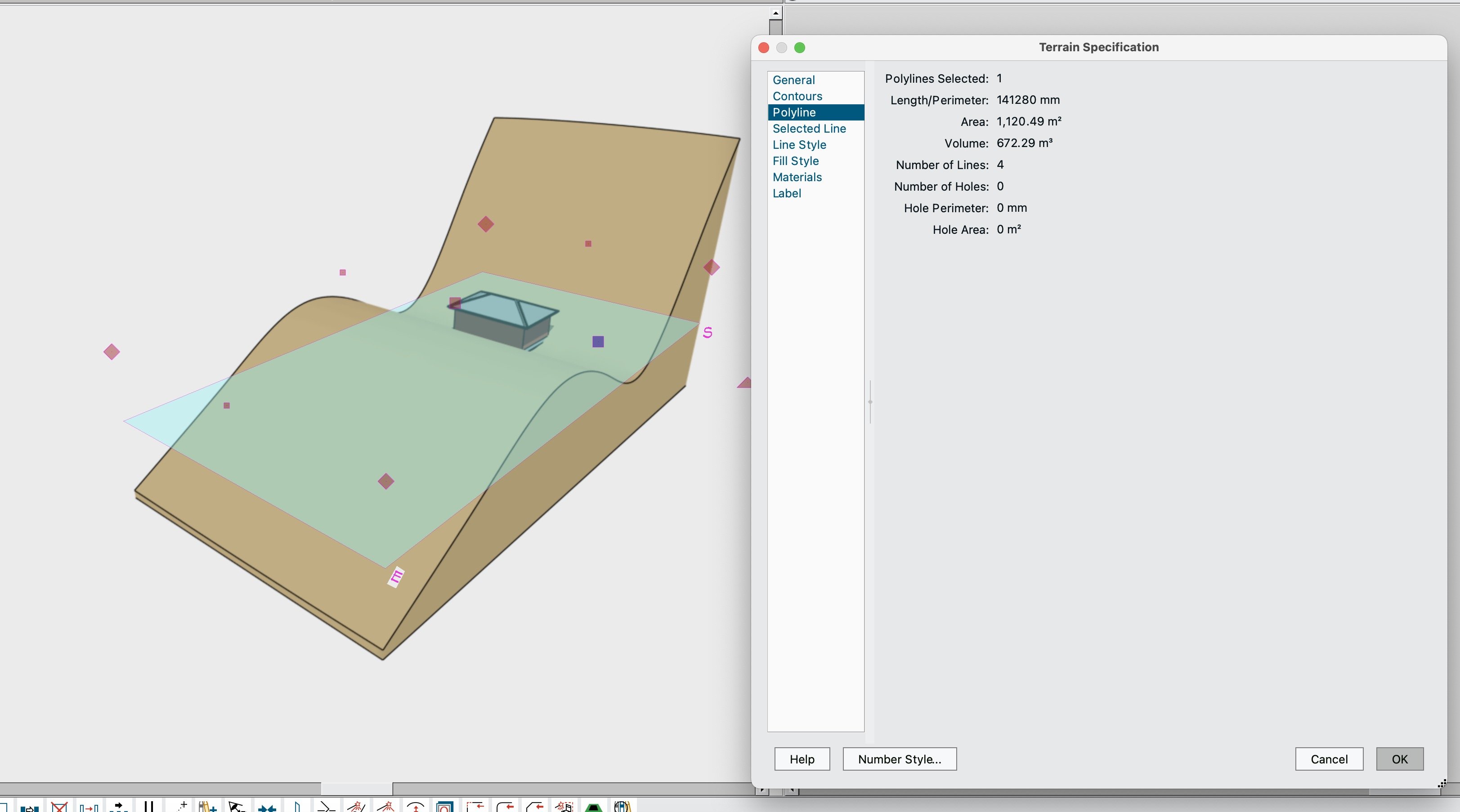

LevisL Posted June 9, 2014 Author Share Posted June 9, 2014 Why does the terrain dbx have a volume that shows 0 cu.ft no matter what thickness you make it?! Just having that number would make it easy to calculate what I want. Link to comment Share on other sites More sharing options...
Nicinus Posted June 9, 2014 Share Posted June 9, 2014 I'm kind of a beginner but I would guess that dbx regards the polyline and not the actual solid? Have you tried clicking Next? Link to comment Share on other sites More sharing options...
