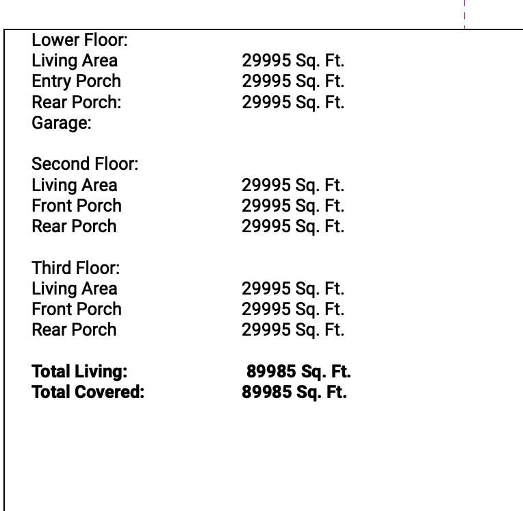

Ringos Posted September 17, 2025 Share Posted September 17, 2025 I have a box in my plans that I would like to populate with square footage for the different areas listed. It would seem that this is common and there would be a tool that made this effortless. Yet, I think I need to figure out custom Macros? If anyone has a great way of doing this with easy automation I would enjoy learning it. I will even pay someone to jump online and help me get this working. Link to comment Share on other sites More sharing options...

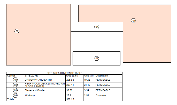

DBCooper Posted September 18, 2025 Share Posted September 18, 2025 If all you need is a very basic one, all you need to do is create some polylines and mark them as include in schedule. Then create a custom schedule that includes polylines and has the area column and the totals row. You could create two of them, one to show living areas and the other to show the non-living areas. Link to comment Share on other sites More sharing options...

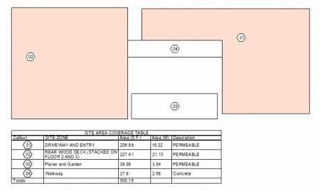

Gawdzira Posted September 18, 2025 Share Posted September 18, 2025 Here is an example area schedule table example.plan Link to comment Share on other sites More sharing options...
Doug_N Posted September 18, 2025 Share Posted September 18, 2025 4 hours ago, Gawdzira said: Here is an example area schedule table example.plan 4.99 MB · 3 downloads Hi Alan, Thought I would take a stab at extending the schedule a bit, but the metric area column is not totaling. Any thoughts? dn-areascheduletableexample.plan Link to comment Share on other sites More sharing options...
QualicoreHomes Posted September 18, 2025 Share Posted September 18, 2025 If you select the "calculate total" for Area (M) then it does. Link to comment Share on other sites More sharing options...
Ringos Posted September 18, 2025 Author Share Posted September 18, 2025 Thanks. Helpful. I am guessing one would draw the polyline around the area they want or "make room polyline" Drag that off to the side of the drawing, or on a separate layer. Include in schedule, and do that for each area they want included. At the end a person would have a bunch of polyline shapes like you have each drawn from the plan and dragged off to the side or on a separate layer that can be turned on and off? Should I have that formula %area.to_sq_m.round(2)% in macros someplace or is that information known? Link to comment Share on other sites More sharing options...
Ringos Posted September 18, 2025 Author Share Posted September 18, 2025 I saw in one example the %area.to_sq_m.round(2)% formula was in the polyline custom object fields. In the other one I did not see a physical formula anywhere. Link to comment Share on other sites More sharing options...
GeneDavis Posted September 18, 2025 Share Posted September 18, 2025 What would be the method used when a combined area is the way one would want the area reported in a schedule? Example would be front porch at 100 s.f. and rear porch at 400 s.f., with schedule reporting "porches" at 500 s.f. One big beautiful macro? Help out a guy who is macro illiterate. Link to comment Share on other sites More sharing options...
SHCanada2 Posted September 18, 2025 Share Posted September 18, 2025 if you were permitted to display only living area, porches and garage, it would be simpler than delineating every single porch Link to comment Share on other sites More sharing options...
Ringos Posted September 18, 2025 Author Share Posted September 18, 2025 I am able to display only living area, porches and garage. Just trying to figure out what I should provide at a minimum. Link to comment Share on other sites More sharing options...
SHCanada2 Posted September 18, 2025 Share Posted September 18, 2025 19 minutes ago, Ringos said: Just trying to figure out what I should provide at a minimum. Wouldn't this be determined by your jurisdiction? I do not have to delineate porches and garages here. As such I only have 1st floor, 2nd floor, basement living area, and sometimes parcel coverage on my plans Link to comment Share on other sites More sharing options...
Doug_N Posted September 20, 2025 Share Posted September 20, 2025 On 9/18/2025 at 8:07 AM, QualicoreHomes said: If you select the "calculate total" for Area (M) then it does. I can't tell you how long I looked at that DBX when working on this but it was greyed out. Of course it was, I had to highlight the macro to enable it! (smacks forehead) Thanks Gerard!! Link to comment Share on other sites More sharing options...
