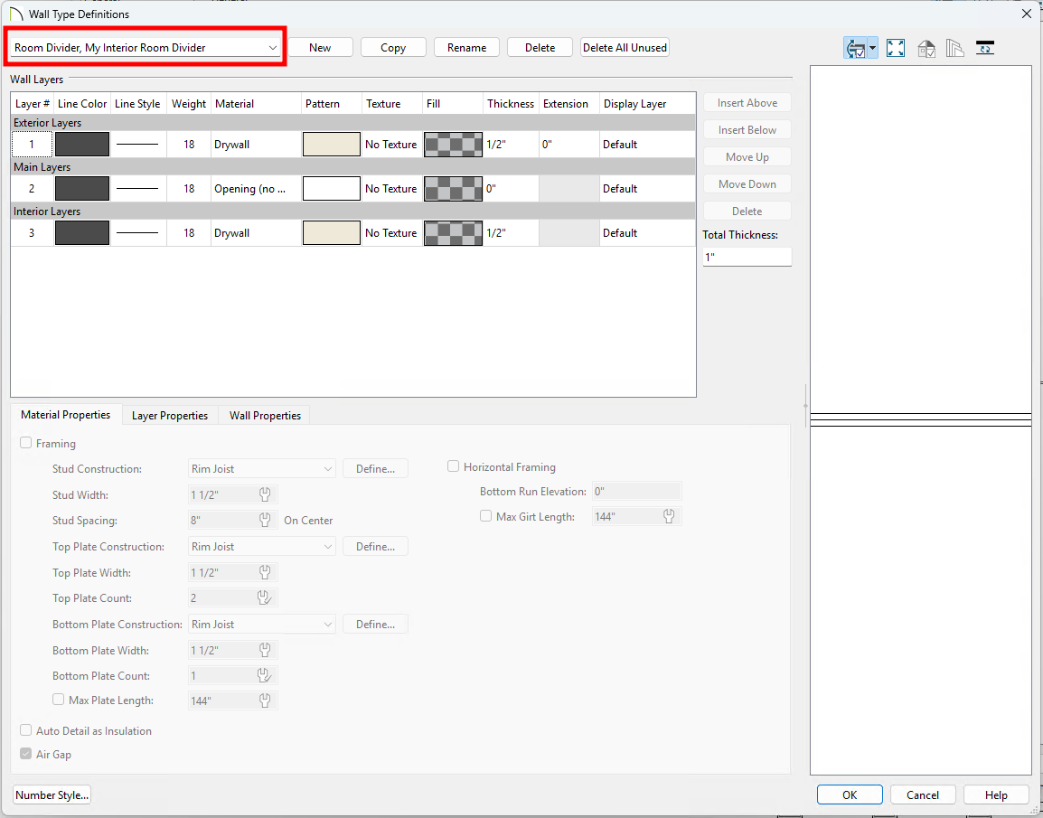

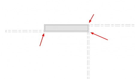

JLU_Design Posted December 23, 2025 Share Posted December 23, 2025 This is finally what I've come up with: The reason for the drywall layers is to make wall ends generate correctly on interior walls. Link to comment Share on other sites More sharing options...
Adam_Gibson Posted December 23, 2025 Share Posted December 23, 2025 It starts with a single line and seems to always revert to the thickness of whatever wall type you used. JLU_Design's method works fine. If you don't need drywall, just use a thin main layer. Link to comment Share on other sites More sharing options...

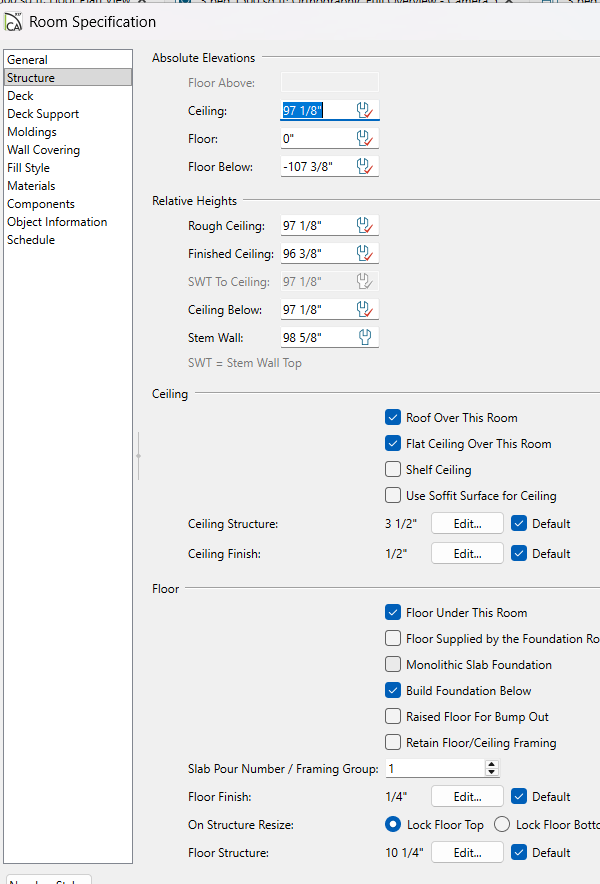

Renerabbitt Posted December 23, 2025 Share Posted December 23, 2025 For those that are curious, it changes to a double line when you have a difference in setting from the rooms on either side of the wall Link to comment Share on other sites More sharing options...
