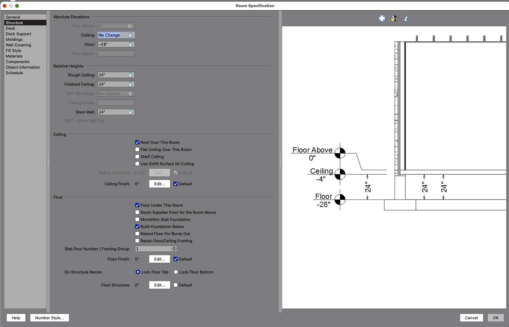

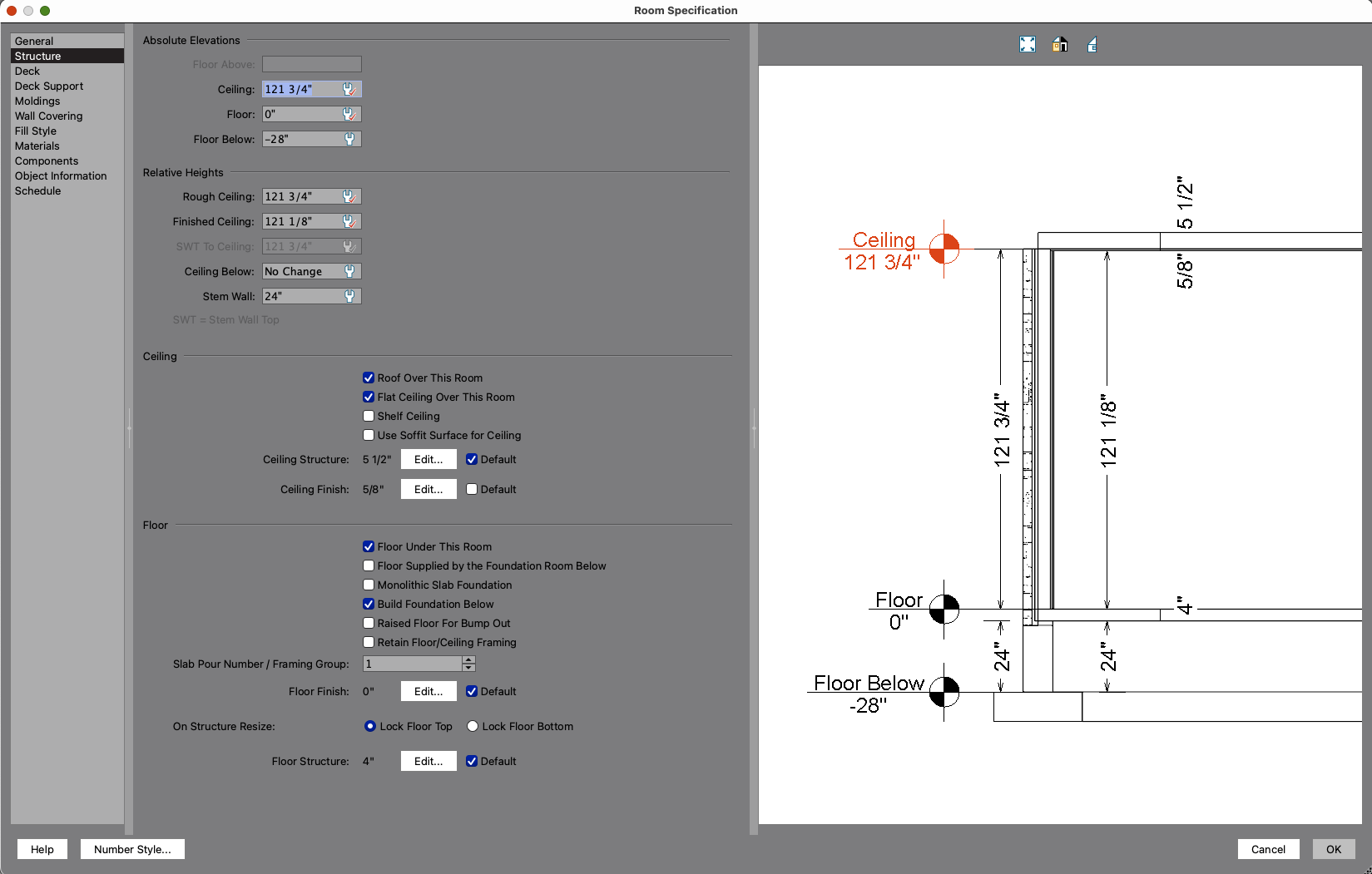

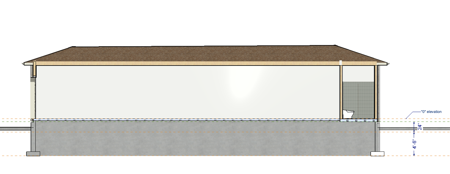

Michael_Gia Posted July 19, 2025 Share Posted July 19, 2025 Hey, no matter what I set my basement ceiling height or floor level or stemwall height, my stemwall won't budge? Are we not able to affect floor 0 anymore? What am I missing? Cross section: I was hoping the 4'-6" would change to 24" or something close to that? Stemwall doesn't budge in the cross section view no matter how I change ceiling heights, of stemwall height in either floor 1 or 0. Am I missing something obvious, like a check box or do I need to cast a spell and tap my heels 3 times? Either a bug or I suddenly forgot how to change stemwall heights? Floor 1 room dialogue box: Floor 0 room dialogue box: Link to comment Share on other sites More sharing options...

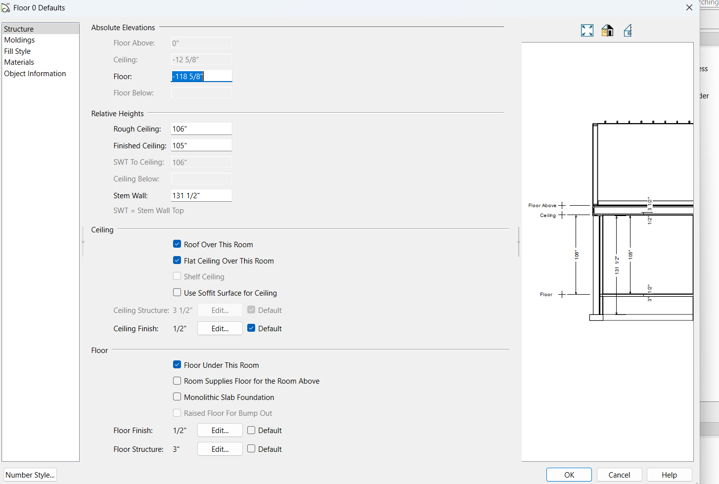

SHCanada2 Posted July 19, 2025 Share Posted July 19, 2025 i dont use auto build foundation as it then deletes everything in the basement, and I adjust stemwalls frequently to match the basement foundation height Adding +24 to stemwall in floor 0 defaults works on my template plan(which has a basement):. so not sure what the issue is, unfortunately, maybe post the plan. My guess it has something to do with the "no change" that shows for the ceiling (multiple rooms with different heights as John indicated) 1 Link to comment Share on other sites More sharing options...
Michael_Gia Posted July 19, 2025 Author Share Posted July 19, 2025 12 minutes ago, SHCanada2 said: so not sure what the issue is, You made me go back and check one more thing... I had accidentally checked the box for "Floor supplied by the foundation room below", in my frantic messing around. Open the DBX, close the DBX, open the DBX, close the DBX. Wish we could affect these parameters and see the changes live rather than the idealized representation in the Dialogue box side window. My fault, but Chief has a pretty arcane way of working this stuff out. my apologies. 2 1 Link to comment Share on other sites More sharing options...

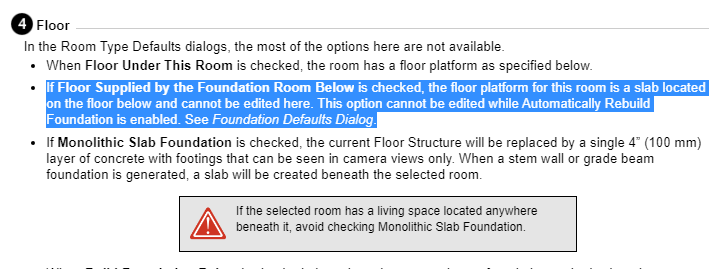

DefinedDesign Posted Monday at 09:36 PM Share Posted Monday at 09:36 PM On 7/19/2025 at 12:47 PM, Michael_Gia said: You made me go back and check one more thing... I had accidentally checked the box for "Floor supplied by the foundation room below", in my frantic messing around. Open the DBX, close the DBX, open the DBX, close the DBX. Wish we could affect these parameters and see the changes live rather than the idealized representation in the Dialogue box side window. My fault, but Chief has a pretty arcane way of working this stuff out. my apologies. I don’t understand why this behavior is not clearly communicated in the X17 Dialog Help. This type of setting fundamentally overrides user control, yet the interface does not make that relationship obvious. As a result, I spend hours troubleshooting what appears to be a malfunction, when in reality the software is behaving as designed. Clearer communication within the dialog or help documentation about when and how control is overridden would significantly reduce confusion and lost time. Link to comment Share on other sites More sharing options...

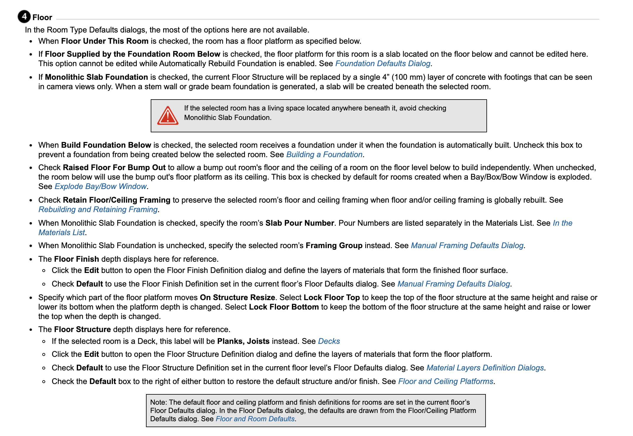

Renerabbitt Posted Monday at 10:16 PM Share Posted Monday at 10:16 PM 39 minutes ago, DefinedDesign said: I don’t understand why this behavior is not clearly communicated in the X17 Dialog Help. I think it is, the help menu is live and this is what it shows in X17: Link to comment Share on other sites More sharing options...

DefinedDesign Posted Tuesday at 02:15 PM Share Posted Tuesday at 02:15 PM 15 hours ago, Renerabbitt said: I think it is, I’ll be honest, I read that Help text several times and it just didn’t click for me. In my head I was trying to fix wall behavior in the Room dialog, so I wasn’t connecting that setting to what I was seeing. Since the description focuses on the floor platform, it didn’t lead me to think it would affect the walls or that unchecking it would fix the issue. I didn’t realize that with that option checked, the floor and related foundation pieces are being taken from the room below, so changes I was making in this room weren’t having any effect. That’s where I got tripped up. Thanks for pointing this out, now if I can remember it going forward Link to comment Share on other sites More sharing options...
