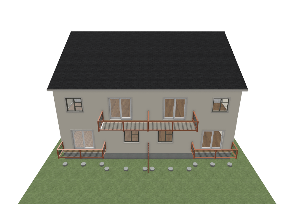

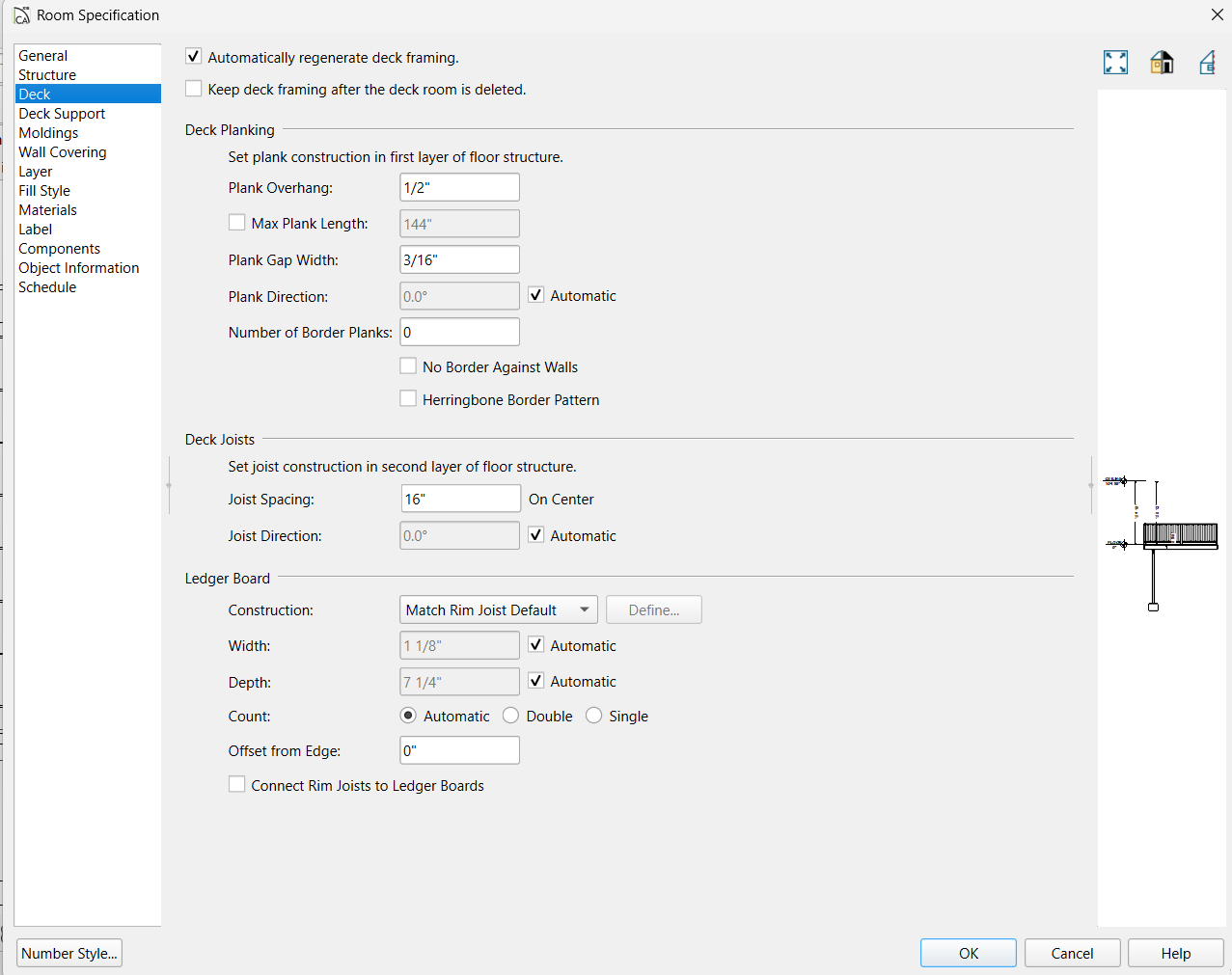

decorators3 Posted 13 hours ago Share Posted 13 hours ago I've attached the Room Specification and Perspective View. However, the deck area isn't generating in the perspective view. Any suggestions on what might be causing this or how to correct it? Cheers Levina Link to comment Share on other sites More sharing options...
joey_martin Posted 12 hours ago Share Posted 12 hours ago Are the proper layers turned on for that camera view? 1 Link to comment Share on other sites More sharing options...
Rpadge Posted 12 hours ago Share Posted 12 hours ago Try manually rebuilding the framing. Link to comment Share on other sites More sharing options...
joshuanyambisa Posted 11 hours ago Share Posted 11 hours ago Check the deck’s room definition, floor height, and layer visibility. These may be preventing it from appearing in the perspective view. Regards 1 1 Link to comment Share on other sites More sharing options...
GaryOhmer Posted 10 hours ago Share Posted 10 hours ago rebuild deck Link to comment Share on other sites More sharing options...
DBCooper Posted 9 hours ago Share Posted 9 hours ago It's either a layer problem (deck support is there but not displaying), a problem with the deck room structure (not setup properly to build the planks and joists), a bug in the program (maybe related to decks on different floors overlapping?), or something else. If you want better guesses, then you should post the plan. 1 Link to comment Share on other sites More sharing options...
robdyck Posted 9 hours ago Share Posted 9 hours ago 18 minutes ago, DBCooper said: a bug in the program There may be a bug relating to some types of decks. I encountered something similar this weekend on a project that hasn't had that problem before. 2 decks, one on the front, one in the back. Auto-building only worked on one of them after this most recent update. Exact same room definitions. I haven't reported it and I could be wrong about the cause. Link to comment Share on other sites More sharing options...
