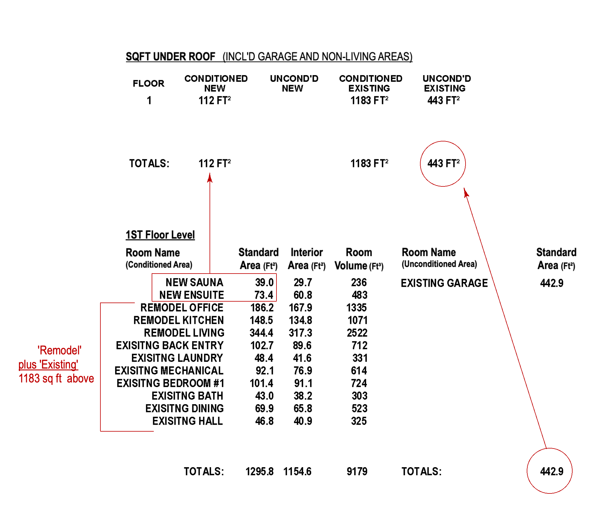

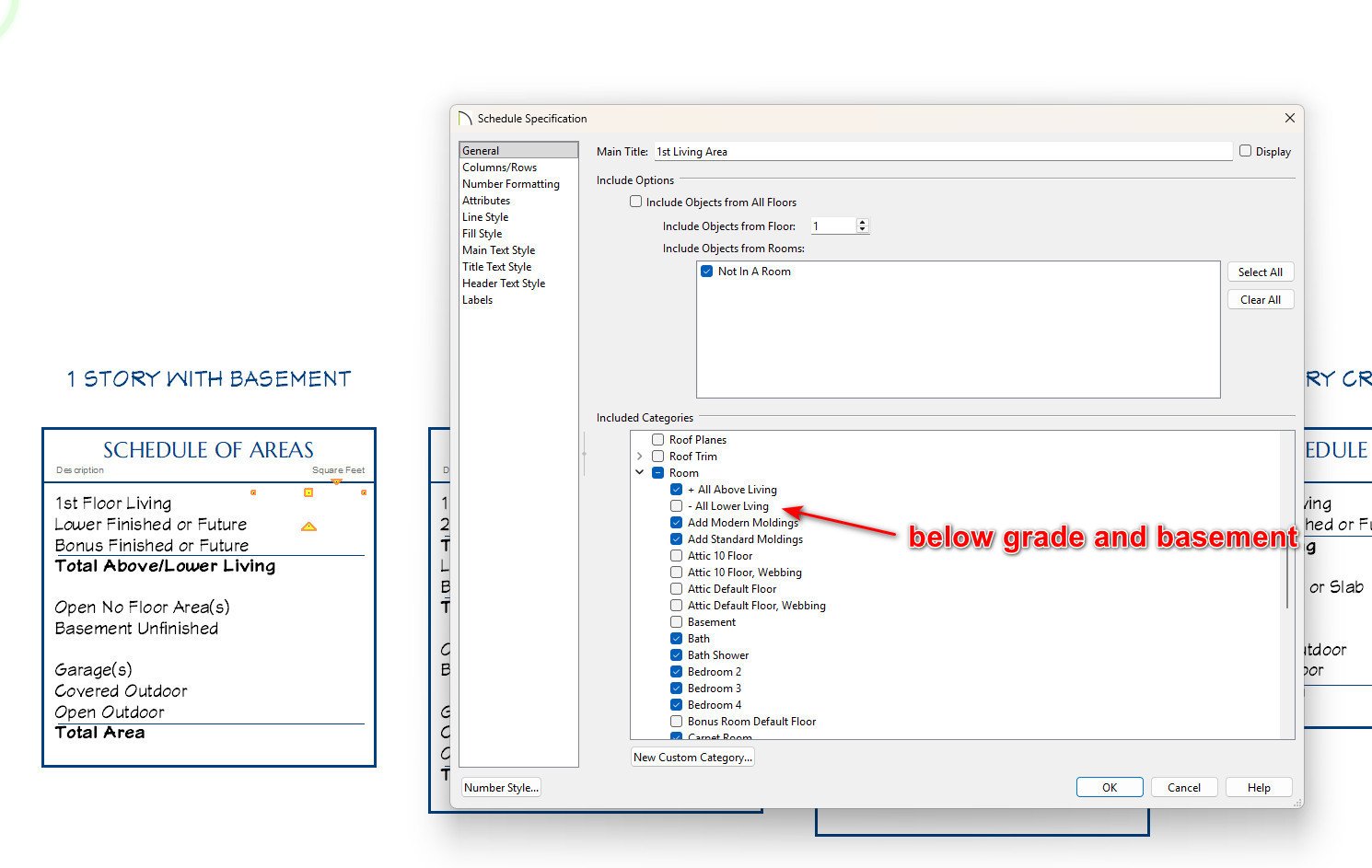

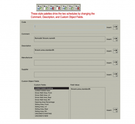

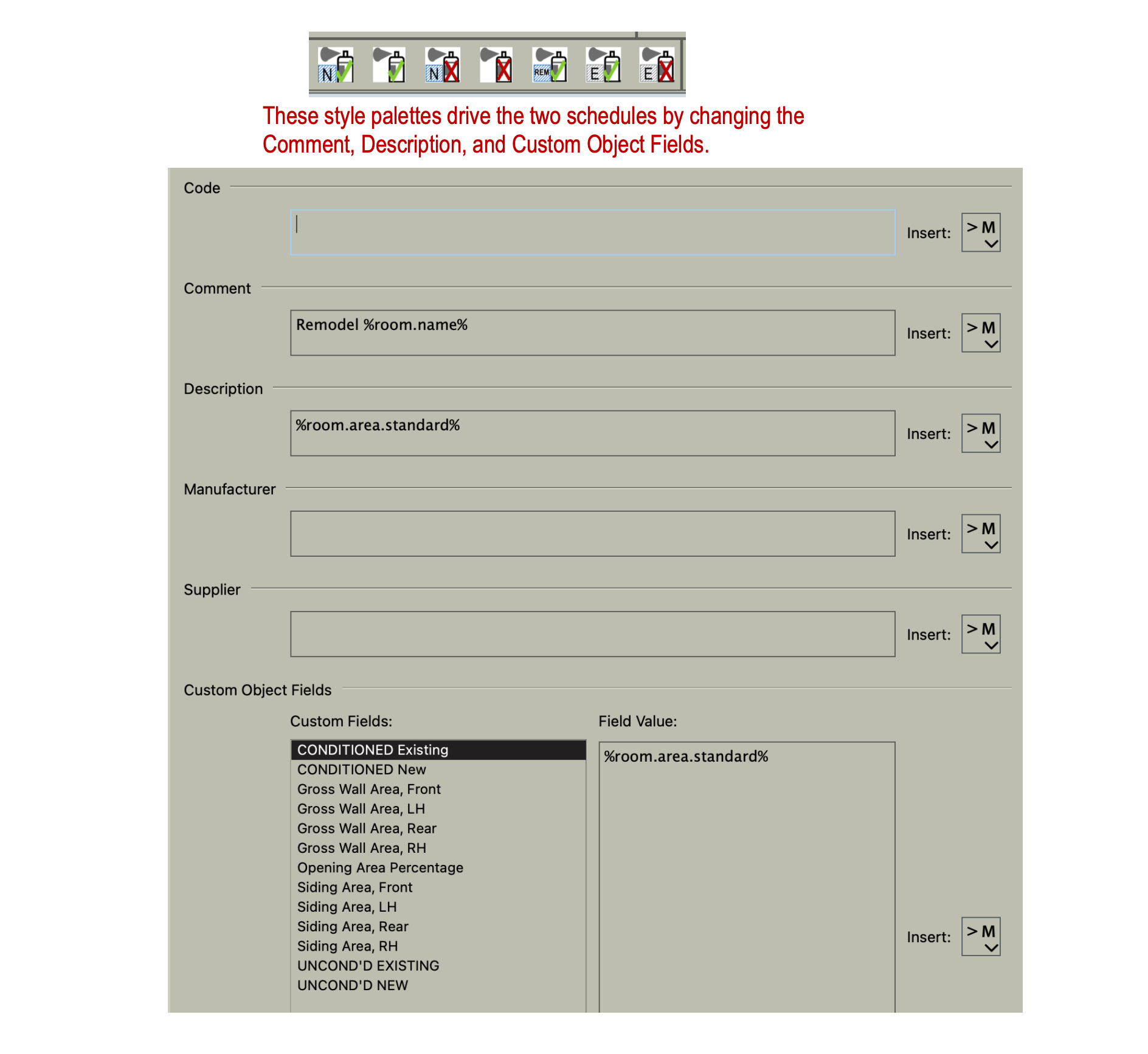

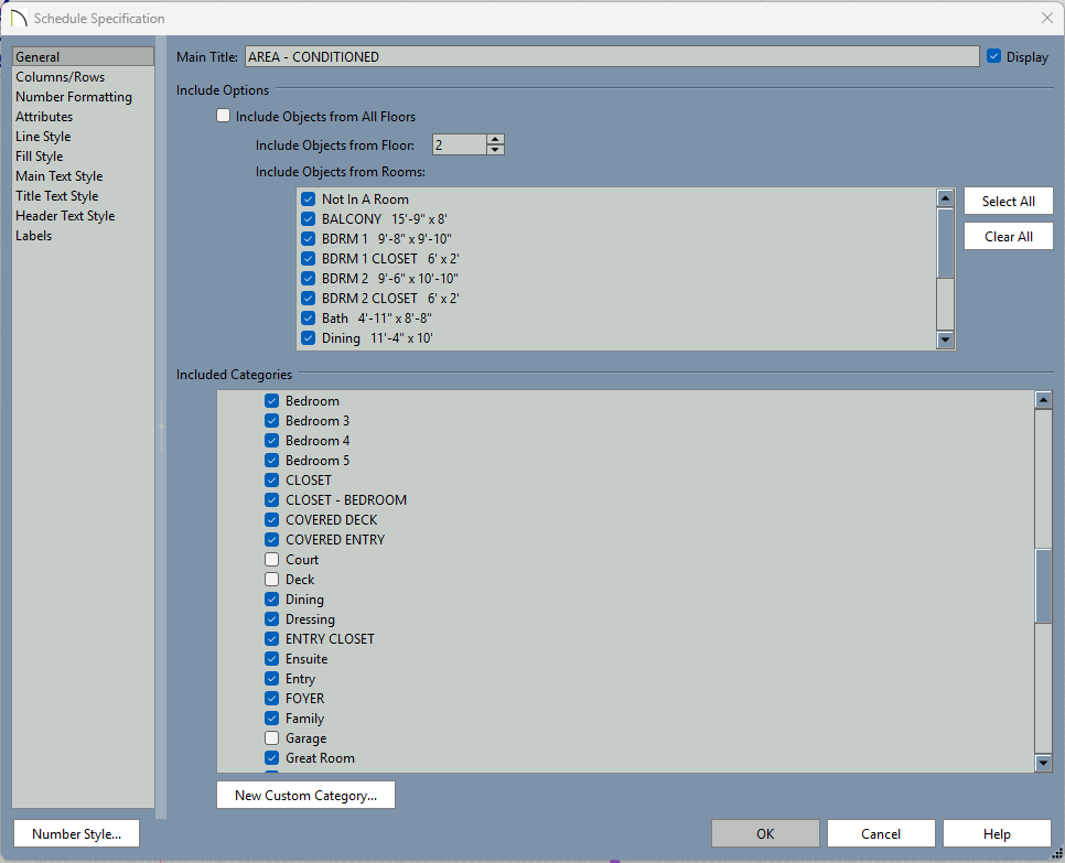

ValleyGuy Posted 10 hours ago Share Posted 10 hours ago 7 hours ago, ChiefUserKatie said: I'm trying to display remodel square footage broken into three categories on our layout sheets: Total Heated Remodeled SQFT, Total Unheated Remodeled SQFT, and Total Addition SQFT. Ideally I would love this to be an automatic thing on our layout file that is calculated without any manual input. The %living_area% macro pulls the whole floor — I can't find a way to filter it to specific rooms. Best method I'm finding is a custom room schedule that I manually tell it what rooms to include. I'll go in and uncheck the heated areas, get the total, then go back and do it for the heated / addition calculation. Does anyone have a better method on this? Thank you! I use style palettes to install the info I want into the room (conditioned vs non-conditioned, remodel vs new vs existing, etc) as well as the appropriate custom object field, and other stuff. I made custom icons for my tool bar for each of the style palettes. Set up the schedules to divide out and total up the appropriate data. It's not hands free, but it is way quicker to grab a spray can and click on the room vs the p-line stuff I do elsewhere. The schedules don't have to be nudged to activate like the p-lines do either. A poly line is more accurate if you are splitting hairs between shared walls, as the room splits down the middle of the wall vs the p-line is placed where you want it. It's quick and accurate enough for my needs, only needs updating once at the end, and keeps the information visible continuously. No macros or anything that special. You could probably come up with something that fits your needs. 1 Link to comment Share on other sites More sharing options...

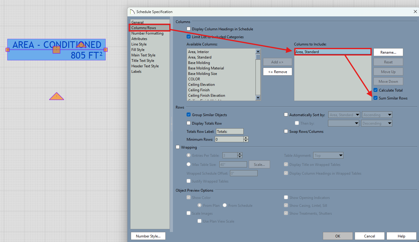

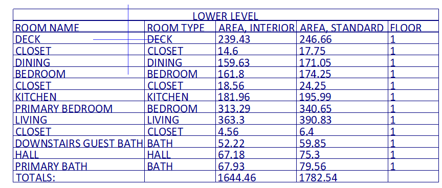

para-CAD Posted 10 hours ago Share Posted 10 hours ago This is a Fantastic Thread. I am a rookie at this, so THANKS to all who are sharing!!!! A man who went by the handle Solver made some great Chief macro youtube videos about 5 years ago. I followed his instructions to make this on my coversheet. It has to be refreshed when you open the file, but works after that. The system that he described uses polylines and once your model is where you want it, you add polylines to the areas that you need to export. it and you can place these on your cover sheet in layout. Let's use Crawlspace for an example.......uh...... I'm creating a video because typing is so far down on my list of skills. It is "processing" to 4K at this time.....give it 10 mins and it should be nice and medium rare. Link to comment Share on other sites More sharing options...

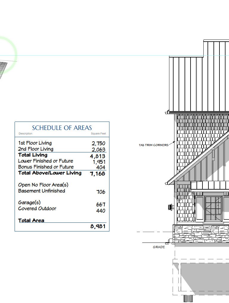

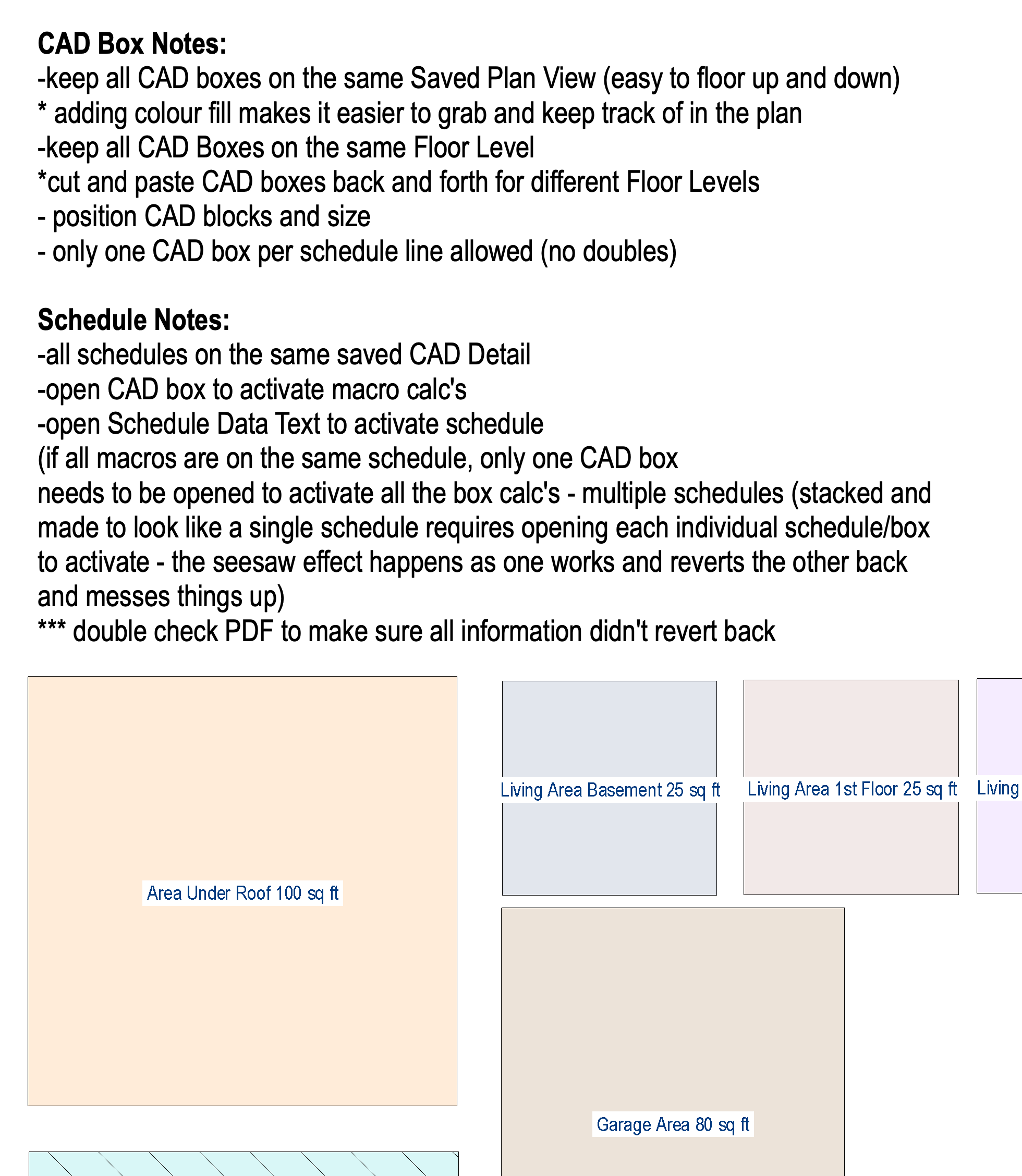

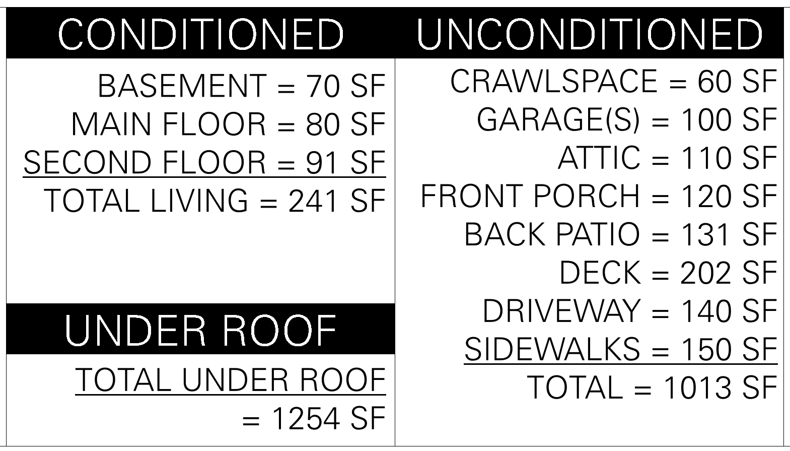

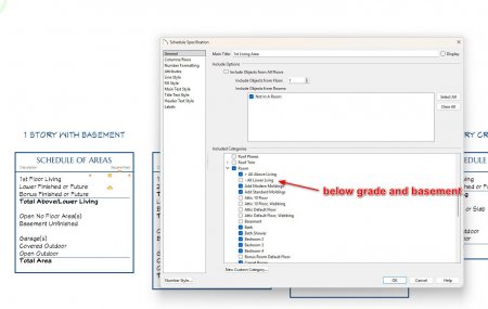

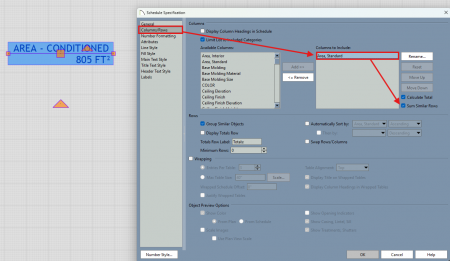

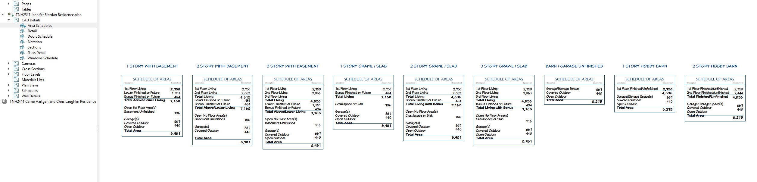

ValleyGuy Posted 3 hours ago Share Posted 3 hours ago 7 hours ago, para-CAD said: This is a Fantastic Thread. I am a rookie at this, so THANKS to all who are sharing!!!! Good video Mike, you are right, Solver made some good videos and I also used his material to solve a lot of issues. I'm not that much farther ahead of you doing this area calc's, but here are my school of trial and error notes that I made when I first started. I'm not sure if they are all correct, and certainly not sure how or why, but these seem to keep me on the right track with my limited knowledge. I'm not sure if they will help, but it may be more added info to work with. 1 Link to comment Share on other sites More sharing options...
