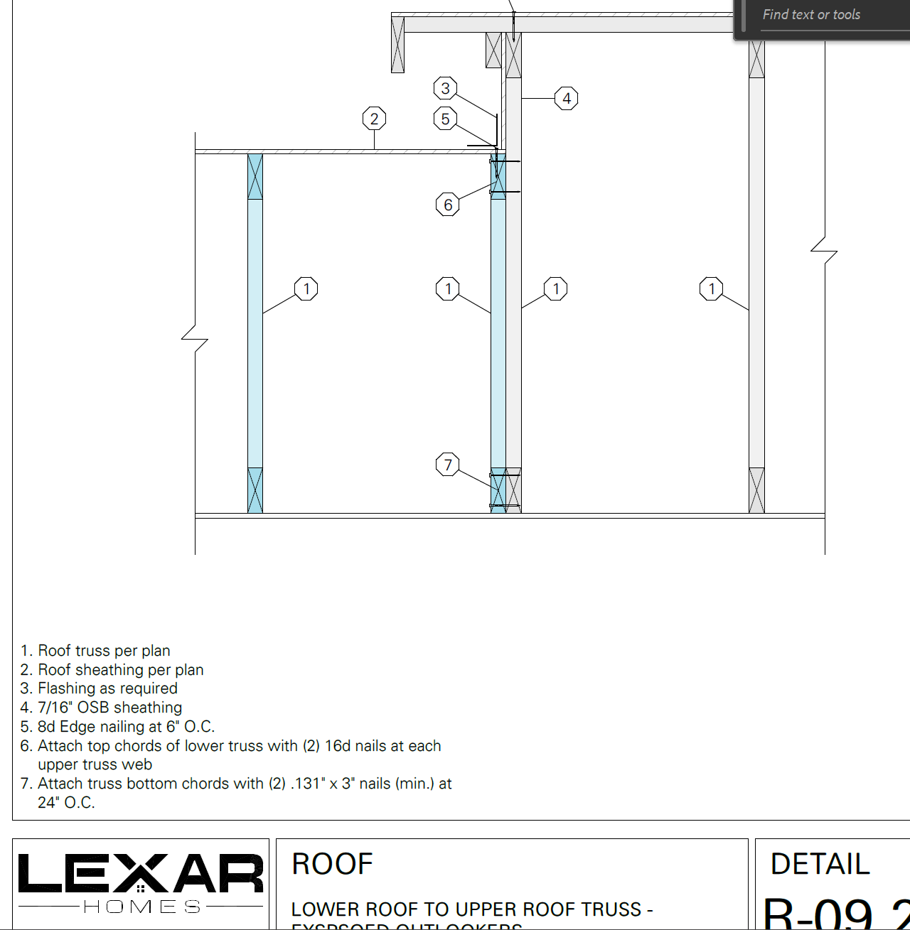

SHCanada2 Posted Sunday at 09:30 PM Share Posted Sunday at 09:30 PM 18 hours ago, johnny said: but just to show you another "format" That is an impressive set. what is 4 for this below? it says sheathing, but I think maybe the line should go across the truss to the vertical cross hatched pline? ..and a little typo "EXSPSOED" ...I do these all the time... only to find them way after I sent them out Link to comment Share on other sites More sharing options...

johnny Posted Sunday at 11:43 PM Share Posted Sunday at 11:43 PM 2 hours ago, SHCanada2 said: That is an impressive set. what is 4 for this below? it says sheathing, but I think maybe the line should go across the truss to the vertical cross hatched pline? ..and a little typo "EXSPSOED" ...I do these all the time... only to find them way after I sent them out Ah, good catch. When I looked into this detail, I noticed that the (4) target line is positioned behind the fill used for the truss. That said, fixing the layering would only address part of the issue. As a general practice, I instruct my drafters to avoid crossing the target line with other elements whenever possible. In this case, the (4) should be placed above the other numbers on the left side. I’ll have them correct it. Link to comment Share on other sites More sharing options...
