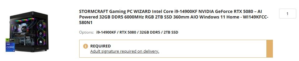

jcldraft Posted July 23, 2025 Author Share Posted July 23, 2025 I'm leaning to the attached now. Any suggestions? Link to comment Share on other sites More sharing options...

HumbleChief Posted July 23, 2025 Share Posted July 23, 2025 5 hours ago, jcldraft said: I'm leaning to the attached now. Any suggestions? Options? Cost? 1 Link to comment Share on other sites More sharing options...
SHCanada2 Posted July 23, 2025 Share Posted July 23, 2025 5 hours ago, jcldraft said: I'm leaning to the attached now. Any suggestions? Looks very nice, if you can get 64GB ram for a couple hundred dollars or less, I'd add that if you use MS edge. I use MS edge and it is a memory hog. I'm with Jonathan on the HD storage, go for speed over quantity. 1 Link to comment Share on other sites More sharing options...
JonathanK Posted July 23, 2025 Share Posted July 23, 2025 8 hours ago, jcldraft said: I'm leaning to the attached now. Any suggestions? One thing to keep in mind is that "less expensive" does not equal better. Especially in the computer world. You have a motherboard or RAM go out and it's a big deal. There's a reason name brand costs what it does. I don't know much about the CyberPower or Stormcraft brands...but I'm guessing if you're buying from Amazon I'd be asking some questions. But they might be sweet...never know. 1 Link to comment Share on other sites More sharing options...
