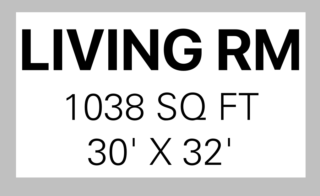

Archnot-Boltz Posted September 19 Share Posted September 19 (edited) What's the deal with making room labels less accessible regarding modification of verbiage, text size etc? Really, with the macro crap?. Common Chief, the only thing that needed improvement was to have the ability to change the Room Name directly when you selected it. Now I can't change the size or anything by directly selecting the room name. This is CAD BS 101!! With every upgrade your developers make the program less intuitive and user friendly. bb Until I can figure out what I'm doing wrong, I'm going to have to roll back to X17 and miss alot of the actual improvements in x18. Edited September 19 by Archnot-Boltz 2 Link to comment Share on other sites More sharing options...

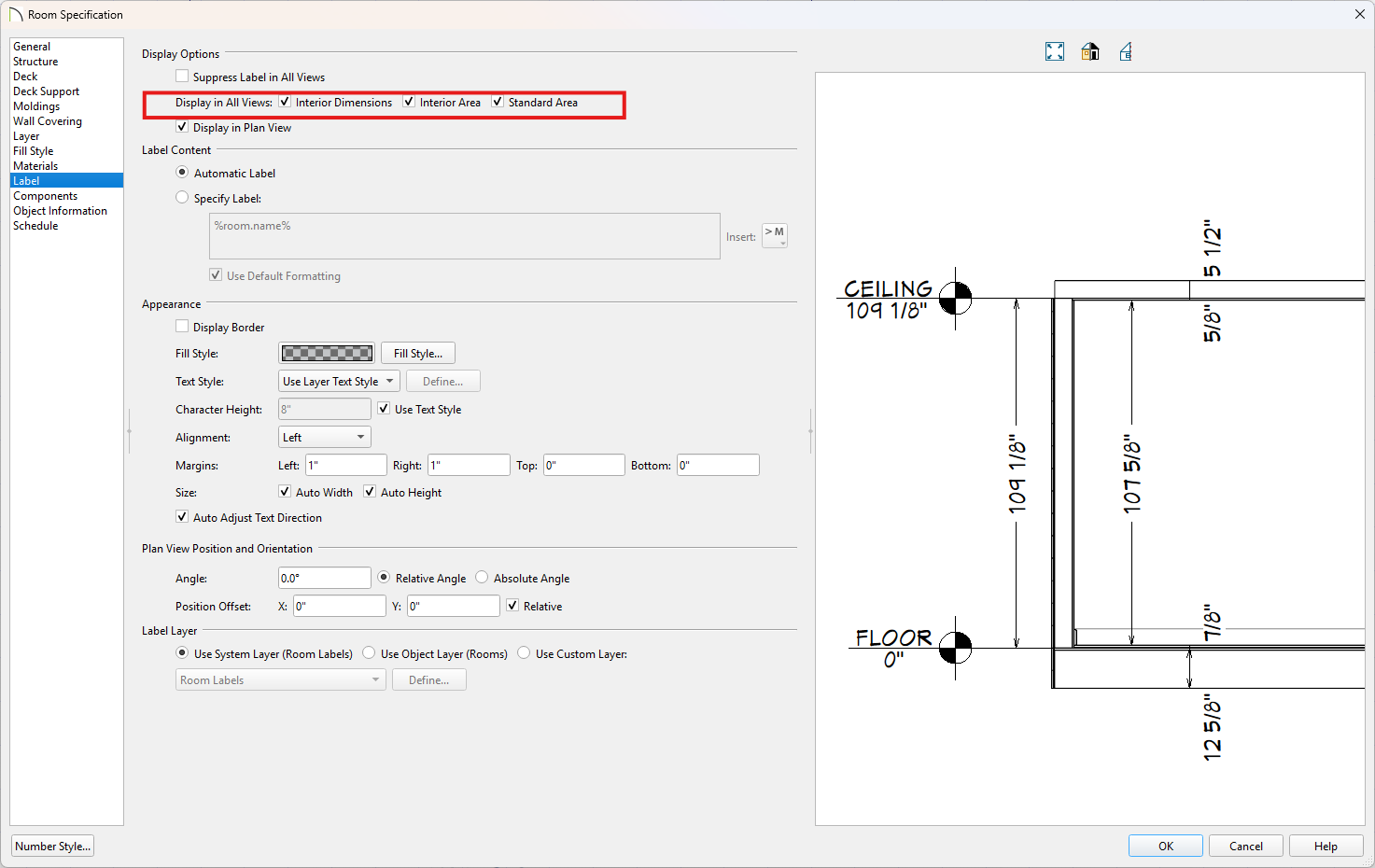

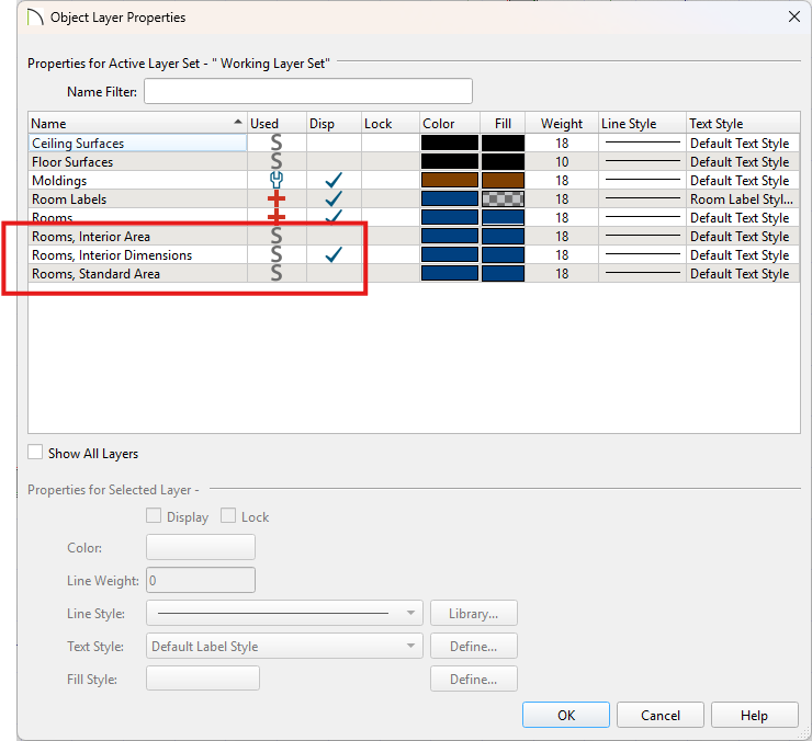

Rashid_Garuba Posted September 29 Share Posted September 29 Is it possible using to NOT display the room size with default room label ..? It is often misleading with odd shaped rooms... Link to comment Share on other sites More sharing options...
DBCooper Posted September 30 Share Posted September 30 Quote Is it possible using to NOT display the room size with default room label ..? It is often misleading with odd shaped rooms... In all versions of Chief that I can remember, you can control this using layers: In X18, you can also turn it off for individual rooms, or for certain room types, in the room dialog on the label panel. 1 Link to comment Share on other sites More sharing options...
