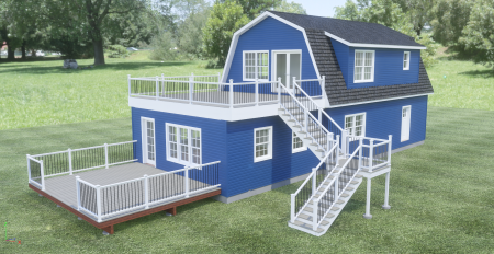

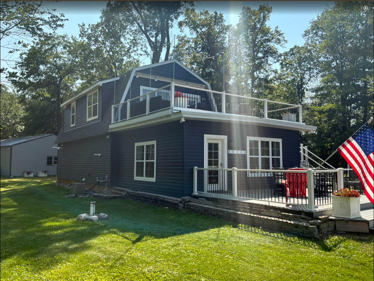

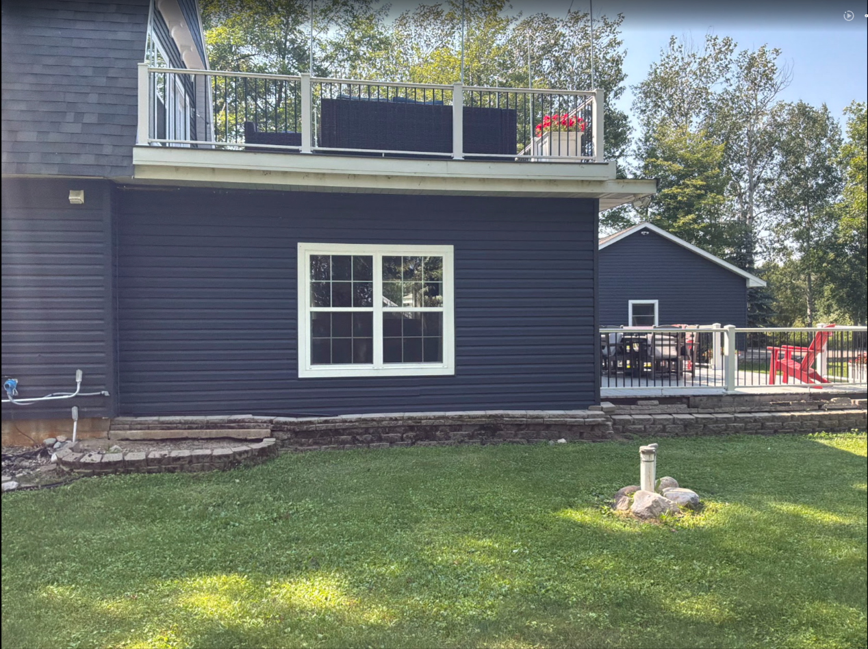

tundra_dweller Posted August 10 Share Posted August 10 I'm working on an as-built for a cabin that has a 22'x24' deck built on a flat roof over a living room. Before I start on the 2nd floor I'm wondering what the best way to model this "room" is. It's been a while since I've done one of these. I'm hoping I can just build the room with railings, set the room type as whatever with no roof over, set my floor framing to the right depth, and change the flooring to decking. If I remember right, setting the room type to deck doesn't work very well in these situations. The addition won't be attached to this deck so I don't care if the roofing is included or the framing spot on, I just want it to look close on elevation views/renderings. I will probably just use a molding to model the soffits/fascia under the deck. Link to comment Share on other sites More sharing options...

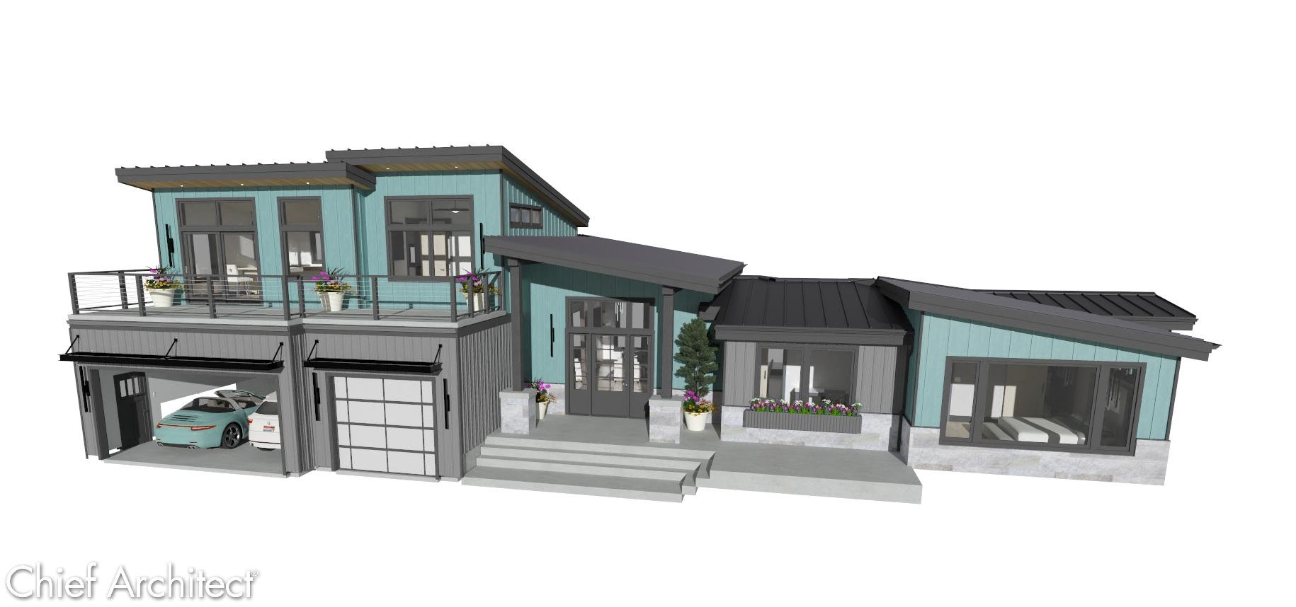

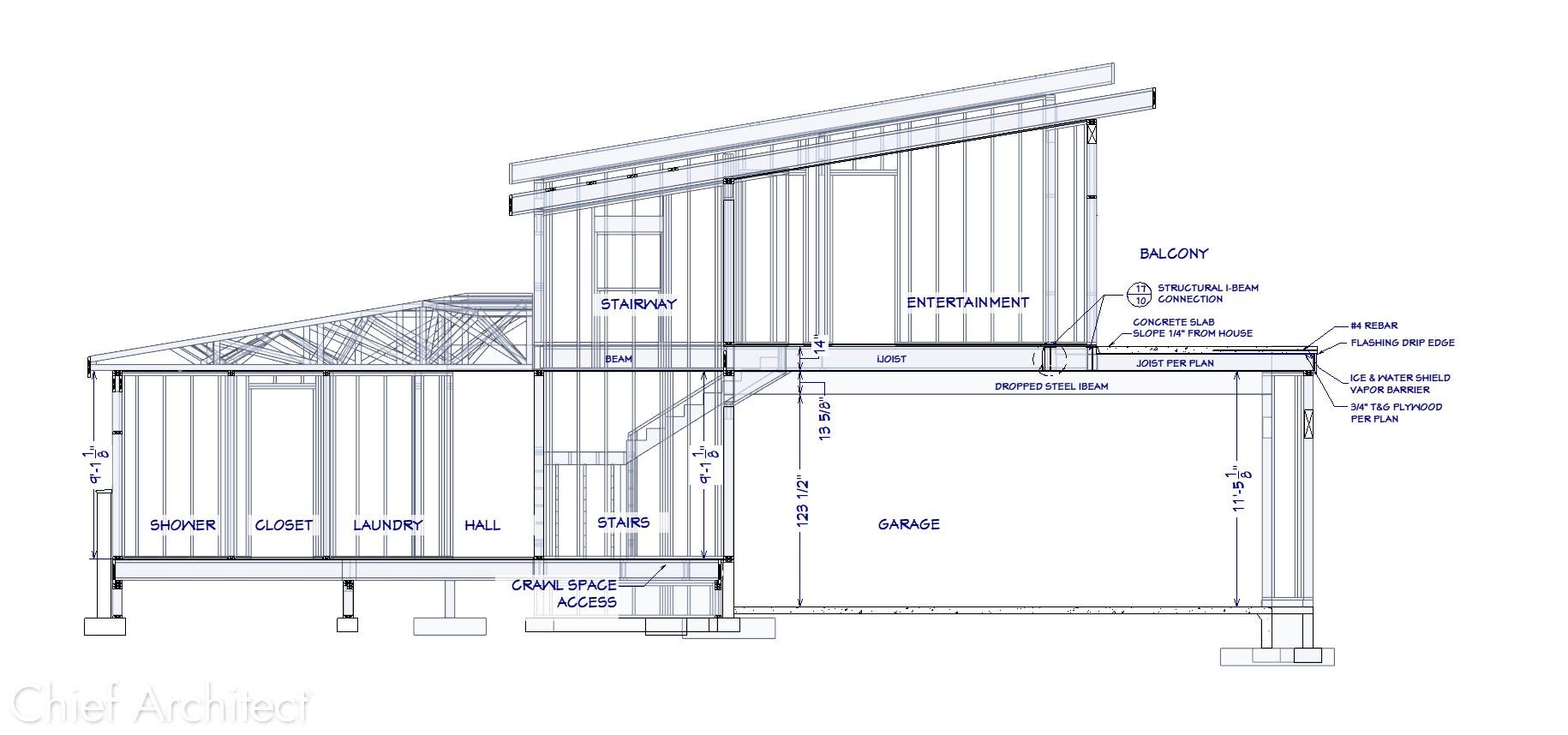

scottharris Posted August 11 Share Posted August 11 There's a sample plan on the website that may help. https://www.chiefarchitect.com/products/samples.html 1 Link to comment Share on other sites More sharing options...

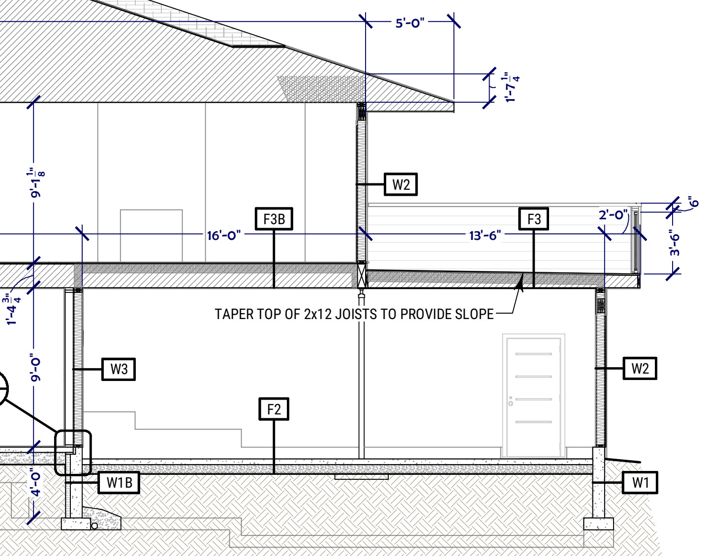

robdyck Posted August 11 Share Posted August 11 (edited) Hey Brett. Balcony is definitely the right room type. Here's a few other tips to consider: For the floor structure, let's assume that the room below will have a flat and level ceiling. So think about how you'd like to frame this floor in advance. Do you want to rip a tapered joist to provide the slope? Maybe you'd prefer to 'sister' a level ceiling joist beside a sloped floor / roof joist. Either way, the Balcony floor structure is often best defined using the lowest TOP point of floor framing for the structure. The Floor structure depth would be this elevation, minus the ceiling elevation below. In some instances you can use a roof plane to model and frame the floor. Experiment with unchecking Floor Under This Room for the balcony. You may not need these extra surfaces although you still want the Balcony room elevations as accurate as possible. The roof plane method can be helpful if you have an overhang and exterior soffits. You may also be able to also use a ramp to help model sloped railing and / or the sloped portion of the floor framing (instead of using a roof plane). You can add the railing to the ramp itself, or use a railing wall set to Follow Stairs. The ramp method and the roof plane method can be combined...it doesn't have to be one or the other. Each method has pros and cons and with a little experimentation you'll find what works best for your scenario. For this project I used a ramp to provide the slope, a custom countertop for the overhanging eaves and fascia (because a countertop can have moldings added) , and a manual molding line to continue the gutter across the front. The side stub walls are level on top and I added the wall cap in the wall dbx and adjusted the top elevation manually. Edited August 11 by robdyck 1 Link to comment Share on other sites More sharing options...

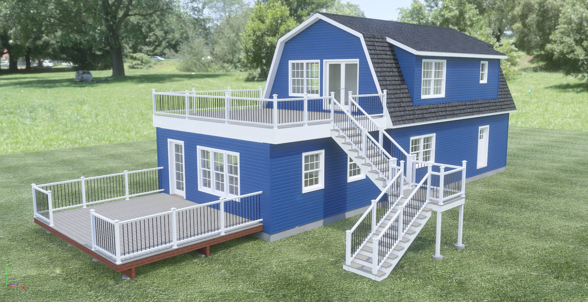

tundra_dweller Posted August 11 Author Share Posted August 11 Thanks all for the assistance, the balcony room worked good! I'm not going to worry about the slope, this is the existing condition and the new addition will be farther back under the shed dormer area. Link to comment Share on other sites More sharing options...
SHCanada2 Posted August 11 Share Posted August 11 that does look good...in under a day Link to comment Share on other sites More sharing options...
tundra_dweller Posted August 11 Author Share Posted August 11 I had the 1st floor done yesterday, and I didn't have to fight the software as much as I figured I would on the 2nd floor with the deck, gambrel roof, and shed dormers. It went surprisingly smooth. 1 Link to comment Share on other sites More sharing options...

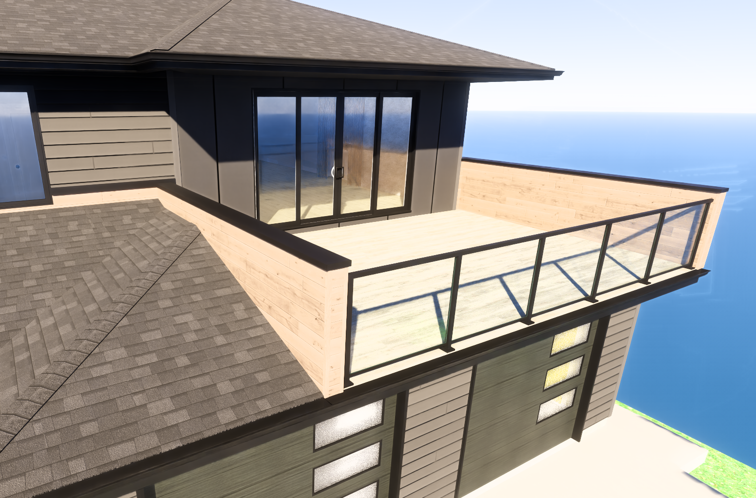

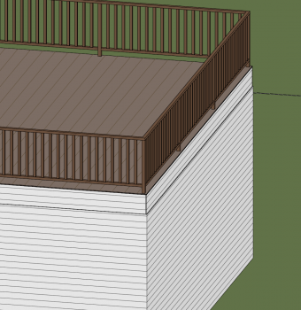

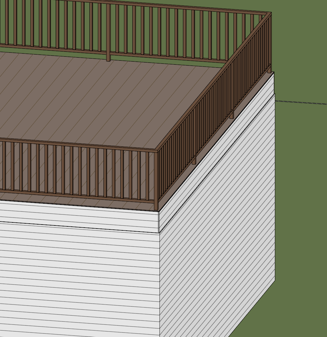

SHCanada2 Posted August 17 Share Posted August 17 what did you use/cover the rim joist. Scott's demo plan uses a molding polyline. But if I just want the wall cladding to extend up over the rim joist, is there an easy way? I painted it, but not the greatest look: Link to comment Share on other sites More sharing options...

tundra_dweller Posted August 17 Author Share Posted August 17 15 hours ago, SHCanada2 said: what did you use/cover the rim joist. Scott's demo plan uses a molding polyline. I used the Materials > Exterior Wall Surface tab of each railing wall dbx to control that exterior finish layer. In my case it was already set to a white trim material. 5 hours ago, ChristianA said: Why is using a deck room type not recommended? The main thing I remember was getting an error message about a deck room over a non-deck room or something like that. That was a few versions ago so that may have changed. In either case you should be able to set up the floor structure however you want it. Link to comment Share on other sites More sharing options...

SHCanada2 Posted August 22 Share Posted August 22 On 8/17/2026 at 2:32 PM, tundra_dweller said: I used the Materials > Exterior Wall Surface tab of each railing wall dbx to control that exterior finish layer. In my case it was already set to a white trim material. hmm that doesn't work, because it is missing the OSB sheathing. any other ideas other than creating a new siding material that is thicker by 3/8? Link to comment Share on other sites More sharing options...

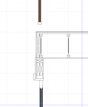

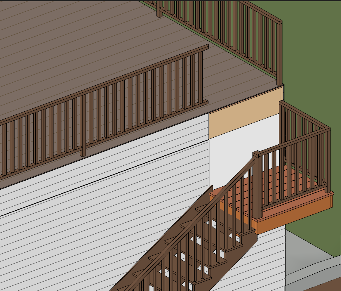

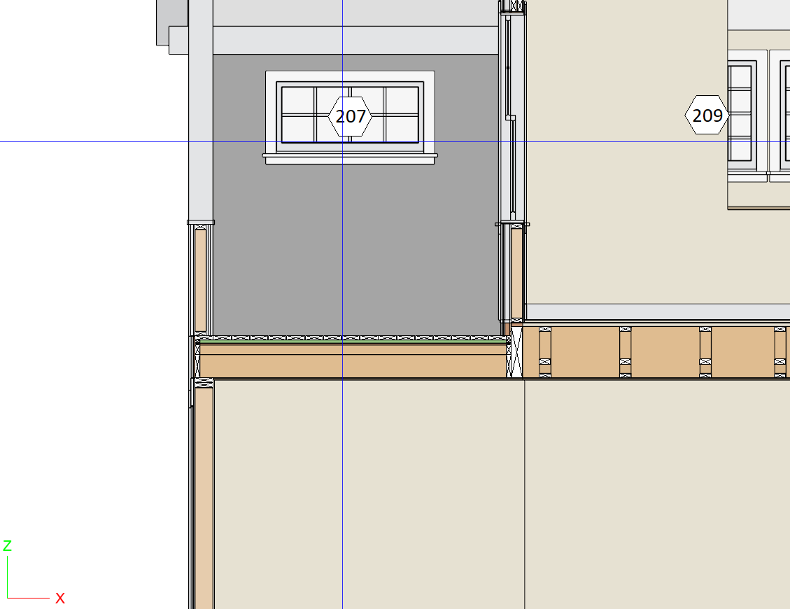

SHCanada2 Posted August 22 Share Posted August 22 this is also interesting: shows the rimboard, and something else below it, even though the room divider has white siding for both sides of the divider. any thoughts on this? Pull the wall up? Link to comment Share on other sites More sharing options...
