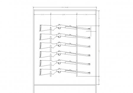

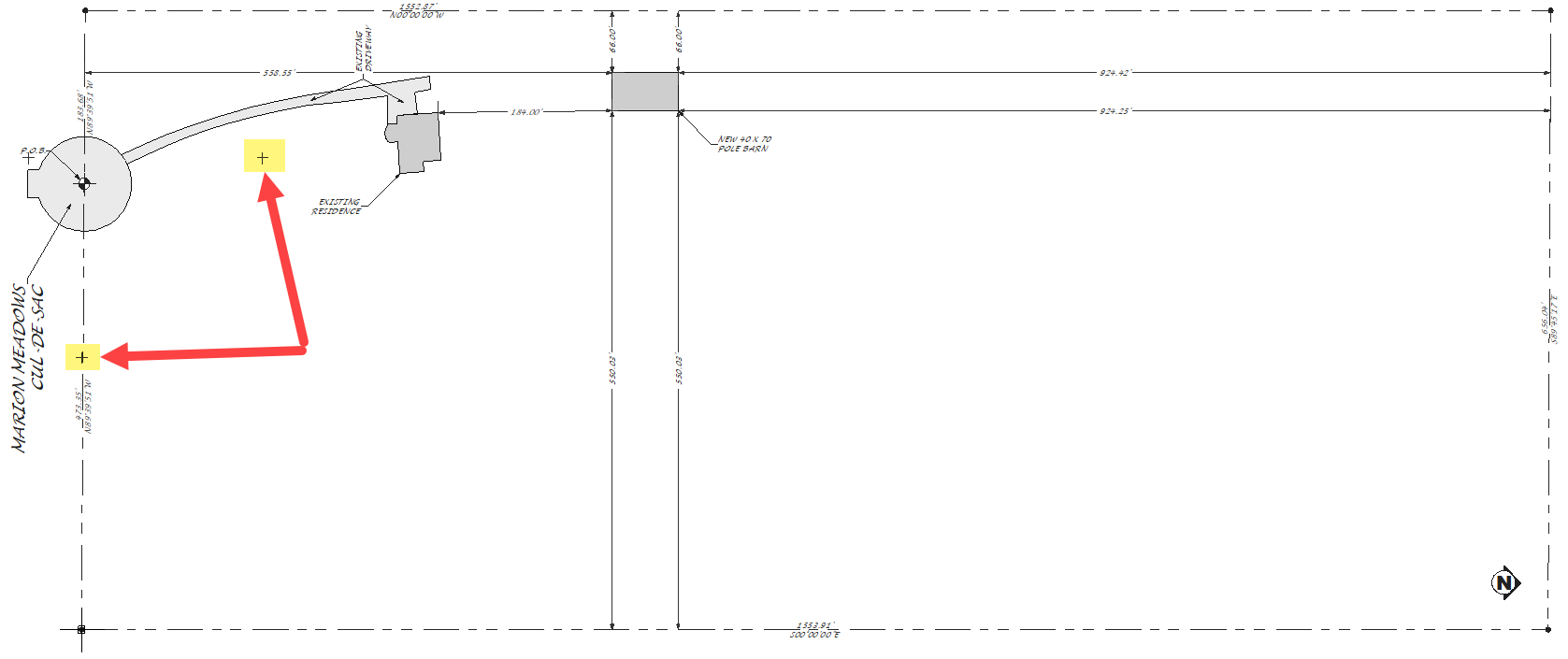

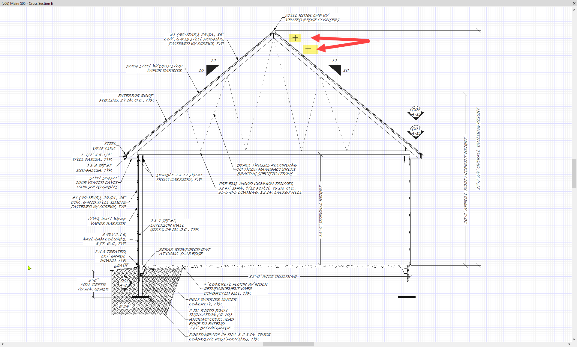

kwhitt Posted March 2 Share Posted March 2 Dimension Markers in CAD Details keep returning even after I delete them multiple times (see attached). Is there a way to delete them permanently? I've only noticed this behavior in X17. It never happened in older versions. Thanks, Kevin Link to comment Share on other sites More sharing options...
JKEdmo Posted March 2 Share Posted March 2 4 hours ago, kwhitt said: Is there a way to delete them permanently? Not entirely sure, but you can modify the size (radius), color or even linetype of each marker to make less conspicuous. 1 Link to comment Share on other sites More sharing options...
Michael_Gia Posted March 3 Share Posted March 3 X17 is the buggiest version in a long while. I really hope they fix all the crap under the hood in the next iteration. 2 1 Link to comment Share on other sites More sharing options...
mtldesigns Posted March 3 Share Posted March 3 9 hours ago, kwhitt said: Dimension Markers I am not a fan of these... no matter the version. I just grab the grip on each one and pull it tight so its not as noticable. 1 Link to comment Share on other sites More sharing options...

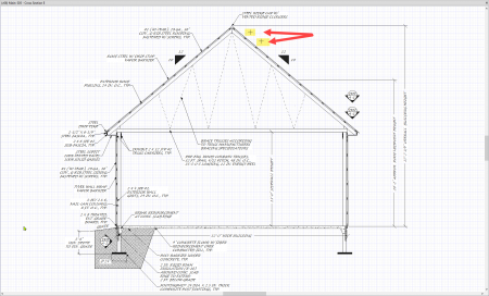

ComputerMaster86 Posted March 3 Share Posted March 3 I might be experiencing this in X17 if it's the same issue. I have cross-shaped (+) marker's that keep reappearing even if I delete them. They appear randomly in random spots in 2D CAD Details. 1 2 Link to comment Share on other sites More sharing options...
kwhitt Posted March 3 Author Share Posted March 3 1 hour ago, ComputerMaster86 said: I might be experiencing this in X17 if it's the same issue. I have cross-shaped (+) marker's that keep reappearing even if I delete them. They appear randomly in random spots in 2D CAD Details. Yep, that is precisely the problem I am experiencing. This is a big issue as I am unable to make decent elevations. I only installed X17 about a month ago. I am surprised that no one has reported this previously. Link to comment Share on other sites More sharing options...
JKEdmo Posted March 3 Share Posted March 3 2 hours ago, kwhitt said: Yep, that is precisely the problem I am experiencing. This is a big issue as I am unable to make decent elevations. I only installed X17 about a month ago. I am surprised that no one has reported this previously. If you get a chance open a ticket with Tech Support and report it as a bug. They usually will reply pretty quickly. Link to comment Share on other sites More sharing options...
MollyNDG Posted March 3 Share Posted March 3 I have this same issue in CAD details. You close it, then open it later to find more of them have popped up. Link to comment Share on other sites More sharing options...
para-CAD Posted March 3 Share Posted March 3 I only see this when using point to point dimension. I’ve been told that that dimensioning tool has to have something for the end of the dimension to snap too and it generates the marker. It sucks that the marker can’t have zero size and it also sucks that sometimes when you delete the dimension the marker stays. I don’t know if this is an easy fix for them but at least in preferences you should be able to set the dimension marker as a super small size as opposed to if you’re trying to place a regular marker 1 1 Link to comment Share on other sites More sharing options...
ComputerMaster86 Posted March 3 Share Posted March 3 1 hour ago, para-CAD said: I only see this when using point to point dimension. I’ve been told that that dimensioning tool has to have something for the end of the dimension to snap too and it generates the marker. It sucks that the marker can’t have zero size and it also sucks that sometimes when you delete the dimension the marker stays. I don’t know if this is an easy fix for them but at least in preferences you should be able to set the dimension marker as a super small size as opposed to if you’re trying to place a regular marker I never use that dimension tool and I still get random plus markers in CAD details. Sounds like others are having the issue. 1 Link to comment Share on other sites More sharing options...

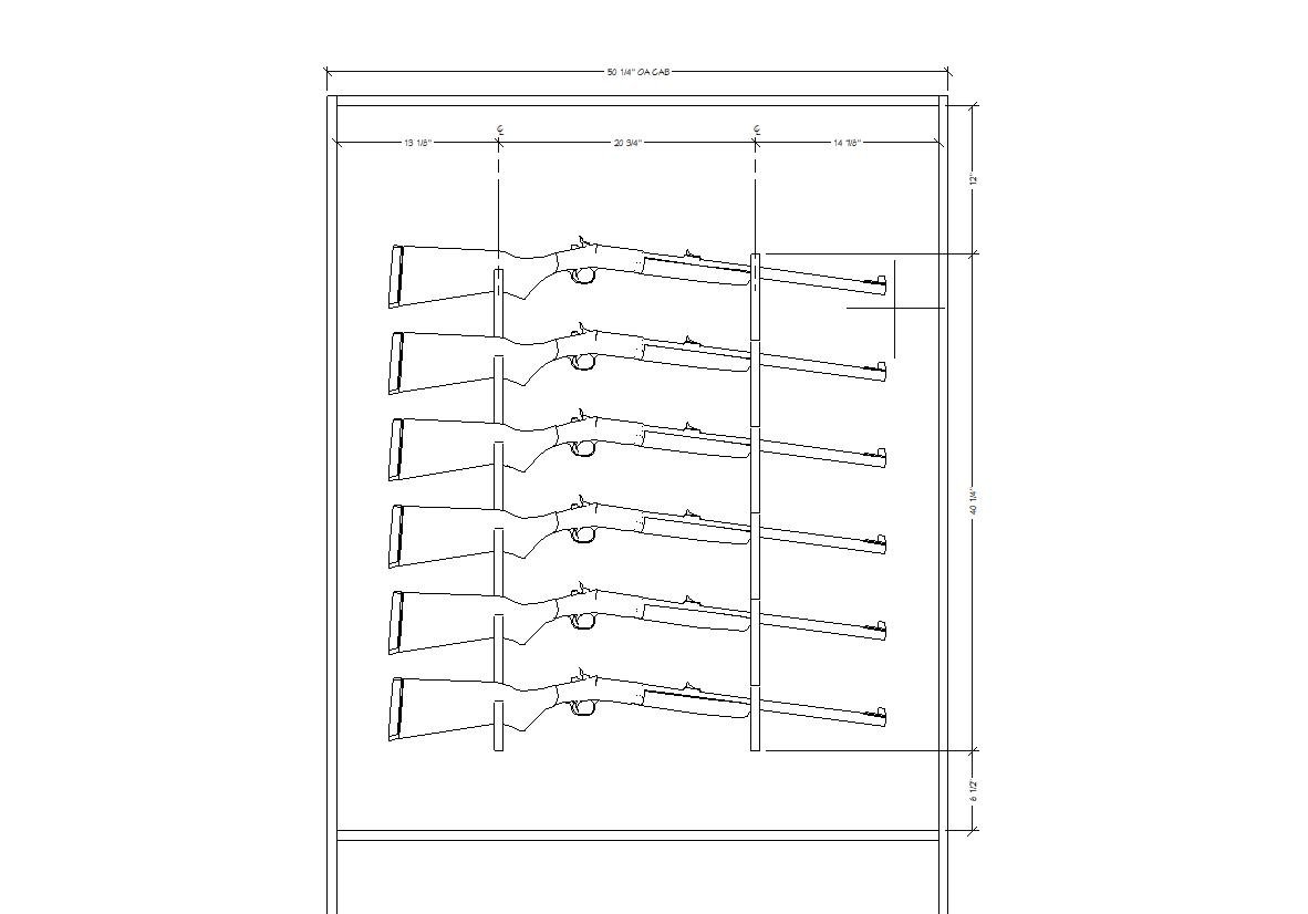

Michael_Gia Posted March 3 Share Posted March 3 you know you're a redneck, when your detail plans have a gun rack... (sorry, couldn't help myself) 5 1 Link to comment Share on other sites More sharing options...
DBCooper Posted March 4 Share Posted March 4 I *think* you will get point markers added automatically anytime the dimension line loses the original object it was dimensioning to. For example, if your dimension is attached to a cross section line, and the program regenerates the cross section line, then it will get replaced with a point marker. This is why you don't really want to dimension to cross section lines. My guess is that the dimension lines in your gun rack detail aren't actually locating what you want them to. You might want to post your plan and someone might be able to give you a better answer as to why it is happening. As far as this happening more often in X17, I hadn't really noticed it myself. I would suggest that you report it to Chief though if you ever want them to change it. Link to comment Share on other sites More sharing options...
MollyNDG Posted March 10 Share Posted March 10 On 3/4/2026 at 9:54 AM, DBCooper said: I *think* you will get point markers added automatically anytime the dimension line loses the original object it was dimensioning to. For example, if your dimension is attached to a cross section line, and the program regenerates the cross section line, then it will get replaced with a point marker. This is why you don't really want to dimension to cross section lines. My guess is that the dimension lines in your gun rack detail aren't actually locating what you want them to. You might want to post your plan and someone might be able to give you a better answer as to why it is happening. As far as this happening more often in X17, I hadn't really noticed it myself. I would suggest that you report it to Chief though if you ever want them to change it. I think this issue is more than dimensions being pulled to cross section lines, I have very intentionally fixed all dimensions in a CAD detail, closed and reopened it, only to have the point markers show up again. I wasn't having this issue in X16. It also is not a point to point dimension tool issue, the dimensions are pulling to lines. Seems like its something that needs to be reported. Link to comment Share on other sites More sharing options...
DrawingABlank Posted March 10 Share Posted March 10 Not sure it is related, but I am fairly certain a couple dimension lines attached to items not actually displayed. (x17) It took a while to figure out. Forgot to look into more after. I'll go back and try to replicate it. Just have to remember what plan and elevation. Maybe something similar is happening? Link to comment Share on other sites More sharing options...

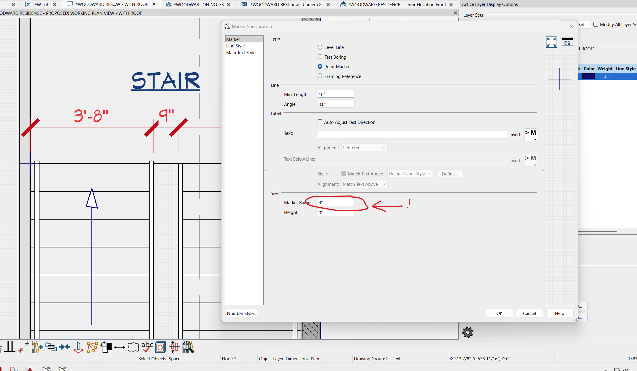

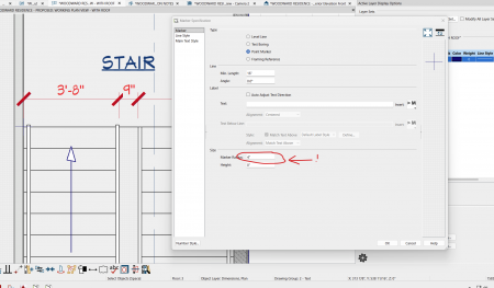

JKEdmo Posted March 10 Share Posted March 10 On 3/3/2026 at 9:41 AM, para-CAD said: It sucks that the marker can’t have zero size Actually you can set the radius to zero and the marker will go away (X17): 1 Link to comment Share on other sites More sharing options...
ComputerMaster86 Posted March 11 Share Posted March 11 (edited) 15 hours ago, MollyNDG said: I think this issue is more than dimensions being pulled to cross section lines, I have very intentionally fixed all dimensions in a CAD detail, closed and reopened it, only to have the point markers show up again. I wasn't having this issue in X16. It also is not a point to point dimension tool issue, the dimensions are pulling to lines. Seems like its something that needs to be reported. I had a similar experience, I don't remember having the issue in prior versions of Chief Architect Premier. I don't remember for X16 if I was experiencing the issue. But the issue seems prevalent in X17 in CAD Details. Two things for me... I never use the Point to Point Dimension tool (I sort of hate that tool.) and I am always snapping dimensions to objects displayed on screen. I just reported this to chief and included two different plan files with specific CAD Detail examples. I will see what they say. . Edited March 11 by ComputerMaster86 1 Link to comment Share on other sites More sharing options...
kwhitt Posted 1 hour ago Author Share Posted 1 hour ago On 3/3/2026 at 1:57 PM, Michael_Gia said: you know you're a redneck, when your detail plans have a gun rack... (sorry, couldn't help myself) Funny! It's actually a gun room that I'm working on. Attached are the 3D illustrations. FYI - It wasn't me who down-voted your post. I found your comment funny. CAM01-CAM08_XXXXX Gun Room_03-01-26.pdf Link to comment Share on other sites More sharing options...
