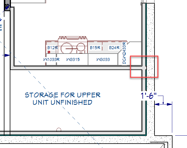

Doug_N Posted August 1, 2025 Share Posted August 1, 2025 The largest problem, from my point of view, is the successful creation of rooms. As you noted, when an interior wall intersects a furred wall, because a furred wall has a "no room definition" specification. This means difficult trouble shooting when trying to figure out why some rooms just don't maintain separation. The interior wall must be extended past the furred wall to the exterior foundation wall, and that creates a small wall between the furred wall and exterior wall. Furred Wall Room Creation.mp4 1 1 Link to comment Share on other sites More sharing options...

mthd97 Posted August 3, 2025 Share Posted August 3, 2025 On 8/1/2025 at 10:04 PM, Doug_N said: The largest problem, from my point of view, is the successful creation of rooms. As you noted, when an interior wall intersects a furred wall, because a furred wall has a "no room definition" specification. This means difficult trouble shooting when trying to figure out why some rooms just don't maintain separation. The interior wall must be extended past the furred wall to the exterior foundation wall, and that creates a small wall between the furred wall and exterior wall. Furred Wall Room Creation.mp4 I am trying to follow this post and from what I learned in this video below, is that the wall needs to be specifically marked as a furred wall in DBX. That stops it from connecting to the concrete stem wall because it doesn’t create an island room. Is that what is causing the problem above that you have highlighted in red or is it something else in this case ? https://www.chiefarchitect.com/videos/watch/93/creating-basements-with-furred-walls.html Link to comment Share on other sites More sharing options...
Michael_Gia Posted August 3, 2025 Author Share Posted August 3, 2025 14 minutes ago, mthd97 said: video below everything works amazing in chief videos. it’s in the real world where it sometimes breaks down. Which is fine if Chief would also admit to that so we don’t all beat our heads against a wall assuming we did something wrong. The furred wall feature will only ever work properly the day Chief allows us to assign “connection priority” values to a given wall. this is the tool we have been missing for the last 20 years. 1 Link to comment Share on other sites More sharing options...
mthd97 Posted August 3, 2025 Share Posted August 3, 2025 On 8/3/2025 at 7:13 PM, Michael_Gia said: everything works amazing in chief videos. it’s in the real world where it sometimes breaks down. Which is fine if Chief would also admit to that so we don’t all beat our heads against a wall assuming we did something wrong. The furred wall feature will only ever work properly the day Chief allows us to assign “connection priority” values to a given wall. this is the tool we have been missing for the last 20 years. They are sort of allowing us to do that by marking a wall as furred in the DBX so it doesn’t connect to the stem wall. I am assuming that it has to be a square room first before it will obey those rules ? If that’s the case we may have to use invisible walls as well ? I haven’t tested it yet. I have so far found that everything in their videos that I have looked up work fine for me. But I only watch the ones that concern me. I don’t like fighting any CAD software program to get it to model in the manner that is straight forward and logical. It can take more time in other CAD programs to set connection defaults but at least I don’t get as frustrated when fighting the automation of the CA room module control. I know it’s much much better now and if we are doing many non complicated project homes. Chief is the best tool for full construction drawings with framing and a useable ML and including cabinets. The more custom design shape homes we design, the more the need for other CAD solutions. If I wanted my house to be shaped like a stealth bomber I would use a CAD program that models jet planes lol. We all work with Chief according to its automated rules and we all have to be aware of how to get the model to build correctly with it. Chief is quite simple to use in comparison to other CAD/BIM systems out there but along with more complexity comes a steeper learning curve and more time to design a building those models correctly. The more you want your house to be different and customisable the more sophisticated the CAD software needs to become. I agree with your wall connection wishes and keep on making suggestions of how you would like those wishes to be implemented in CA. Link to comment Share on other sites More sharing options...
