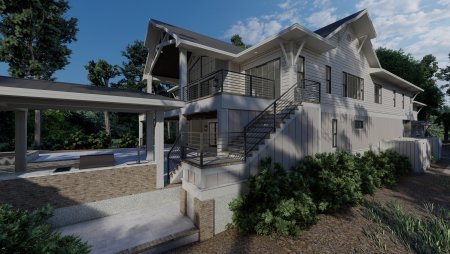

RobDesLLC Posted May 5 Share Posted May 5 I converted a wall cabinet into a batten. I created a wall type where the sheathing is a 1/4" sheet that represents a fibercement sheet product. The batten then snaps to the wall, and I adjust the height and positioning in an elevation view. I use the multiple copy tool to distribute battens across the wall, adjusting for windows and doors as needed. This results in battens with proper shadows in renderings, and I can estimate the material used for the battens as well. I have 2 example images below to illustrate it. Link to comment Share on other sites More sharing options...
decorators3 Posted May 5 Author Share Posted May 5 22 minutes ago, RobDesLLC said: I converted a wall cabinet into a batten. I created a wall type where the sheathing is a 1/4" sheet that represents a fibercement sheet product. The batten then snaps to the wall, and I adjust the height and positioning in an elevation view. I use the multiple copy tool to distribute battens across the wall, adjusting for windows and doors as needed. This results in battens with proper shadows in renderings, and I can estimate the material used for the battens as well. I have 2 example images below to illustrate it. 23 minutes ago, RobDesLLC said: I converted a wall cabinet into a batten. I created a wall type where the sheathing is a 1/4" sheet that represents a fibercement sheet product. The batten then snaps to the wall, and I adjust the height and positioning in an elevation view. I use the multiple copy tool to distribute battens across the wall, adjusting for windows and doors as needed. This results in battens with proper shadows in renderings, and I can estimate the material used for the battens as well. I have 2 example images below to illustrate it. WOW!! DID YOU USE ONLY CA FOR RENDERING Link to comment Share on other sites More sharing options...
RobDesLLC Posted May 5 Share Posted May 5 7 minutes ago, decorators3 said: The first image is a 3D perspective in Chief Architect. The second is a rendering in Lumion. Link to comment Share on other sites More sharing options...
decorators3 Posted May 5 Author Share Posted May 5 45 minutes ago, RobDesLLC said: The first image is a 3D perspective in Chief Architect. The second is a rendering in Lumion. I figured as much - didn't think it was rendered in CA. is Lumion or twin motion worth the investment? Link to comment Share on other sites More sharing options...
Renerabbitt Posted May 5 Share Posted May 5 3 hours ago, RobDesLLC said: I converted a wall cabinet into a batten congrats on getting that done. it's a ton of work when comparing to the material region tool FYI. Hope this helps someone. 1 Link to comment Share on other sites More sharing options...
