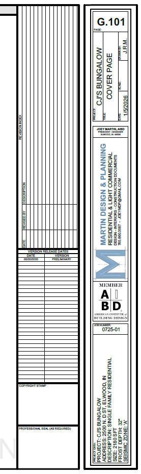

JKEdmo Posted February 3 Share Posted February 3 20 minutes ago, Doug_N said: Depending on the size of the drawing sheet, having the title boxes on the right side of the drawing running vertically allows the most drawing area. It seems to be an informal norm for most architectural, structural, mechanical, and electrical drawings. Just my experience anyway. I would agree. It's most common to have titleblocks on the right side vertically. If the set is rolled, it means you do not have to unroll the roll to see all the plan set information. Also, using a vertical strip for info means you are left with a more square drawing area on the sheet than if you did a horizontal title block. Those are two advantages I can think of. 1 Link to comment Share on other sites More sharing options...
joey_martin Posted February 3 Share Posted February 3 I have been working in the industry since the late 80's early 90's, right side vertically is the standard. When rolled, you should be able to find all relevant information from the title block without needing to unroll. 3 Link to comment Share on other sites More sharing options...

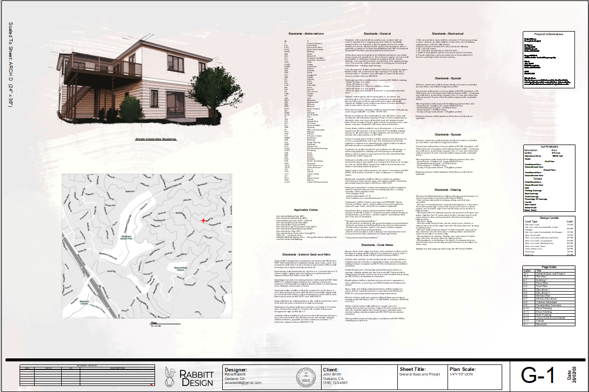

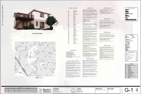

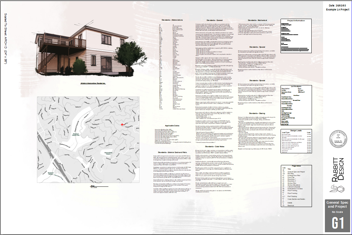

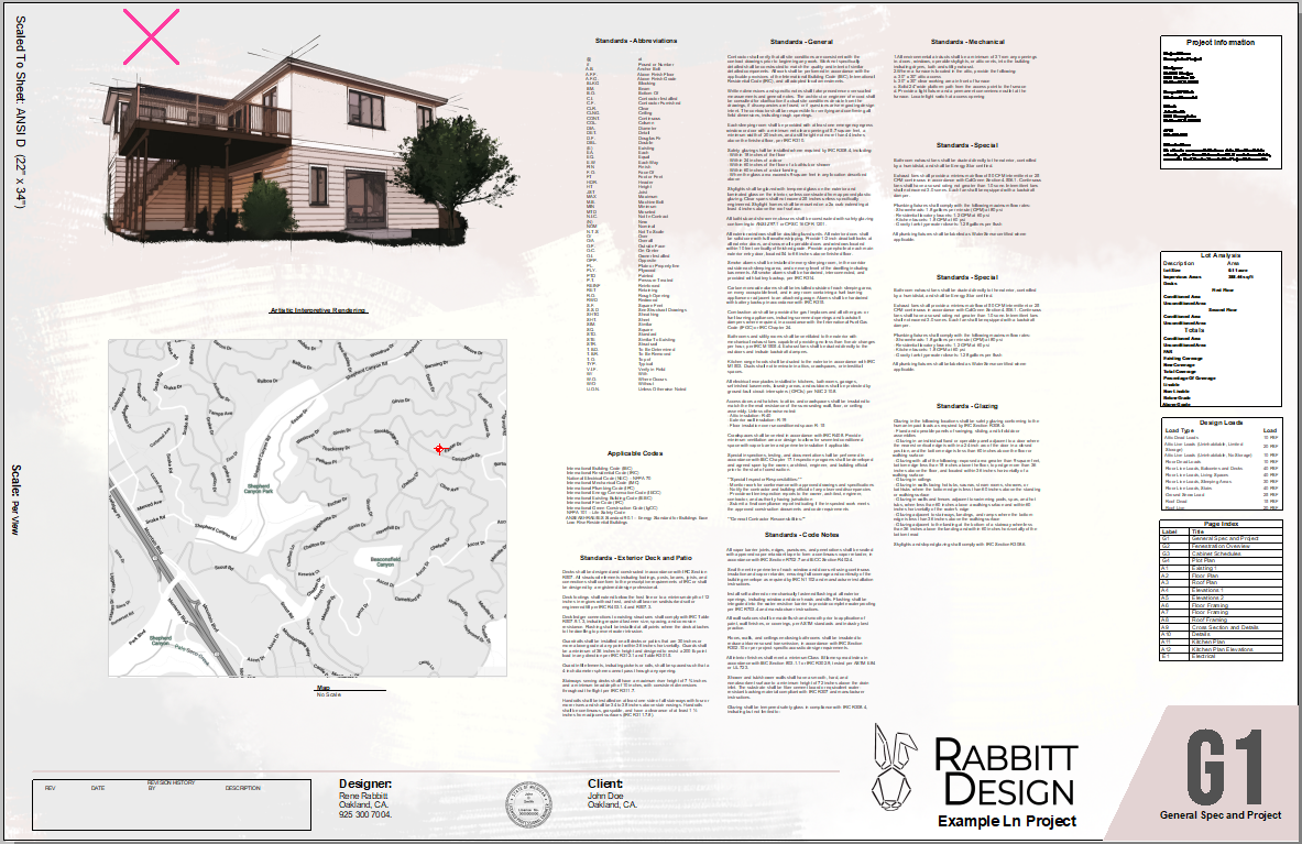

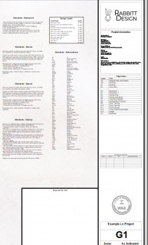

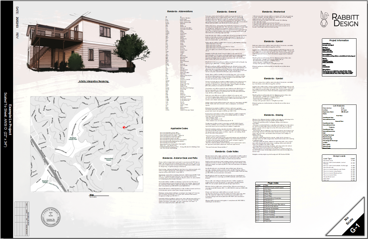

Renerabbitt Posted February 4 Share Posted February 4 (edited) FYI my templates come pre-packaged with 6 different title block styles in various sheet sizes and include different color washes for the first page Non traditional title blocks still have an information block at the rightmost roll-edge(To the negative reaction. Not sure why I earned that, my name was used to describe a layout style that does go against the typical standard, and I have many different styles, of which are designed and offered up here for free for reference... show some love, same team!) Edited February 4 by Renerabbitt 2 1 Link to comment Share on other sites More sharing options...

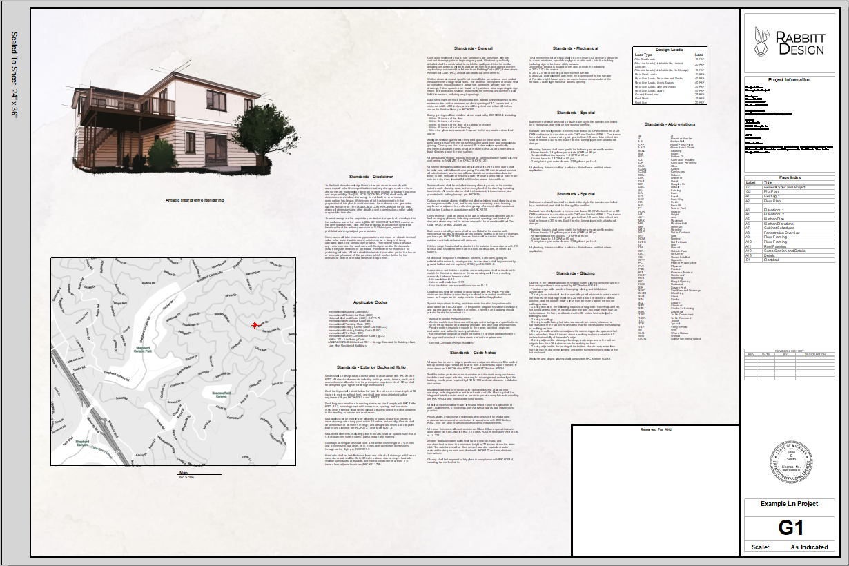

SHCanada2 Posted February 4 Share Posted February 4 rene's first one is one I tend to see from some of the bigger outfits: Link to comment Share on other sites More sharing options...
Renerabbitt Posted February 4 Share Posted February 4 15 hours ago, para-CAD said: Thanks on behalf of all the people you have helped. Thank you I appreciate that 10 hours ago, Doug_N said: but that was not so germain to what is the standard. thanks as well. I love trying to develop some thick skin and an open mind. this thread made me realize that I wanted to move the title block info closer on the rolled edge for non-standard right sidebar layouts..so hey I got something out of it Link to comment Share on other sites More sharing options...
