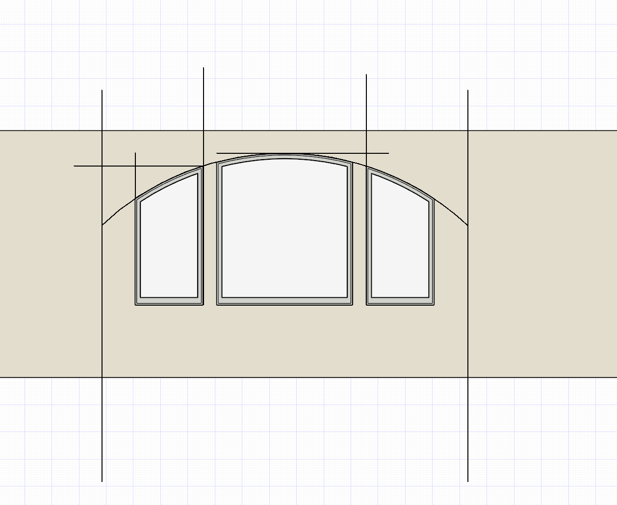

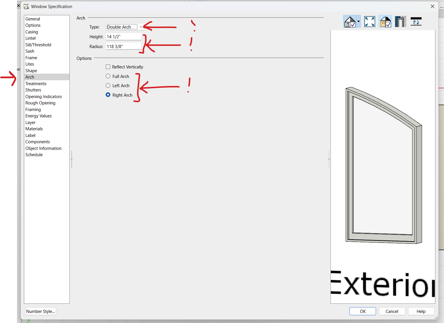

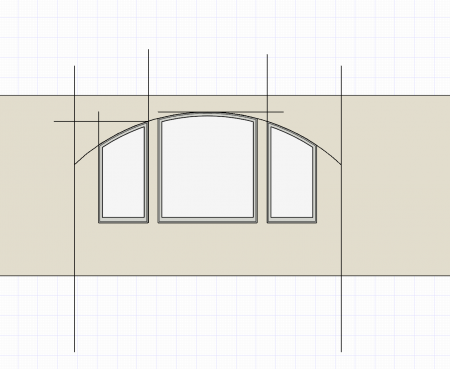

JKEdmo Posted August 28, 2025 Share Posted August 28, 2025 2 hours ago, TSarantopulos said: I have a dilemma. I'm trying to make this set of transom windows above follow an arc. I can arch each individually but cant get them to follow a continuous arch through the set. I could make it one big window and then use 3D solids to indicate the casing & frame for 5 individual windows. Any other suggestions? I took a stab at this and made some progress. My attached test PLAN (X17) is simpler example, but should apply to your condition. I drew CAD helper lines in elevation to be able to get exact measurements for the heights, radius, etc. I think the key is selecting the "double arch" type for the shallow arc shape of the arch. Right or Left Arch for the side units and Full Arch for the middle unit. Mulling the units together did not work perfectly, but you might have better luck. Good luck! Jim SAMPLE ARCH COMBO WINDOW.plan 1 Link to comment Share on other sites More sharing options...

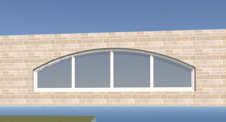

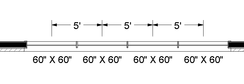

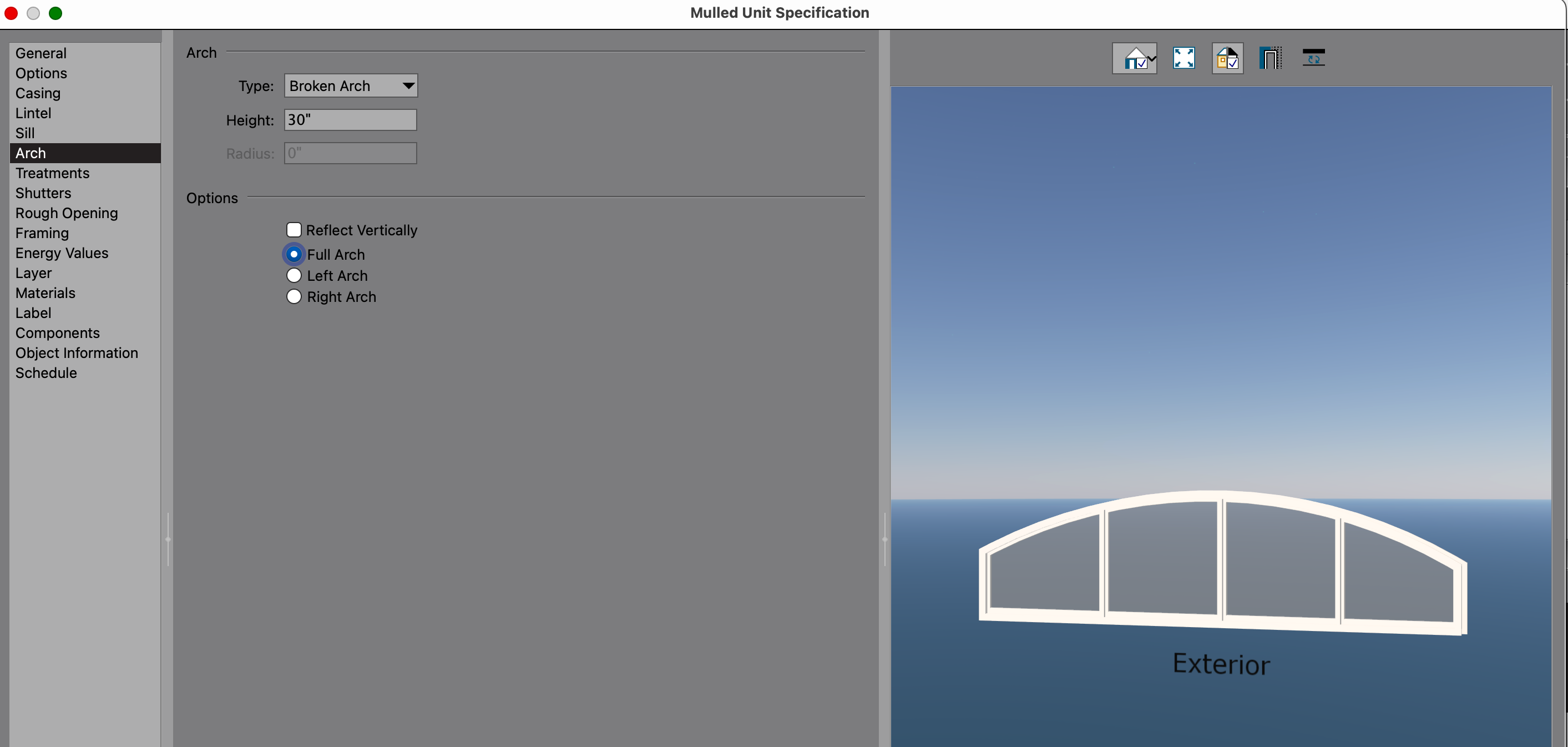

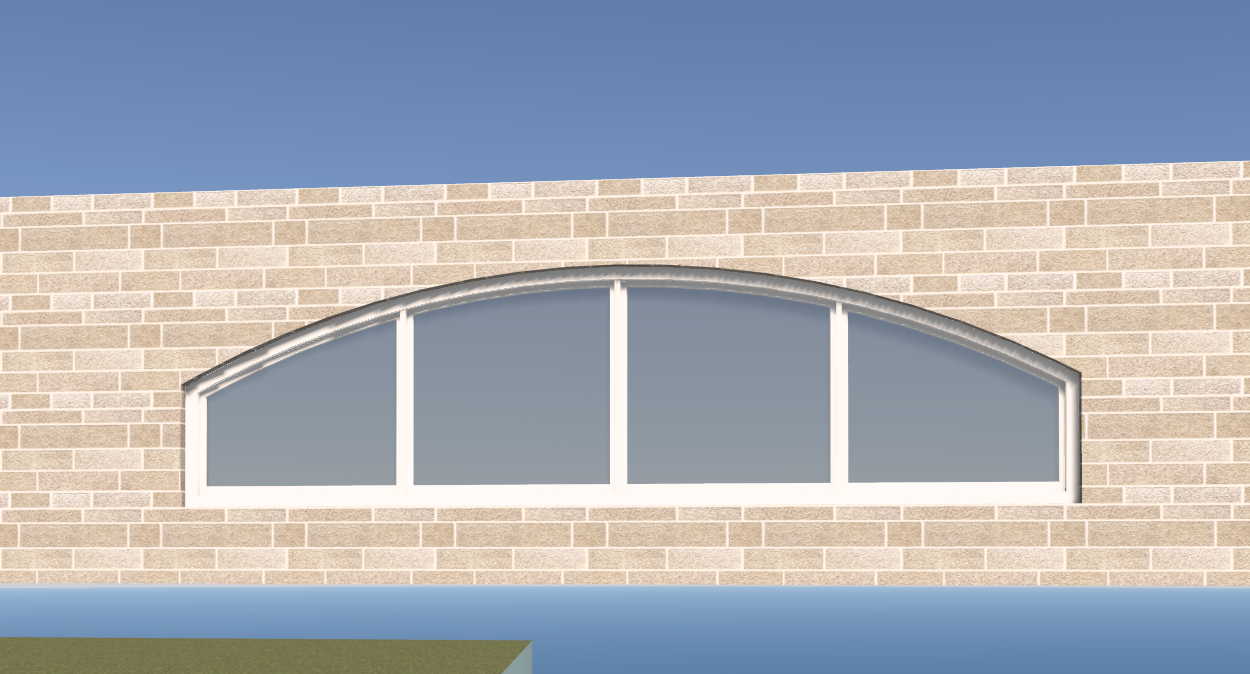

Alaskan_Son Posted August 29, 2025 Share Posted August 29, 2025 Create 5 side by side windows that are all the same height (height of the center unit). Group select the windows and block them. Give the Mulled unit an Arch (Broken Arch) Adjust as necessary. 1 2 Link to comment Share on other sites More sharing options...

TSarantopulos Posted August 29, 2025 Author Share Posted August 29, 2025 (edited) OK I made all the windows the same height and mulled. However when I try to arch the options are greyed out. Is it because I haven't "blocked" it? How do you do that if that's the issue? BTW this is using version 16. Edited August 29, 2025 by TSarantopulos Link to comment Share on other sites More sharing options...
DBCooper Posted August 29, 2025 Share Posted August 29, 2025 Yes, you need to "block" them, which means you make a mulled unit out of all 5 of them, before you can add the arch. You are adding the arch to the mulled unit and the program will auto adjust the individual windows for you. It should work even if you block all of the lower and upper windows together first before you block the 5 horizontal units together. In other words, nested mulled units. It's the final unit that gets the arch. If you still can't get it to work, then you should probably post your plan for someone to take a look at. Link to comment Share on other sites More sharing options...
Michael_Gia Posted August 29, 2025 Share Posted August 29, 2025 14 hours ago, TSarantopulos said: when I try to arch the options are greyed out. Make sure that when you line up your windows they are properly spaced. When you select them to block them together, make sure only the windows are selected and nothing else, then you will have the Arch tab available. Link to comment Share on other sites More sharing options...
