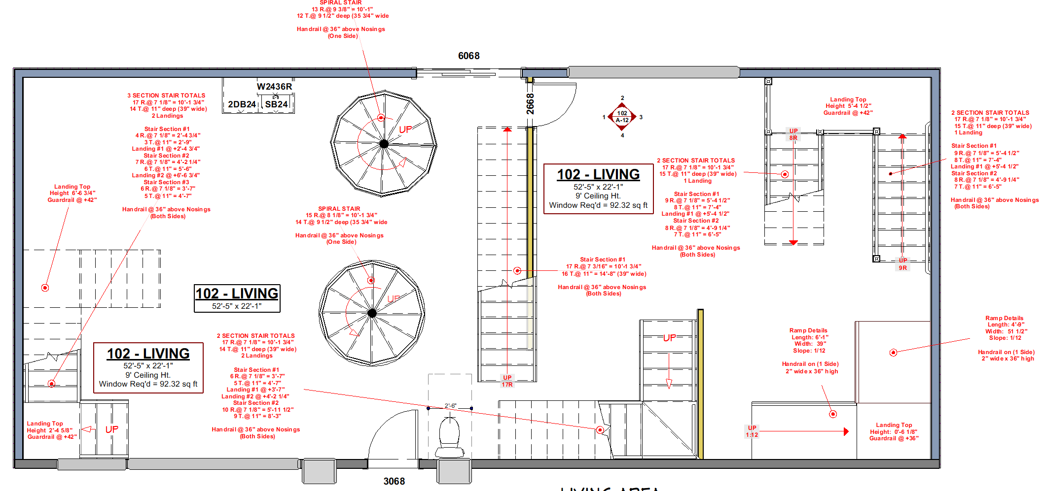

Joe_Carrick Posted January 21, 2023 Share Posted January 21, 2023 My Stair macros are embedded in a Text Box and stored in the Library. When I place that in a Plan and connect to a Stair with an arrow the macros execute and display the Stair and Landings information. This works for Straight, "L" & "U" shaped Stairs. It won't connect to a Stair in Section so I manually label and annotate there. Hoefully we'll get the ability to connect in Sections in a future version. 1 Link to comment Share on other sites More sharing options...

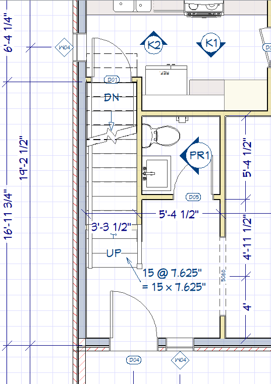

Doug_N Posted January 21, 2023 Share Posted January 21, 2023 Shayne, In plan view you can attach test to the stairs and use a macro like %num_treads+1% Risers Run %tread_depth%" Rise %riser_height.round(2)%" The number of treads is plus one to count risers which is the way most architectural drawings will specify a flight of stairs. Unfortunately, you can't do this in a section or elevation view with macros. 1 Link to comment Share on other sites More sharing options...
Doug_N Posted January 21, 2023 Share Posted January 21, 2023 If you want to see those in section you can do it by attaching a variable to the macro that identifies which stair you are talking about like this: Here I use the global variable $s1 to identify which stair set I am referring to, $s2 for the next stair set and so on. %$s1riser_total=num_treads+1% Risers Run %$s1run=tread_depth%" Rise %$s1rise=riser_height.round(2)%" Then in a text box next to the stairs in elevation you put %$1riser_total% Risers Run %$s1run%" Rise %$s1rise%" A bit of a kludge but it works. 2 Link to comment Share on other sites More sharing options...

ValleyGuy Posted January 21, 2023 Author Share Posted January 21, 2023 Hey guys, thanks for all the help here. Wow, what started out as a simple question and answer turned into roadside assistance for a broken vehicle. I appreciate all of you taking some time on your Saturday to help me out. The macros work great! Link to comment Share on other sites More sharing options...

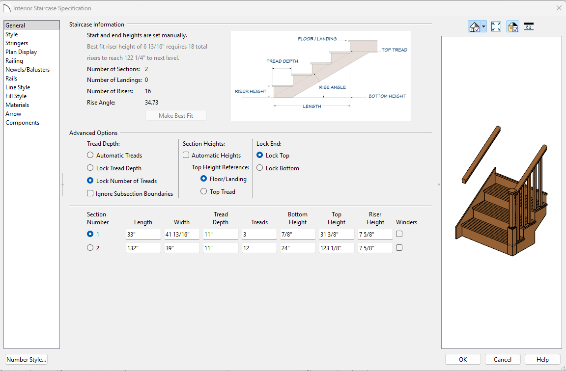

Alaskan_Son Posted January 21, 2023 Share Posted January 21, 2023 50 minutes ago, ValleyGuy said: I can't seem to attach a leader line though. 1 2 Link to comment Share on other sites More sharing options...
ValleyGuy Posted January 21, 2023 Author Share Posted January 21, 2023 Bingo we have a winner! That cured my unattached arrow issues. Some of the most straight forward things make my hair turn gray right before I pull it out. Thank you so much for figuring that out. Link to comment Share on other sites More sharing options...
