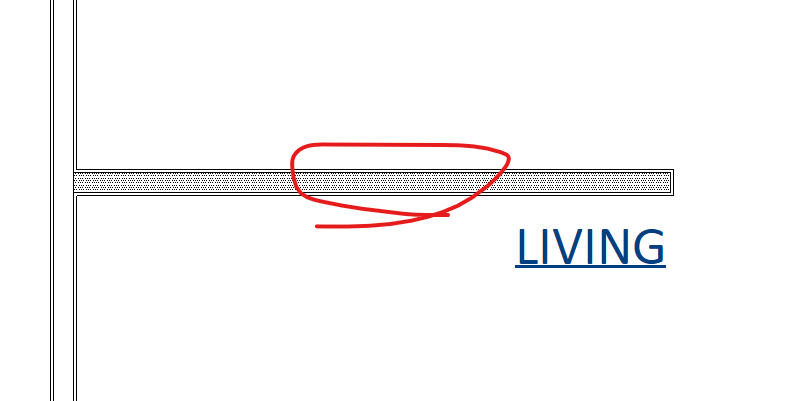

builtright3 Posted November 8 Share Posted November 8 Wall Types I was trying to come up with a wall type for my new walls that will show when I print in black and white. I thought maybe dots would work but when I print, it doesn’t show the dots. I don’t like solid black walls. I prefer gray but it doesnt show up when print in black and white. I have to print in color or grey scale Any Ideas, Anyone? Link to comment Share on other sites More sharing options...

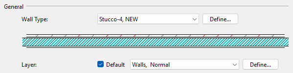

builtright3 Posted November 8 Author Share Posted November 8 I just used angle hatching for now. Seems to work fine at 1" or 3/4 when I print black and white. Link to comment Share on other sites More sharing options...

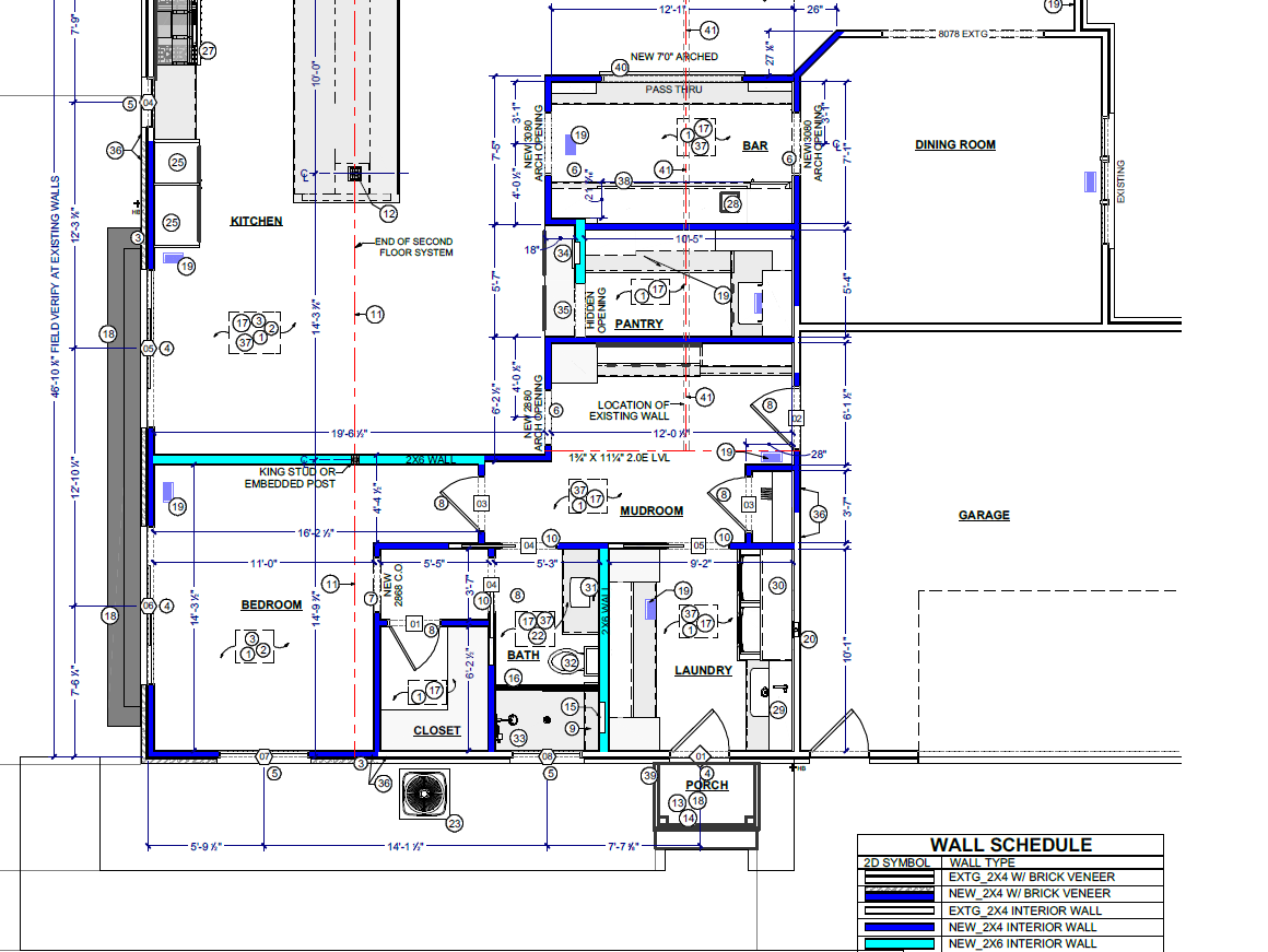

Rookie65 Posted November 8 Share Posted November 8 I use a solid color for existing walls, then use some of the geometric shapes, etc. for other wall type fill. You can use whatever color you want, yet obviously dark ones print best. It helps when labeling the wall types on the drawing so you know what types are where. I don't know if Chief will let you adjust the size and angle of the shapes, yet that helps to in separating them. 1 Link to comment Share on other sites More sharing options...
joey_martin Posted November 12 Share Posted November 12 FWIW...we color code our new walls and the framers love it. Very easy to read. 1 Link to comment Share on other sites More sharing options...

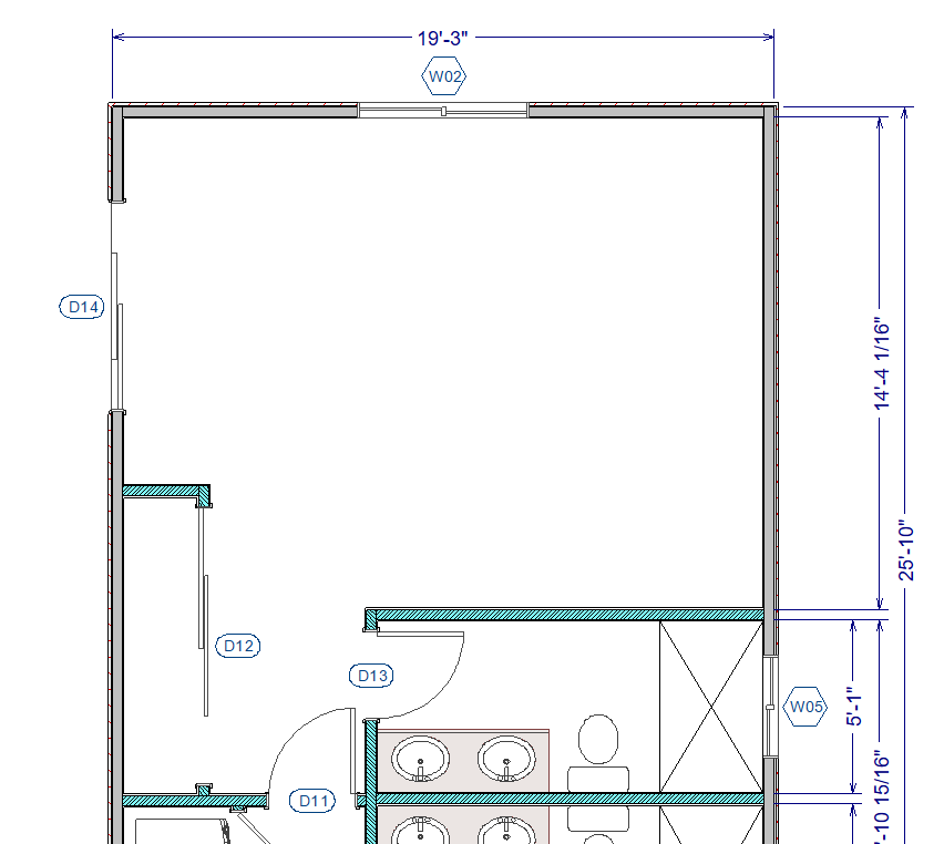

builtright3 Posted November 12 Author Share Posted November 12 2 hours ago, joey_martin said: FWIW...we color code our new walls and the framers love it. Very easy to read. Thank you Joey for your response. I color my walls also but the problem is I need them to show up for black and white copy's. You gave me an idea; Im thinking to get the best of both worlds I can do the backround color with angle hatching so the hatching will show up in black and white print. 1 Link to comment Share on other sites More sharing options...

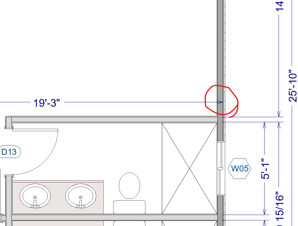

builtright3 Posted November 12 Author Share Posted November 12 This is perfect for me, becasue when I need to run something over a wall such as an arrow you can see it clearly. With black walls you cant see anything. Personally I like this look a lot. Link to comment Share on other sites More sharing options...

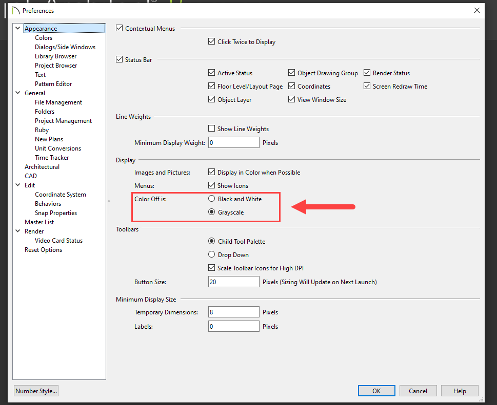

ComputerMaster86 Posted November 13 Share Posted November 13 I often send my plans views to layout with color turned off. There is a setting in preferences that controls whether turning color off does pure black and white or gray scale. I didn't know if this was anything related to the original issue but, I thought I would mention it. Link to comment Share on other sites More sharing options...
builtright3 Posted November 13 Author Share Posted November 13 2 hours ago, ComputerMaster86 said: I often send my plans views to layout with color turned off. There is a setting in preferences that controls whether turning color off does pure black and white or gray scale. I didn't know if this was anything related to the original issue but, I thought I would mention it. Thats intresting. I will have to exsperiment with that setting in relation to view and printing. Thank You Link to comment Share on other sites More sharing options...
