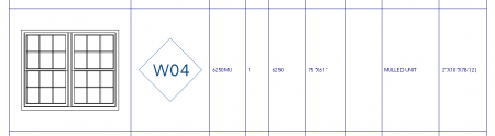

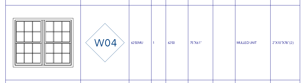

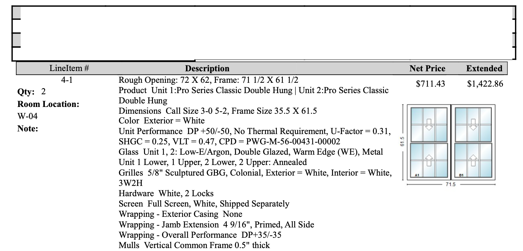

DefinedDesign Posted July 16, 2025 Share Posted July 16, 2025 Hi all, I could really use some help dialing in the sizing for a mulled window unit in Chief Architect Premier X16. In the plan, are two standard 36” x 60” double-hung windows next to each other and mulled. After sending the schedule to our window supplier, they returned a spec showing the actual frame size is 71.5” x 61.5” (see attached). I’m struggling to recreate that exact frame size in Chief so the schedule and elevations match what was actually ordered, and ensure the framing is correct for Rough Opening. I've tried adjusting each individual window size and then mull them back together - it seems like this should work but it doesn't. Unsure of what I'm doing wrong. Link to comment Share on other sites More sharing options...

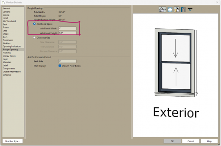

tundra_dweller Posted July 16, 2025 Share Posted July 16, 2025 I agree with everything Shane said, but if you want to recreate the window as spec'd by the supplier: 1. Change the frame size on your two windows to 35.5 x 61.5. 2. Using your temp dimensions (if set to pick up opening "sides") or some other method to set a 1/2" space between your two window frames. 3. Mull the two windows. 4. Open the mulled unit and make sure your rough opening settings are at 1/2" total width clearance and 1/2" total height clearance. It shouldn't matter whether you use the "Additional Space" or "Clearance Gap" method in the rough opening setting, just that the overall clearances are correct. Note: Your mulled units will not take on the rough opening settings from the windows you are mulling, for me they only seem to come in with a 1" clearance gap for width & height. If there's a default setting to change the R.O. setting for mulled units, I'm not finding it. 1 Link to comment Share on other sites More sharing options...

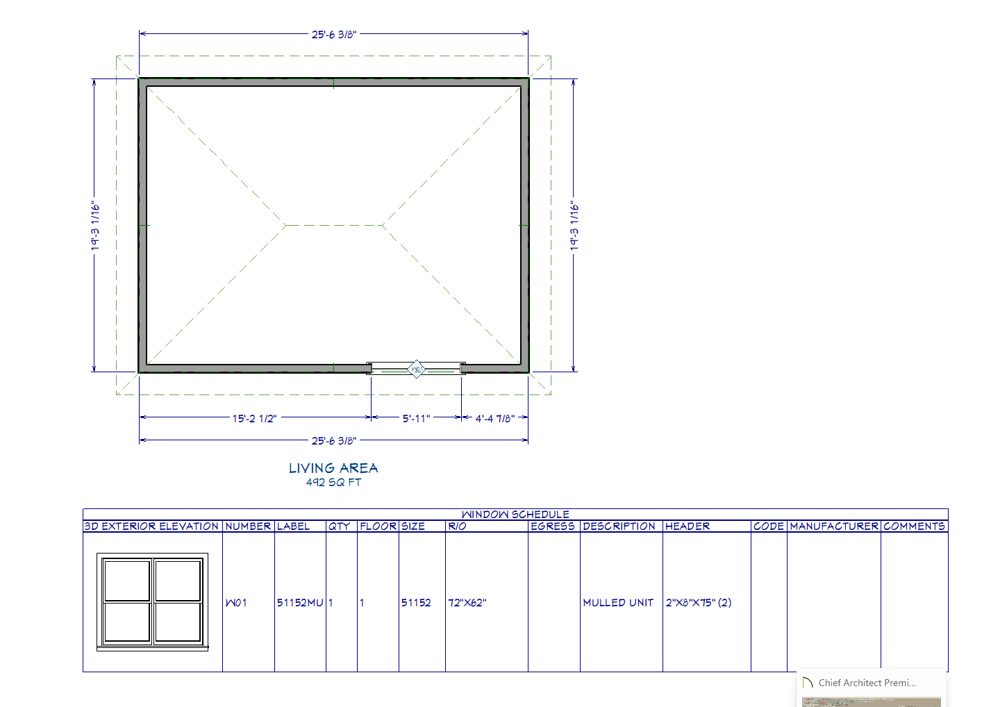

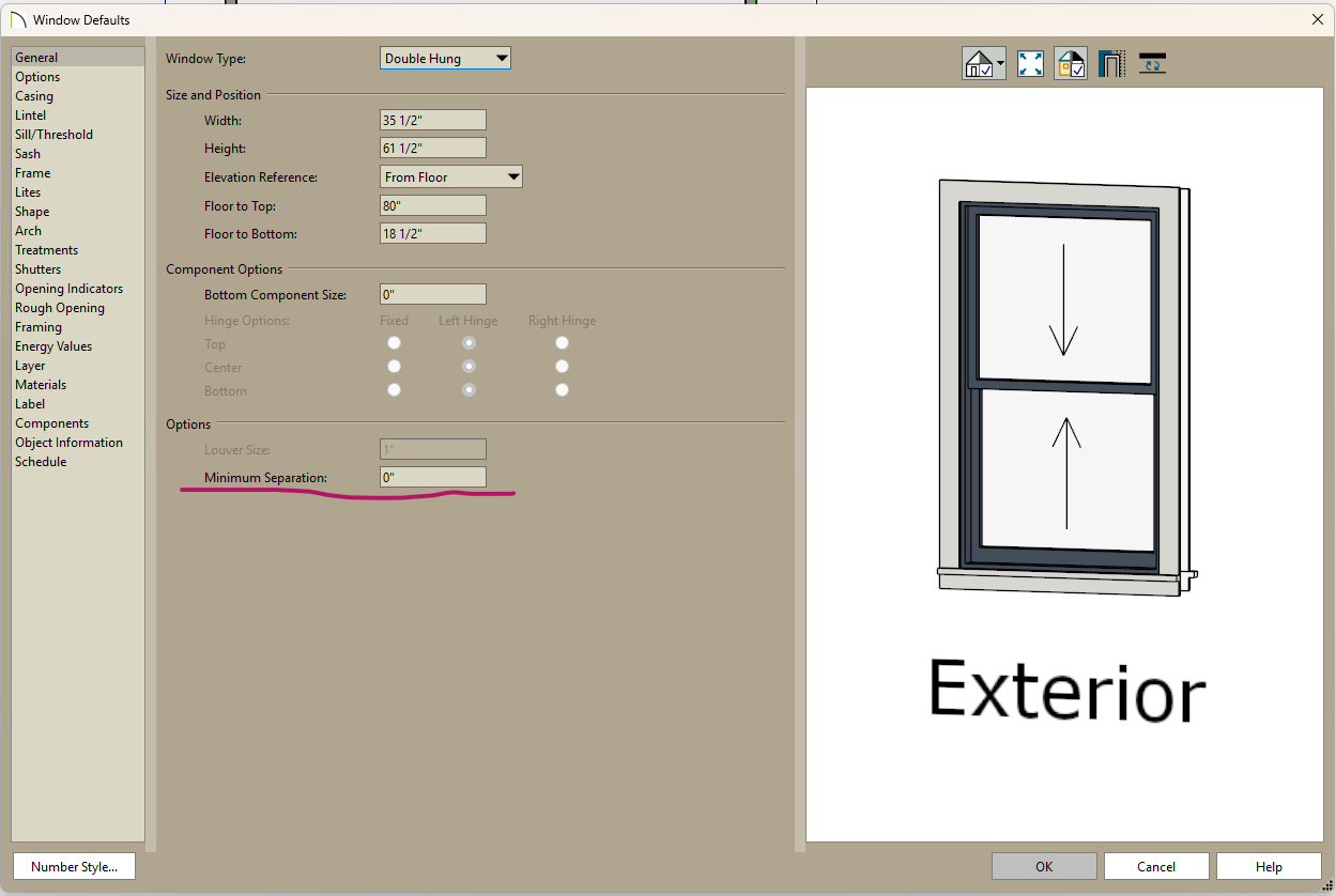

MPDesign Posted July 18, 2025 Share Posted July 18, 2025 In my experience, you need to make sure your default setting for minimum separation is set to 0. Then your rough opening settings are set to the Manufacturer's offset. test plan for review attached. mulled window test.plan Link to comment Share on other sites More sharing options...
GeneDavis Posted July 18, 2025 Share Posted July 18, 2025 You need to know the mullion spec for that manufacturer's factory-mulled windows in that particular product line. It might be zero, or maybe a half inch, but whatever it is it is used by you in placing and joining the windows. Those manufacurer's sizing charts are the resource, or a quote can be used as you show. If you really want to get into the weeds, you can go to the maker's site and bore in to get .pdf views or CAD downloads of mull sections. 1 Link to comment Share on other sites More sharing options...
