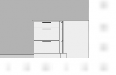

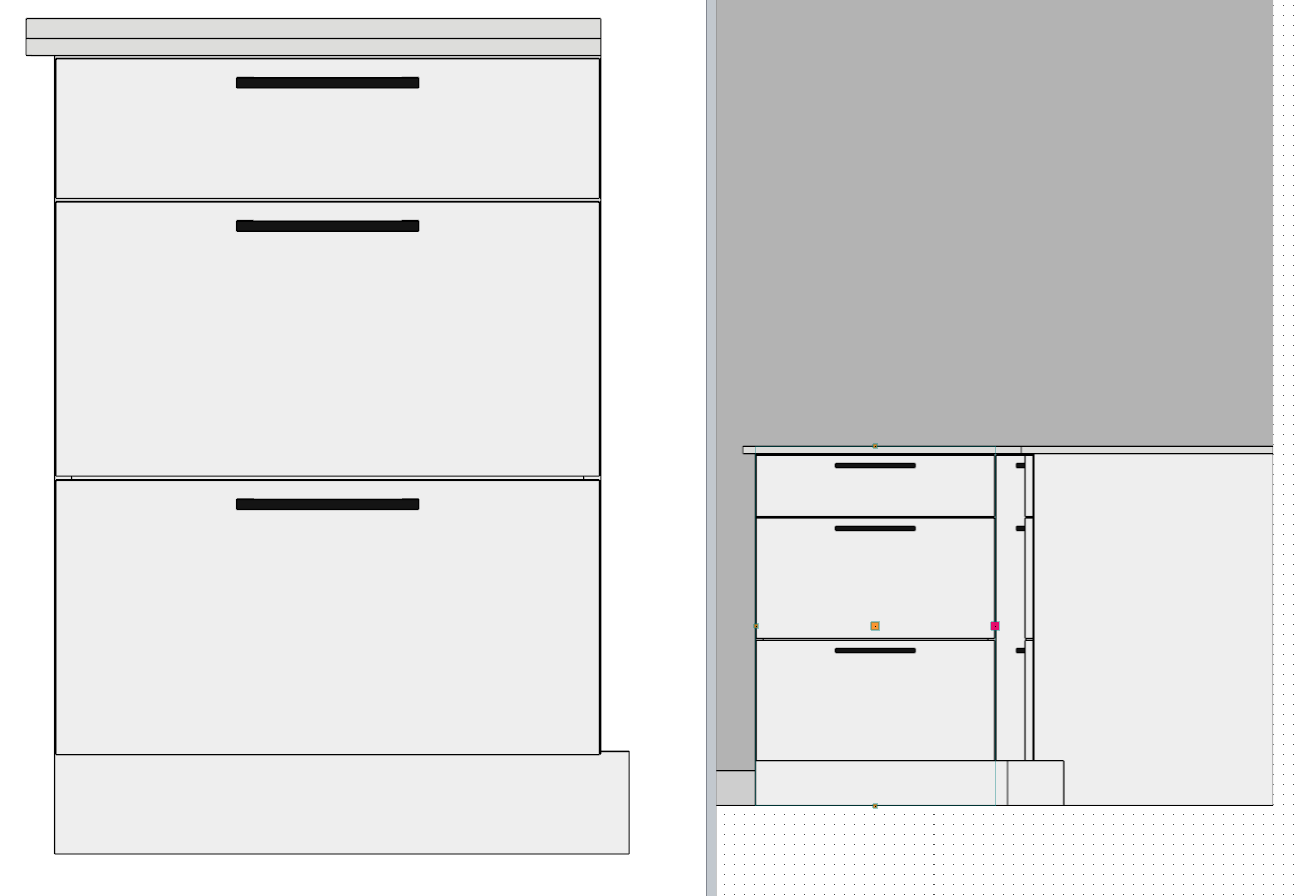

MollyNDG Posted April 30, 2025 Share Posted April 30, 2025 Hello all, Does anyone know why when I set a corner cabinet as a filler, and butt another base cabinet to it, the toe of that cabinet extends into the toe of the corner filler? When I open the cabinet's DBX it is showing the toe as extended. This is the only circumstance that I have seen this pop up. Thanks! Link to comment Share on other sites More sharing options...

PitMan71 Posted May 1, 2025 Share Posted May 1, 2025 Hey Molly, Thanks for posting the plan. this seems to be a bug. The cabinet only extends its to kick toward a corner cabinet. If it's a regular cabinet the extension isn't there. I would send this to support and see what they have to say on the matter. Be sure to include your .plan file. They usually respond within a few hours. Link to comment Share on other sites More sharing options...
MPDesign Posted May 1, 2025 Share Posted May 1, 2025 Molly I deleted the corner cabinet and placed a new base cabinet. Changed the default front of 3 drawers to 1 false drawer front. Then deleted hardware and stretched from left to right then turned into a corner cabinet. It looks like it's working. hth 410366274_CORNERCAB.TOE-working.plan Link to comment Share on other sites More sharing options...

DBCooper Posted May 1, 2025 Share Posted May 1, 2025 I think that is just the way that Chief handles the toe kick for all of the corner cabinets. With an L-shaped corner cabinet (or filler), they probably don't need to do this but for a diagonal front I think they want to extend the side toe kick to keep the diagonal front at the same depth without having a jog. There are a few things you can do if you really want to change this. One thing you can do is to make the corner cabinet an "architectural block" (by clicking on it while holding the shift key down). This prevents the side cabinets from connecting to it and extending the toe kick. It will have other side effects though so you will have to use a custom counter top and you might want to check whether or not your sides are marked as finished (if you care) and you might have to muck around with the arch block if you need to see it show up as a corner filler in the material list or schedule. Another thing you could do is build the corner filler by itself and convert it into a symbol object. This pretty much has all of the same side effects as the architectural block though. Another thing you could do is to remove the toe kicks from the cabinets, raise them up, and then build the toe kicks manually. Link to comment Share on other sites More sharing options...
