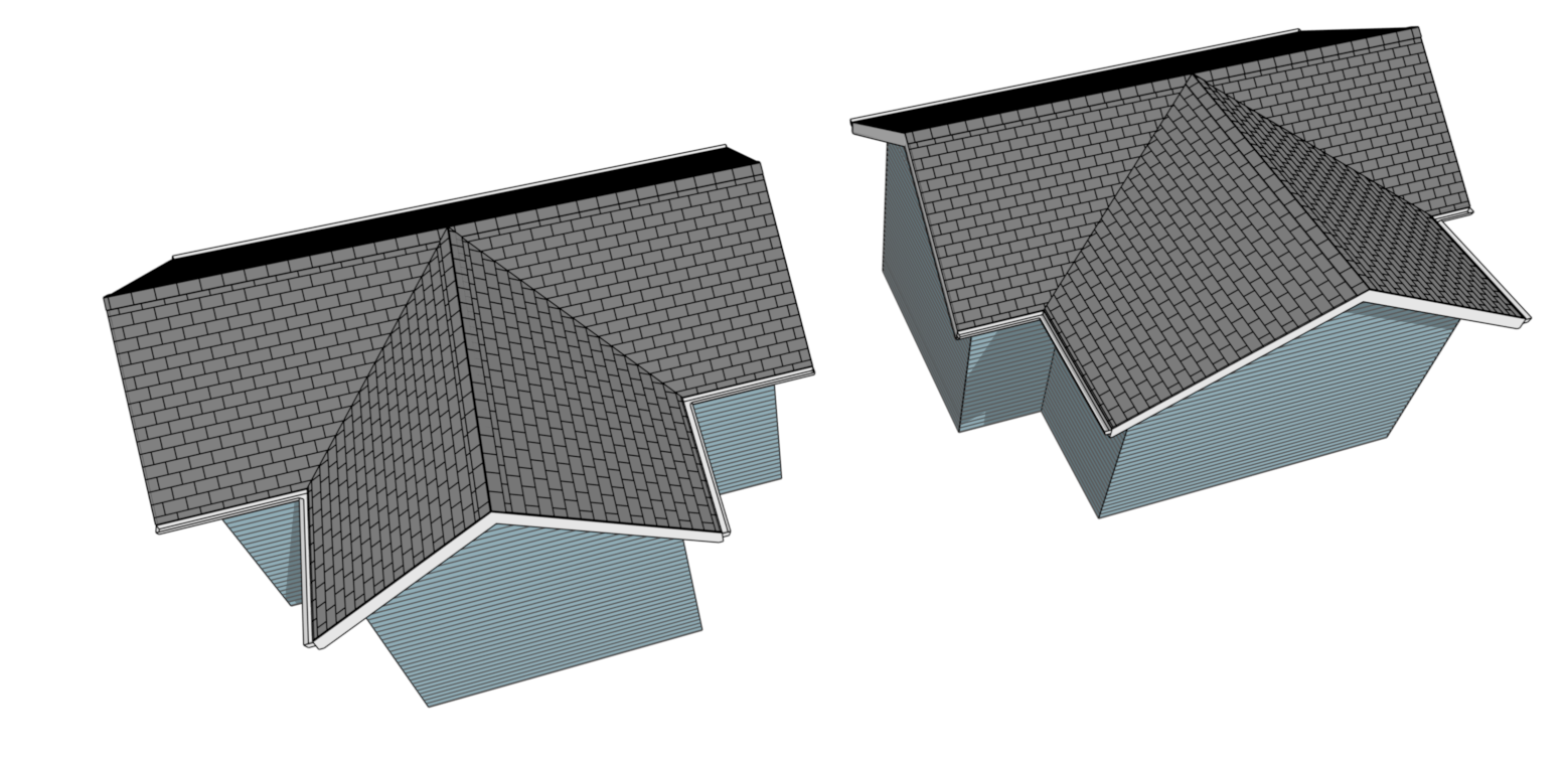

DBCooper Posted April 26, 2025 Share Posted April 26, 2025 Still not sure exactly what you are trying to do. If you have a T-shaped house with gables on the ends, the ridge lines are only going to line up if the ends of the house are the same size. If they are not the same size, then you can adjust the pitch to get the ridge to line up. See pictures below as an example. Link to comment Share on other sites More sharing options...

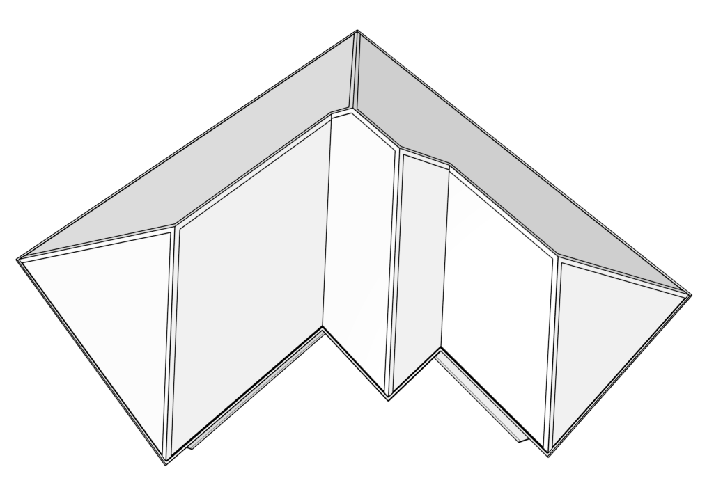

Build25 Posted April 26, 2025 Author Share Posted April 26, 2025 So I locked the fascia and adjusted the ridge height to meet the garage - but then this happens. Any quick fixes for this? Appreciate all the help! Link to comment Share on other sites More sharing options...
Rookie65 Posted April 26, 2025 Share Posted April 26, 2025 Lock the ridge height and the pitch. Let the fascia's take care of themselves Link to comment Share on other sites More sharing options...
GeneDavis Posted April 26, 2025 Share Posted April 26, 2025 Please take the time to learn to manually edit roof planes. And the best mode for editing is 3D perspective overview, color off, vector off, toggle patterns off. Like this. https://www.chiefarchitect.com/videos/watch/5447/roof-basics.html https://www.chiefarchitect.com/videos/watch/728/locating-roof-plane-intersections.html https://www.chiefarchitect.com/videos/watch/1500/the-dialogs-that-influence-roof-design.html 1 Link to comment Share on other sites More sharing options...
Doug_N Posted April 27, 2025 Share Posted April 27, 2025 23 hours ago, Build25 said: So I locked the fascia and adjusted the ridge height to meet the garage - but then this happens. Any quick fixes for this? Appreciate all the help! You are so close. Now you need to make the roof plans join. Here is a video that I made to address this exact situation. Sorry there is a glitch in the middle that cuts off a comment in mid sentence. Link to comment Share on other sites More sharing options...

Doug_N Posted April 28, 2025 Share Posted April 28, 2025 On 4/26/2025 at 3:53 PM, Build25 said: So I locked the fascia and adjusted the ridge height to meet the garage - but then this happens. Any quick fixes for this? Appreciate all the help! Here is a view and quote from the OP on what they are looking for after they did some editing.. I think my video covered that, unless I am missing something. Link to comment Share on other sites More sharing options...
