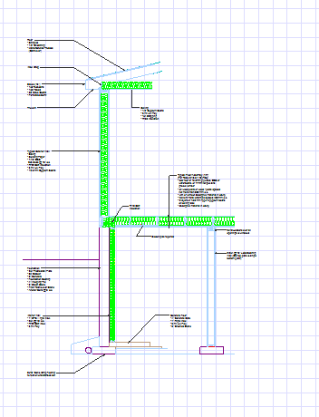

decorators3 Posted yesterday at 10:51 AM Share Posted yesterday at 10:51 AM Hi Somehow I managed to bring this up while working on a wall in my plan, but I have no idea what I did to activate it or what this view is called. I’m assuming it’s some type of wall schematic. Can someone tell me what it is, how I activated it, and whether it’s something I should be using when preparing plans? I’d like to understand what I stumbled across rather than just close it and move on! Thanks! Link to comment Share on other sites More sharing options...
Joe_Carrick Posted yesterday at 12:54 PM Share Posted yesterday at 12:54 PM Most likely you selected a room, not a wall. That appears to be the room dialog structural panel. Link to comment Share on other sites More sharing options...
joey_martin Posted yesterday at 06:38 PM Share Posted yesterday at 06:38 PM Are you using a plan created by someone else? That looks like a labeled section. If you didn't create it, it shouldn't be there. Or I am missing something B I G in the software that auto labels wall sections. Link to comment Share on other sites More sharing options...
javatom Posted yesterday at 07:13 PM Share Posted yesterday at 07:13 PM CA has some cad details that ship with the program. They are not plan specific. You might have opened one of those by accident. Link to comment Share on other sites More sharing options...
DBCooper Posted 22 hours ago Share Posted 22 hours ago (edited) Yeah, it's probably either a saved cad detail or cross section that was already annotated. It could always be something else like just a cad block, picture or pdf but I don't think the program generated it automatically. You can often tell what kind of view it is by the tab at the top of the window. The small graphic will tell you what type of view it is and the name of the view should also give you a clue. You can also open up the project browser and the program will use a different graphic for any saved views that are opened. If you still can't figure it out, then you should post the plan. Edited 22 hours ago by DBCooper Link to comment Share on other sites More sharing options...
decorators3 Posted 9 hours ago Author Share Posted 9 hours ago 15 hours ago, joey_martin said: Are you using a plan created by someone else? That looks like a labeled section. If you didn't create it, it shouldn't be there. Or I am missing something B I G in the software that auto labels wall sections. I imported a plan PDF from the builder to make changes somehow when i activated this section by accident when making wall dimention chnages Link to comment Share on other sites More sharing options...
