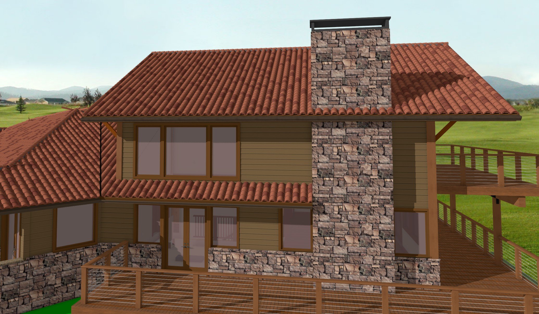

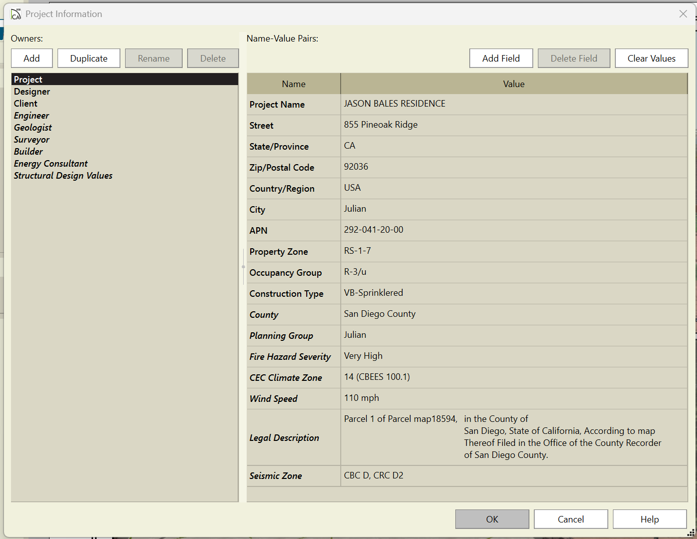

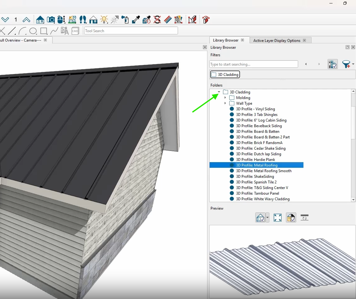

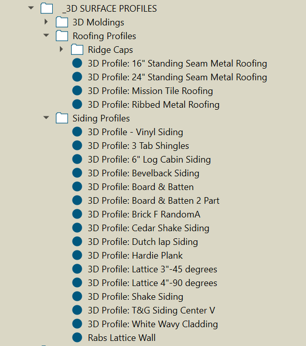

Joe_Carrick Posted Wednesday at 07:00 PM Share Posted Wednesday at 07:00 PM (edited) X18 has some great new features. Here are my favorites: Project Information. Project Designer Client Custom - additional consultants, etc 3D Profiles User defined to add to Walls, Roofs, etc 2D Moldings - Board & Batt, Standing Seam Roofing, etc Lots of options using 2D Molding Profiles 3D Moldings - Mission Tile Roofing, Shingles, Shakes, etc Note that profiles should be as simple as possible to avoid redraw slowdown and file bloat. Don't attempt to create either 2D or 3D profiles with extreme accuracy. Fewer surfaces will provide better performance while still enhancing the 3D rendering. Room Labels with controls for what is displayed for various view types Wall Intersection editing & Wall Layer Fills Corner Board "Recessed to Sheathing Layer" option Replace Identical Objects in Plan (from Library) Numerous Framing and Truss improvements Schedules (Include from Floors options - much more flexibility) Edited Sunday at 06:53 PM by Joe_Carrick 2 1 Link to comment Share on other sites More sharing options...

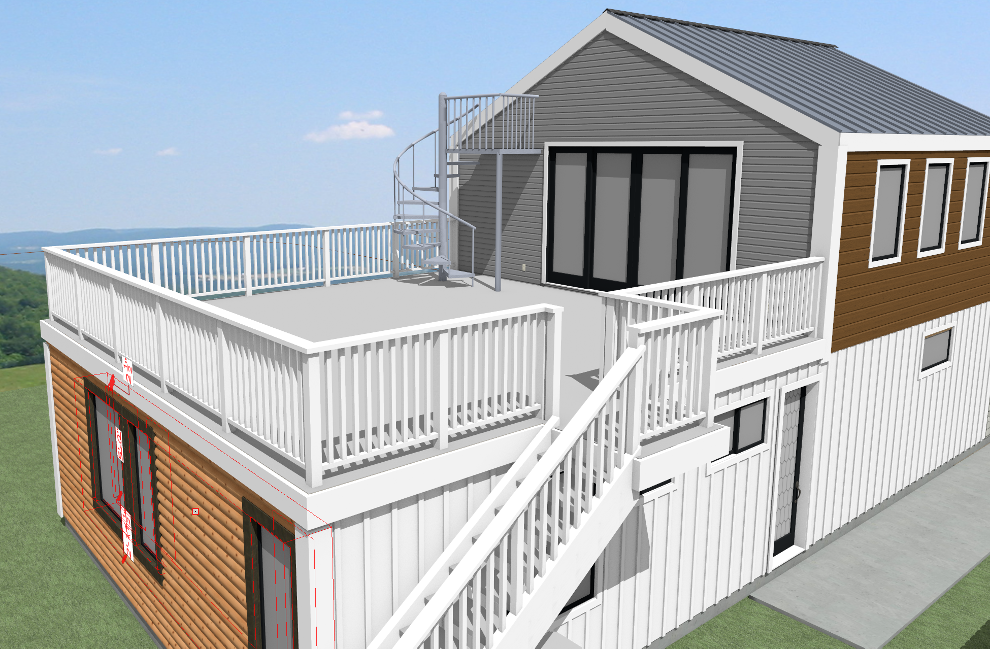

amddrafting Posted Wednesday at 07:24 PM Share Posted Wednesday at 07:24 PM I'm liking a lot of the same, for me I've seen a significant performance increase on my nearly 4 year old laptop. I used to get a lot of hesitation / lag after individual movements, opening section views and 3D views could take 30 seconds to a minute to render. I haven't noticed any of that. 2 Link to comment Share on other sites More sharing options...

mthd97 Posted Thursday at 07:49 AM Share Posted Thursday at 07:49 AM (edited) 13 hours ago, Joe_Carrick said: X18 has some great new features. Here are my favorites: Project Information. Project Designer Client Custom - additional consultants, etc 3D Profiles User defined to add to Walls, Roofs, etc 2D Moldings - Board & Batt, Standing Seam Roofing, etc 3D Moldings - Mission Tile Roofing, Shingles, Shakes, etc Room Labels with controls for what is displayed for various view types Wall Intersection editing & Wall Layer Fills Corner Board "Recessed to Sheathing Layer" option Replace Identical Objects in Plan (from Library) Numerous Framing and Truss improvements Schedules (Include from Floors options - much more flexibility) Hey Joe, yes X18 is definitely a big step in the right direction particularly with 3D cladding. How would you show a 3D flashing around the chimney at present ? A 3d molding polyline around the perimeter most likely. I would need 4 segments to do this, one at the back and one at the front and the two sloping sides. I am hoping for an automated method to do this with CA in the future. If CA could read the line between the roof and the chimney and automatically place a molding around it, that would be excellent. I haven’t used CA for a while but I am interested to know how it is done efficiently at present. Thank you for your list above. Edited Thursday at 08:03 AM by mthd97 Link to comment Share on other sites More sharing options...

Joe_Carrick Posted Thursday at 10:15 PM Author Share Posted Thursday at 10:15 PM (edited) 14 hours ago, mthd97 said: How would you show a 3D flashing around the chimney at present ? A 3d molding polyline around the perimeter most likely. I would need 4 segments to do this, one at the back and one at the front and the two sloping sides. I would actually need 5 since there's a cricket at the back. Some things are not that big a deal but it would be a nice feature if CA made flashing at vertical surface intersections with roof planes automatic similar to shadow boards. Another option could be a material region. They can be either recessed or not depending on the vertical surface. Recessed for Siding Flush for Concrete or Masonry After some experimenting I prefer the "Wall Material Region" because it seems to be much easier to adjust.and it sticks to the wall nicely. Edited Thursday at 10:47 PM by Joe_Carrick 1 Link to comment Share on other sites More sharing options...
mthd97 Posted Friday at 02:02 AM Share Posted Friday at 02:02 AM 3 hours ago, Joe_Carrick said: I would actually need 5 since there's a cricket at the back. Some things are not that big a deal but it would be a nice feature if CA made flashing at vertical surface intersections with roof planes automatic similar to shadow boards. Another option could be a material region. They can be either recessed or not depending on the vertical surface. Recessed for Siding Flush for Concrete or Masonry After some experimenting I prefer the "Wall Material Region" because it seems to be much easier to adjust.and it sticks to the wall nicely. A great tip for me to use a “Wall Material Region” for now to apply a flashing around a protrusion. That way I wouldn’t need to create individual flashing segments that may not join correctly either. I have seen a suggestion for automatic flashings and I hope it gets implemented somewhere down the track. I am however quite impressed with the 3D modeling improvements in X18 so far. I also like how an angled wall junction can be squared off too. Link to comment Share on other sites More sharing options...

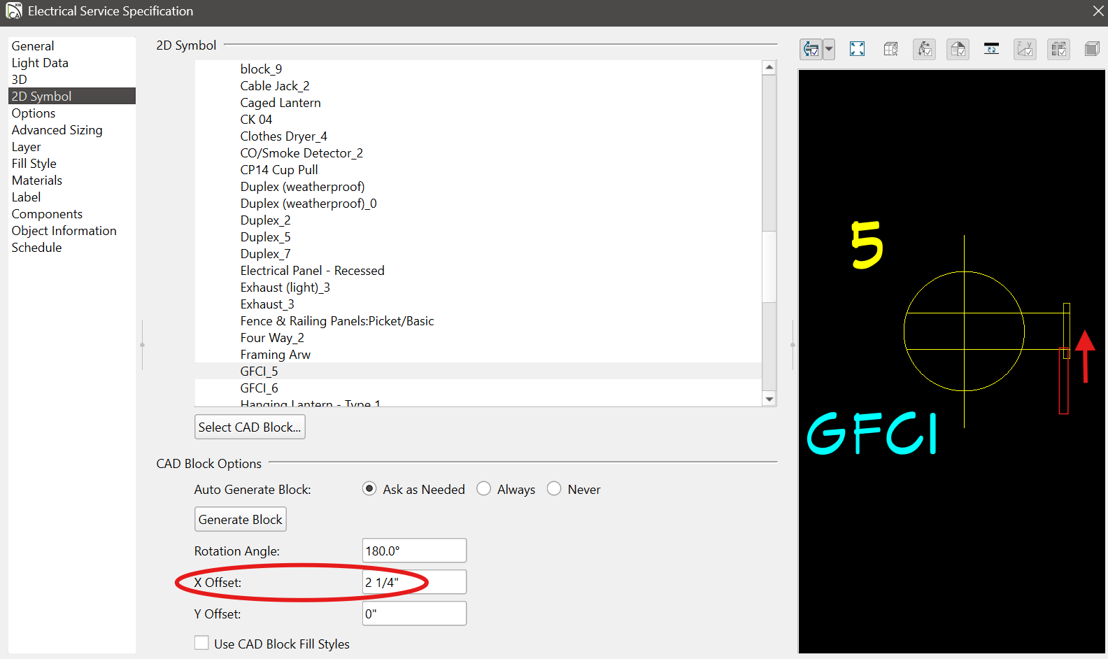

KilianDrafting Posted 4 hours ago Share Posted 4 hours ago Ability to adjust custom 2d symbols to display at center of 3d electrical objects! I don't think we had this before 1 Link to comment Share on other sites More sharing options...
