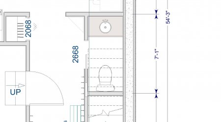

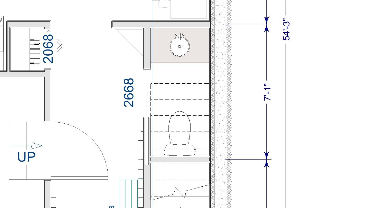

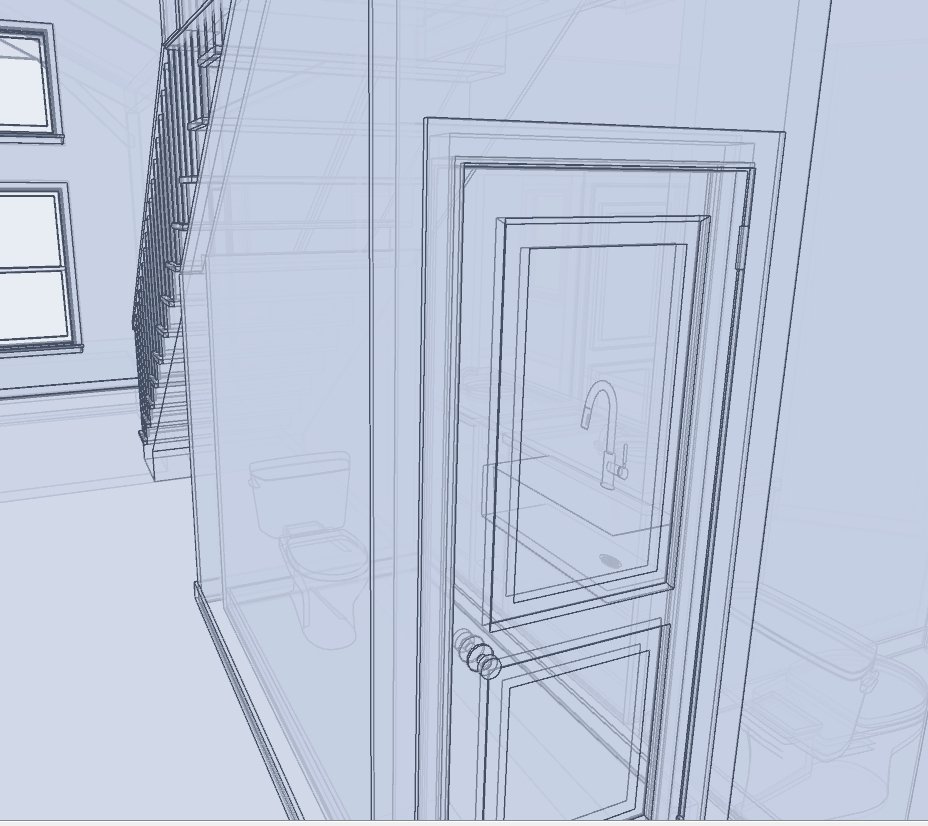

madcowscarnival Posted Thursday at 06:02 PM Share Posted Thursday at 06:02 PM Does anyone have a narrow wall sink that would be used in a 1/2 bath below stairs? There's ~40inches available width, offset toilet and door, trying to place a sink on the other wall but it's pretty skinny. The Owner doesn't care, he just wants and extra half-bath (already two full). Link to comment Share on other sites More sharing options...

madcowscarnival Posted Thursday at 06:21 PM Author Share Posted Thursday at 06:21 PM Stairs leading to a mezzanine, I'll be able to cantilever out floor joists above for a short section of flat ceiling. Have ~7'10 at 10.5" from leading edge of toilet. Link to comment Share on other sites More sharing options...
madcowscarnival Posted Thursday at 06:23 PM Author Share Posted Thursday at 06:23 PM Link to comment Share on other sites More sharing options...

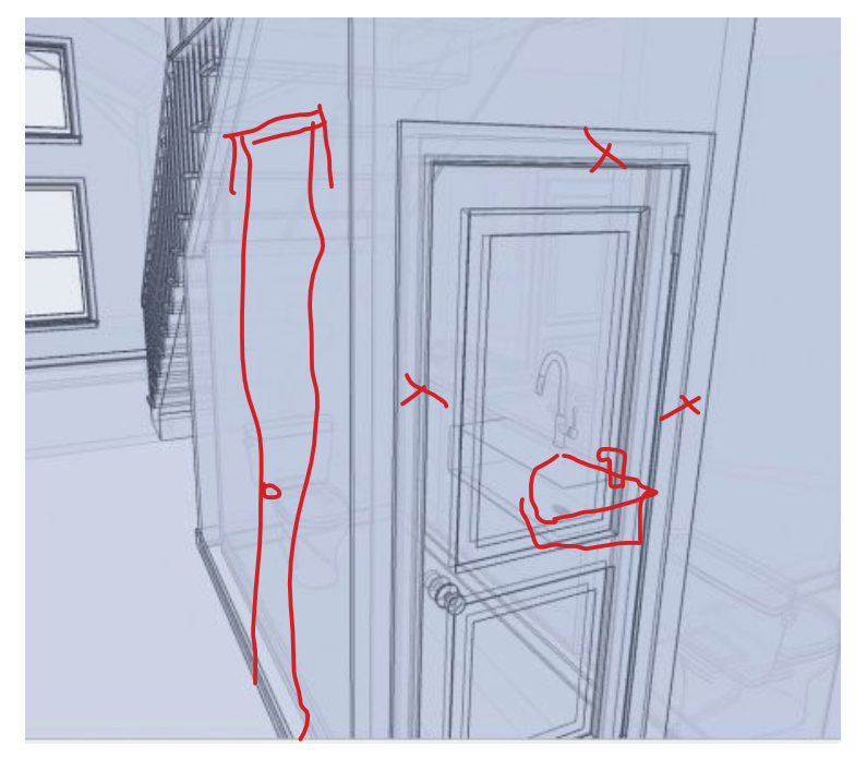

madcowscarnival Posted Thursday at 06:24 PM Author Share Posted Thursday at 06:24 PM I cheated and just "shrank" a wall sink, but don't know if a real world product exists. Link to comment Share on other sites More sharing options...
JKEdmo Posted Thursday at 06:55 PM Share Posted Thursday at 06:55 PM 29 minutes ago, madcowscarnival said: My first thought is flip door to other side and do a corner sink. Here's one available at Lowes. They are available and might help in this tight space. Link to comment Share on other sites More sharing options...
madcowscarnival Posted Thursday at 06:59 PM Author Share Posted Thursday at 06:59 PM Thank you for that idea. Hadn't even considered it. Link to comment Share on other sites More sharing options...

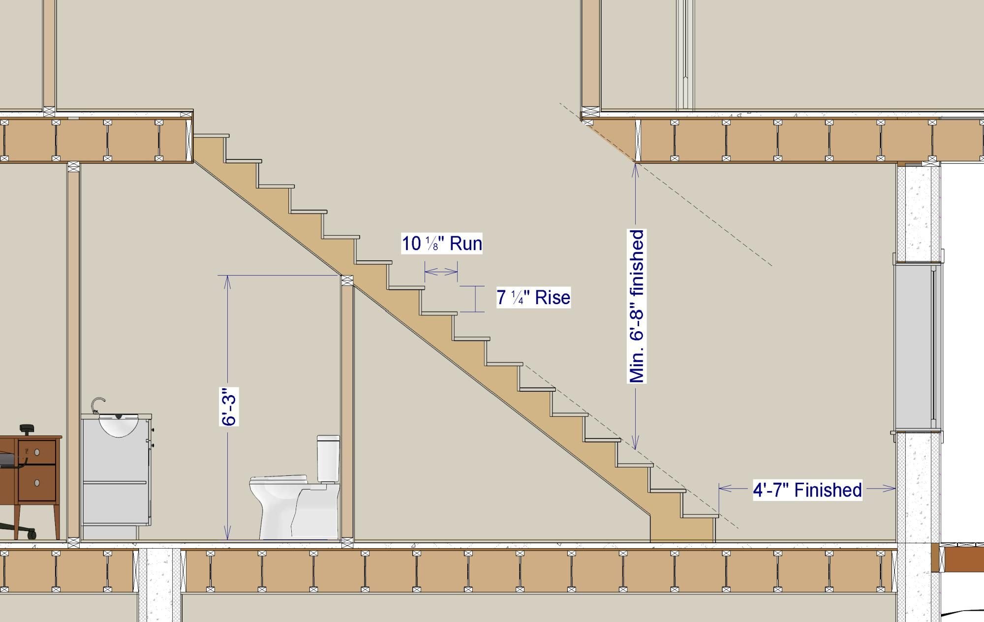

Alaskan_Son Posted Friday at 04:38 PM Share Posted Friday at 04:38 PM 21 hours ago, JKEdmo said: My first thought is flip door to other side and do a corner sink. Yeah, I agree. May not even need a corner sink. Depending on how much room there is, might even be able to use a pedestal sink or even a standard vanity cabinet. Here's a similar one we recently did... 1 Link to comment Share on other sites More sharing options...
