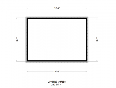

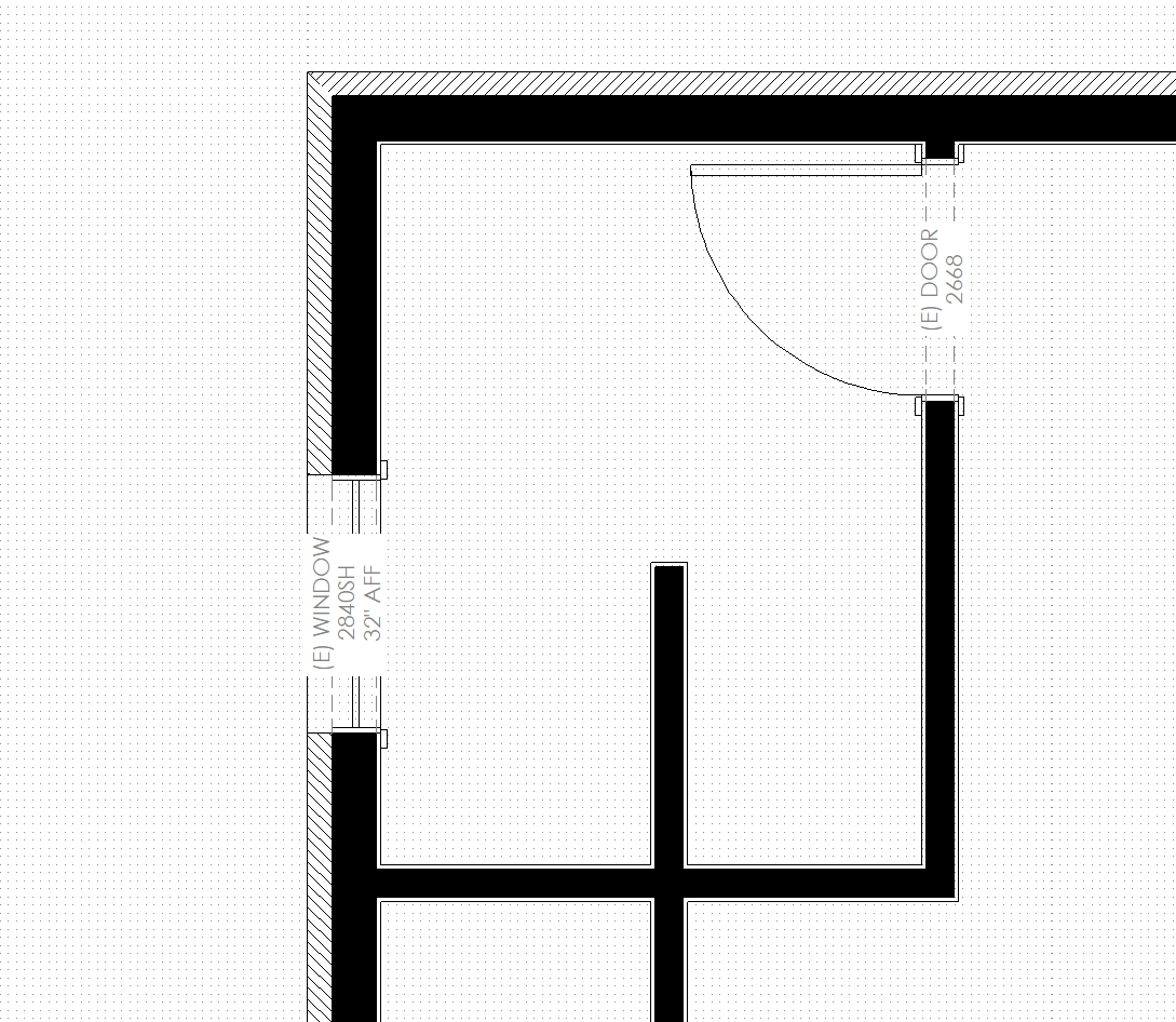

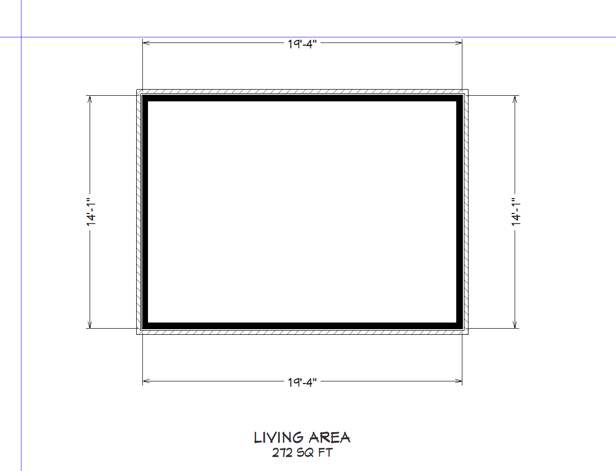

PitMan71 Posted 12 hours ago Share Posted 12 hours ago Anybody have any success with wall hatching for making a handout or presentation style floor plan? I have tried the wall hatching, but it covers the entire wall and I would prefer it only cover the main layer and let brick hatching be what it is. Not only that but it leaves gaps at 3 and 4 way intersections. It would be nice to have control over wall display and hatching in different views which help streamline things. I am also open to a better way to accomplish this. Im sure someone has encountered this before. Link to comment Share on other sites More sharing options...

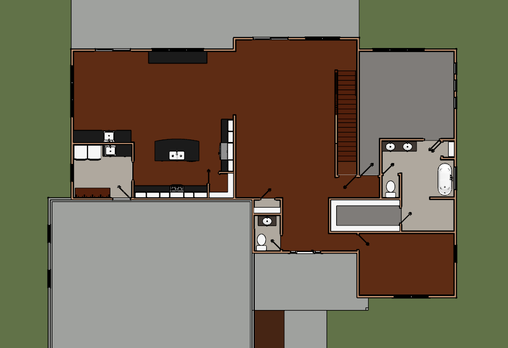

Chrisb222 Posted 11 hours ago Share Posted 11 hours ago 27 minutes ago, PitMan71 said: I am also open to a better way to accomplish this. You might play around with the method described here: https://www.chiefarchitect.com/support/article/KB-01142/creating-an-image-for-use-in-a-brochure-flyer-or-website.html It uses a Top View 3D Ortho to give you a "flyer" type of look to the design, then overlays the floor plan for annotations. I've also done something similar, but used the cross section slider to display doors and windows in the 3D Ortho view without having to overlay the floor plan. I like that look better, and then you could add a plan view with just the room names and dimensions, instead of the entire plan which doesn't always look right with the 3D ortho. 1 Link to comment Share on other sites More sharing options...
