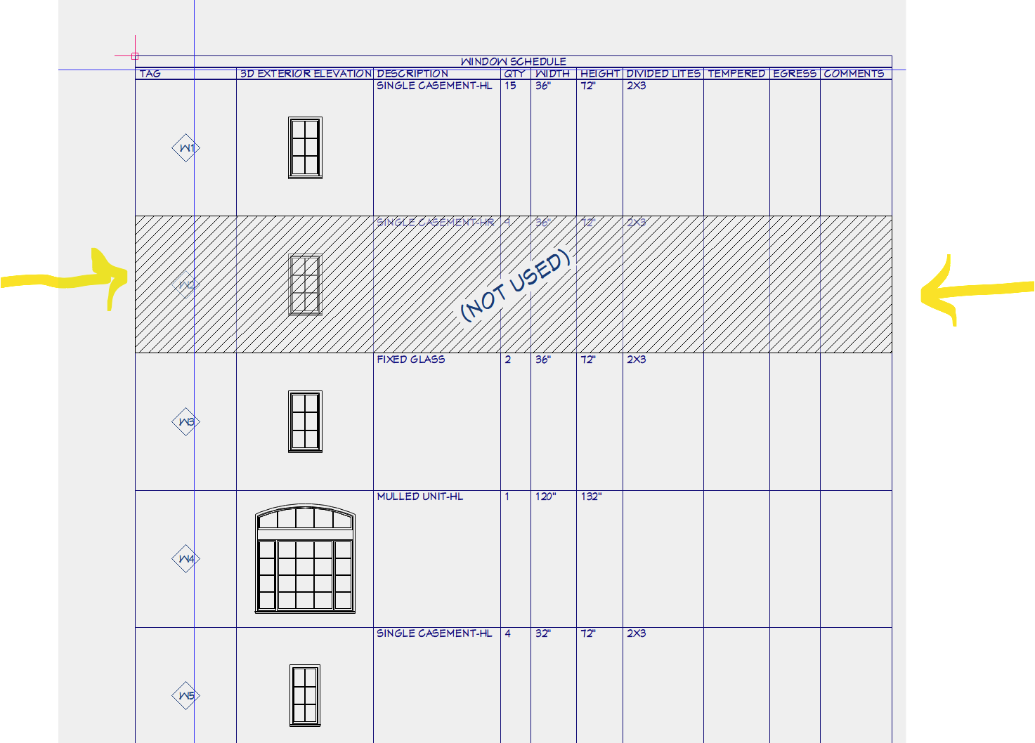

JKEdmo Posted February 19 Share Posted February 19 4 hours ago, wncbw7 said: Guys, Thanks for the answers, I didn't realize I could renumber by drag and drop. But here is my dilemma. Say I delete window W19, but I still want window W20 and the others after it to retain their original designation. When changes are made during the bidding process and I delete a window and they are renumber on my plans then the window quotes don't align with my plans. This reminds me of similar situation when I want to keep the numbering of plan keynotes / keynote schedule unchanged during the permit plan check process. There are times when I need to delete an item in the design. But, if the keynote goes away, so does it's corresponding entry in the note schedule. The solution I came up with was to keep the keynote and revise it's text to read "(Not used)." I then drag the keynote way off to the side of the floor plan and add a text reminder not to delete the note from the project. In this way I can keep the original keynote schedule row entry and the schedule from renumbering. Furthermore, it maintains a clear record of a deleted schedule item for the plan checker. So, I wonder if something similar can be done with a window. Don't delete the window but move it off to the side in a placeholder wall. Might be a way to define its properties so that it reads "not used" in the window schedule. But, I think an easier way is just do a strike out over its particular schedule row -- Here is a rectangular hatched polyline with label "not used" over the schedule row item: Bit of brainstorming / stream of consciousness session, but might work for you. Jim 1 Link to comment Share on other sites More sharing options...

wncbw7 Posted February 22 Author Share Posted February 22 JKEdmo, thanks for your suggestion, that does exactly what I needed. To the others, I am using X17. And when I delete a window it reorders the window labels above. Is there a setting I have missed that will tell it not to reorder the labels above the deleted window? Link to comment Share on other sites More sharing options...
