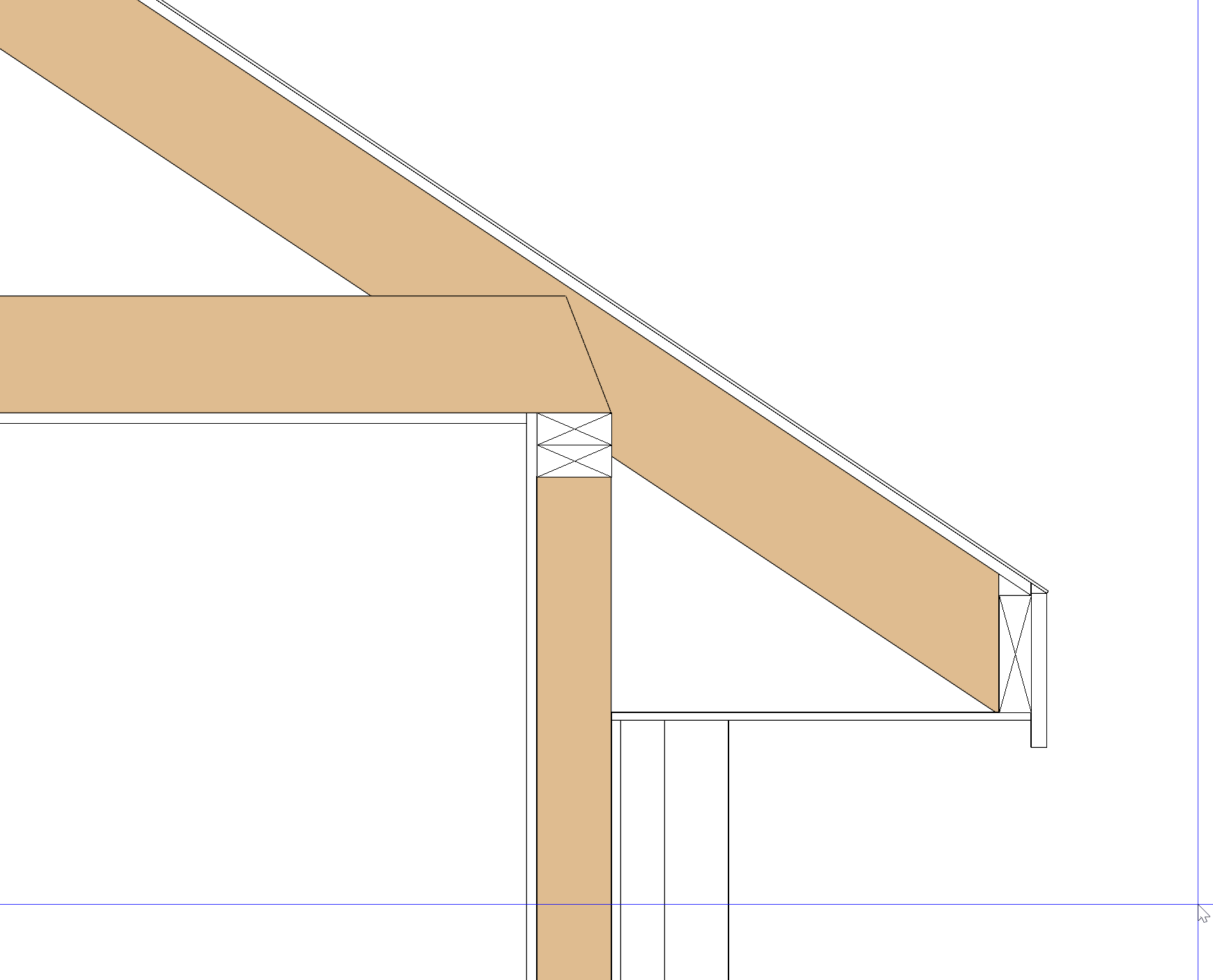

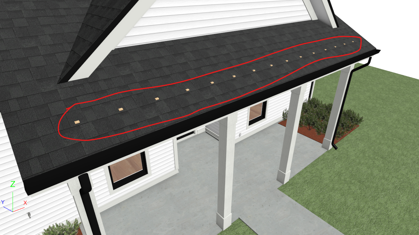

winterdd Posted December 31, 2025 Share Posted December 31, 2025 How do you guys taper joists when the program doesn't do it? See below and thanks! Link to comment Share on other sites More sharing options...

Gawdzira Posted December 31, 2025 Share Posted December 31, 2025 Possible situation is that your ceiling at the open porch area is set too high. Link to comment Share on other sites More sharing options...
PitMan71 Posted December 31, 2025 Share Posted December 31, 2025 2 hours ago, winterdd said: How do you guys taper joists when the program doesn't do it? See below and thanks! I had this come up a week or so ago. In a section view, drag the bottom of the joist more toward the roof and it should clip it. Also, there might need to be a railing wall or beam there for it to recognize that there is something to bear on. In my case, there was an exterior wall. I just drug the joist toward the roof and the system clipped it. You can always just turn off framing layer in that view AND you might be able to apply a profile to those ends if the above doesn't work. That ways my backup plan. Just remember you can only scarf cut a joist so much before its structural integrity is compromised. Link to comment Share on other sites More sharing options...
winterdd Posted December 31, 2025 Author Share Posted December 31, 2025 3 hours ago, Gawdzira said: Possible situation is that your ceiling at the open porch area is set too high. Nah, I wish it were that easy but it is 9' like the rest of the home. Thanks Link to comment Share on other sites More sharing options...

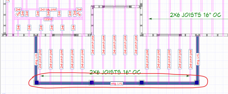

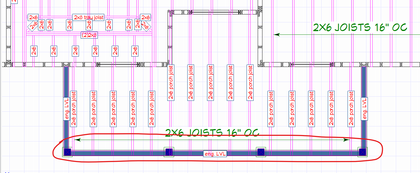

winterdd Posted December 31, 2025 Author Share Posted December 31, 2025 2 hours ago, PitMan71 said: I had this come up a week or so ago. In a section view, drag the bottom of the joist more toward the roof and it should clip it. Also, there might need to be a railing wall or beam there for it to recognize that there is something to bear on. In my case, there was an exterior wall. I just drug the joist toward the roof and the system clipped it. Yeah, for some reason this happens every now and then. I usually turn it off but really would like to have a solution. Below is how I framed it. Link to comment Share on other sites More sharing options...

winterdd Posted January 1 Author Share Posted January 1 2 hours ago, MPDesign said: Happy New Year! Question-thoughts: Is your roof framing 2x6? Seat cut correct? Did you auto frame or manual ceiling framing? I auto frame it and then clean it up which includes me manual framing some areas. Framing is actually my favorite part of plans. Yes, those are 2x6's and other areas are tapered just not the porch for some reason. Link to comment Share on other sites More sharing options...
