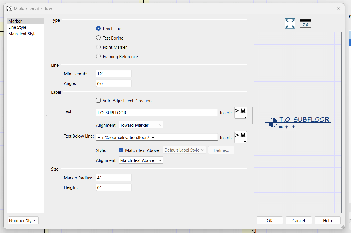

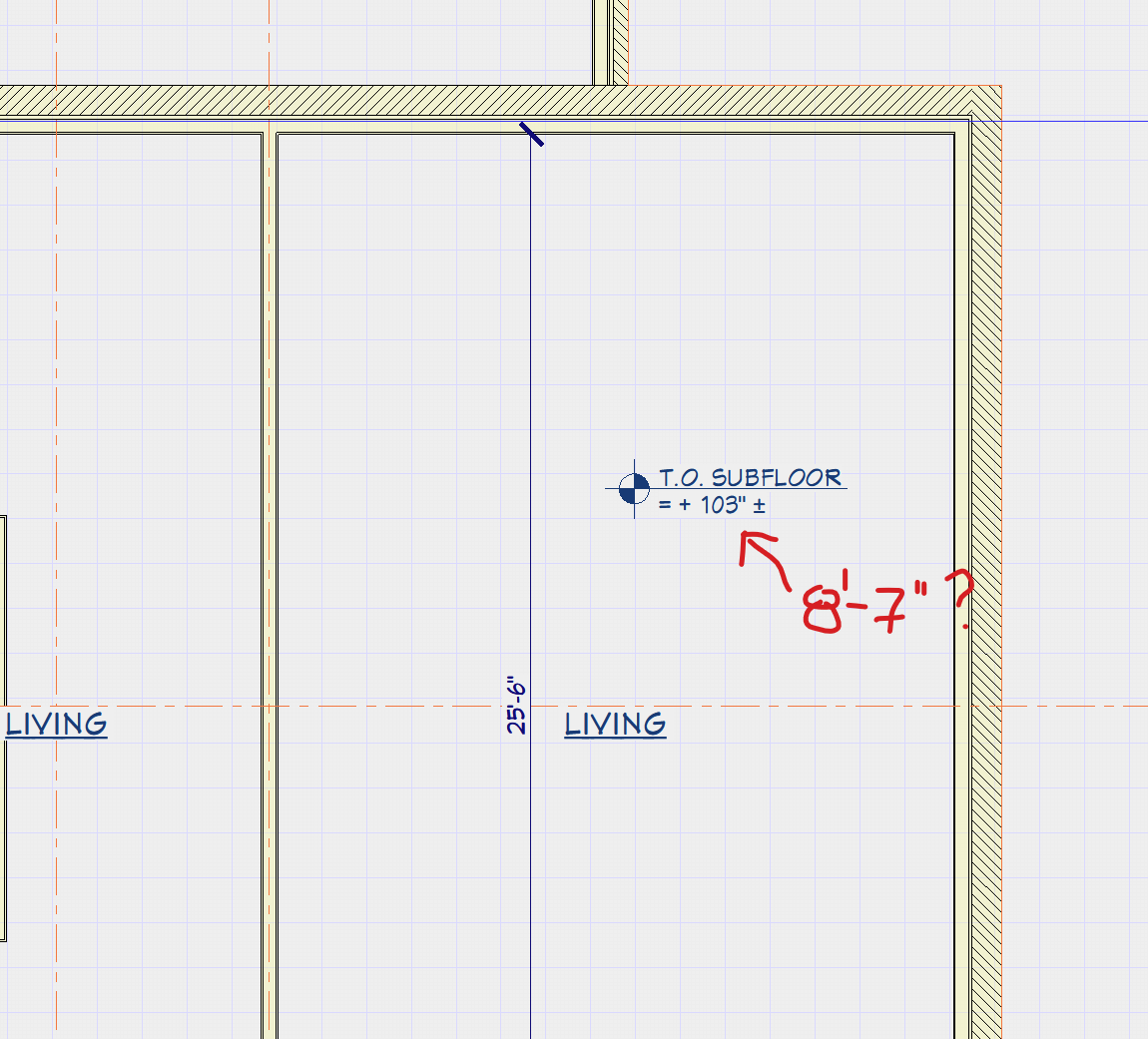

JKEdmo Posted July 16, 2025 Share Posted July 16, 2025 Good morning, I thought I'd get fancy (i.e. try to learn something new) and have my plan marker report back the room subfloor elevation instead of typing in manual text like I always do. Result: It reports back in inches. Anybody know how to get this to report back in feet + inches? You can point me to a forum thread or video if easier. Was not sure what key phrase to search for. Thanks in advance, Jim Link to comment Share on other sites More sharing options...

Solution DBCooper Posted July 17, 2025 Solution Share Posted July 17, 2025 Try using this built in macro instead: %room.floor_elevation.to_s("'-\"")% Link to comment Share on other sites More sharing options...

PitMan71 Posted July 17, 2025 Share Posted July 17, 2025 1 hour ago, DBCooper said: Try using this built in macro instead: That's a way shorter version..... It worked for me. inches are in decimal format though. Link to comment Share on other sites More sharing options...
JKEdmo Posted July 17, 2025 Author Share Posted July 17, 2025 1 hour ago, DBCooper said: Try using this built in macro instead: %room.floor_elevation.to_s("'-\"")% Thanks. It worked! Link to comment Share on other sites More sharing options...
