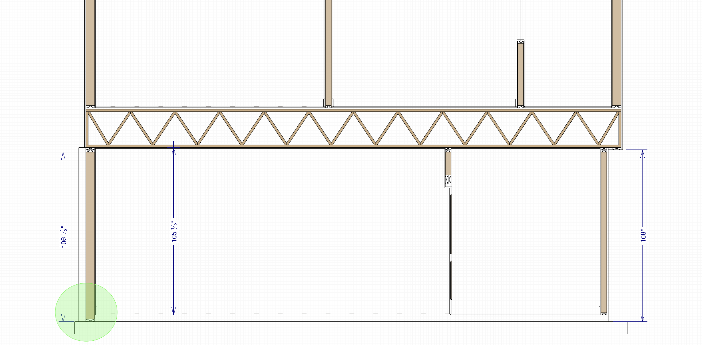

DefinedDesign Posted April 6 Share Posted April 6 On 3/21/2025 at 7:16 PM, Alaskan_Son said: Hi Michael, I have this exact walkout basement, what is your secret for getting the framed wall to sit on top of the slab? Right now mine is doing this: Link to comment Share on other sites More sharing options...

Alaskan_Son Posted April 6 Share Posted April 6 (edited) 1 hour ago, DefinedDesign said: Hi Michael, I have this exact walkout basement, what is your secret for getting the framed wall to sit on top of the slab? Right now mine is doing this: Not sure what you have going on there because I haven't seen the plan, but the slab should build through to the exterior as long as the main layer is framing. If you're using a pony wall with concrete on the lower half that's been dragged all the way down then you'll get what you're showing because Chief is holding the slab inside that concrete wall (even though you've pulled it down). Doing what Rene shows should force the desired behavior for even a pony wall though. Edited April 6 by Alaskan_Son Link to comment Share on other sites More sharing options...

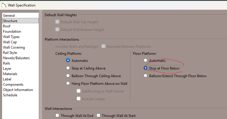

DefinedDesign Posted April 7 Share Posted April 7 Thanks @Renerabbitt, I checked my wall settings and “Stop at Floor Below” is enabled. I appreciate you sharing the video, but I’m unable to get it to play. Thanks @Alaskan_Son, for context, the wall was originally created as a concrete stem wall when the basement was auto generated from the first floor. I then added the floor trusses, converted the walkout stem wall to a framed wall with brick on the exterior, and rebuilt the framing. Link to comment Share on other sites More sharing options...
Alaskan_Son Posted April 7 Share Posted April 7 5 hours ago, DefinedDesign said: Thanks @Alaskan_Son, for context, the wall was originally created as a concrete stem wall when the basement was auto generated from the first floor. I then added the floor trusses, converted the walkout stem wall to a framed wall with brick on the exterior, and rebuilt the framing. You probably need to post the plan. Too many variables. Link to comment Share on other sites More sharing options...

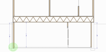

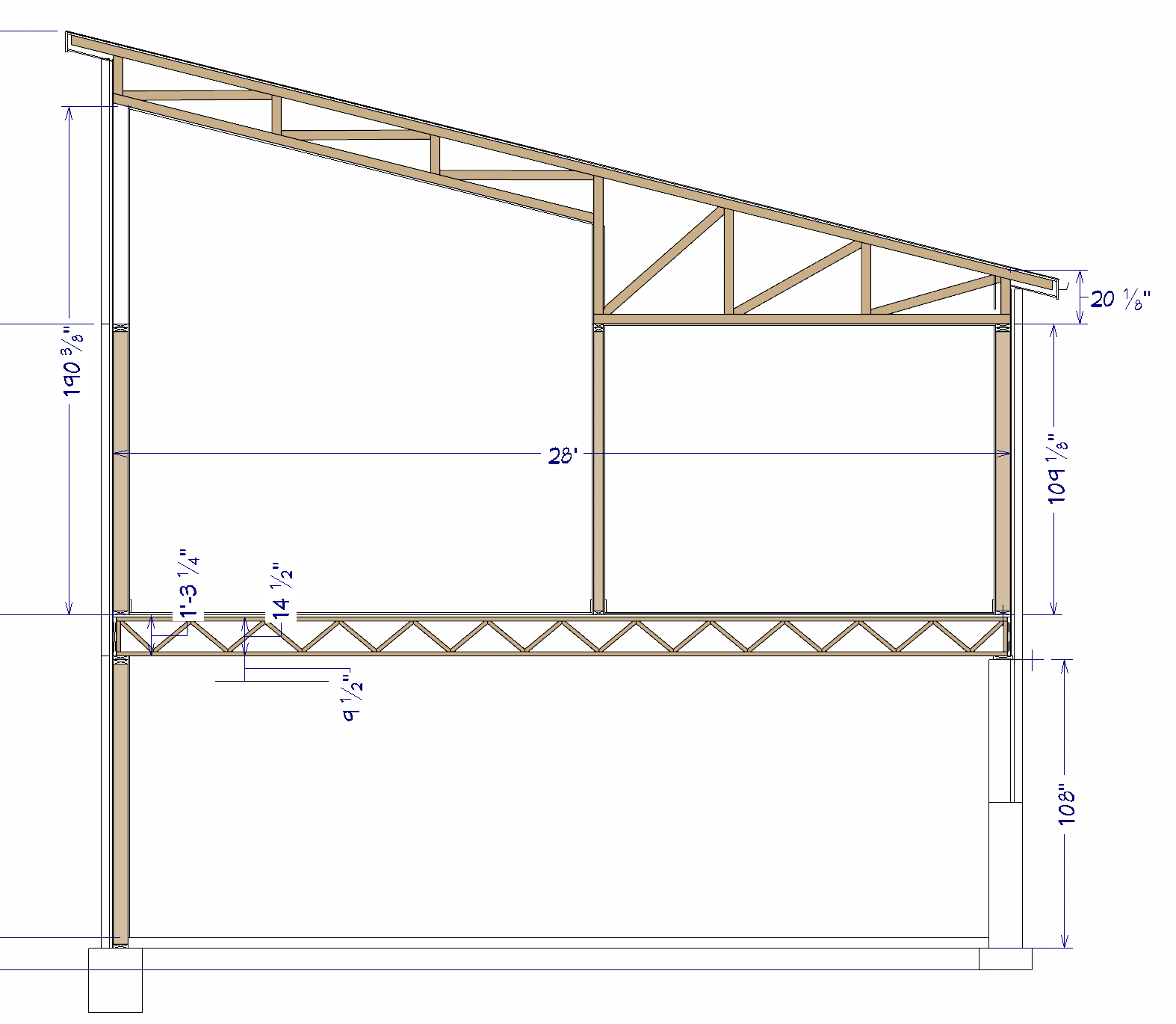

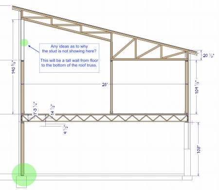

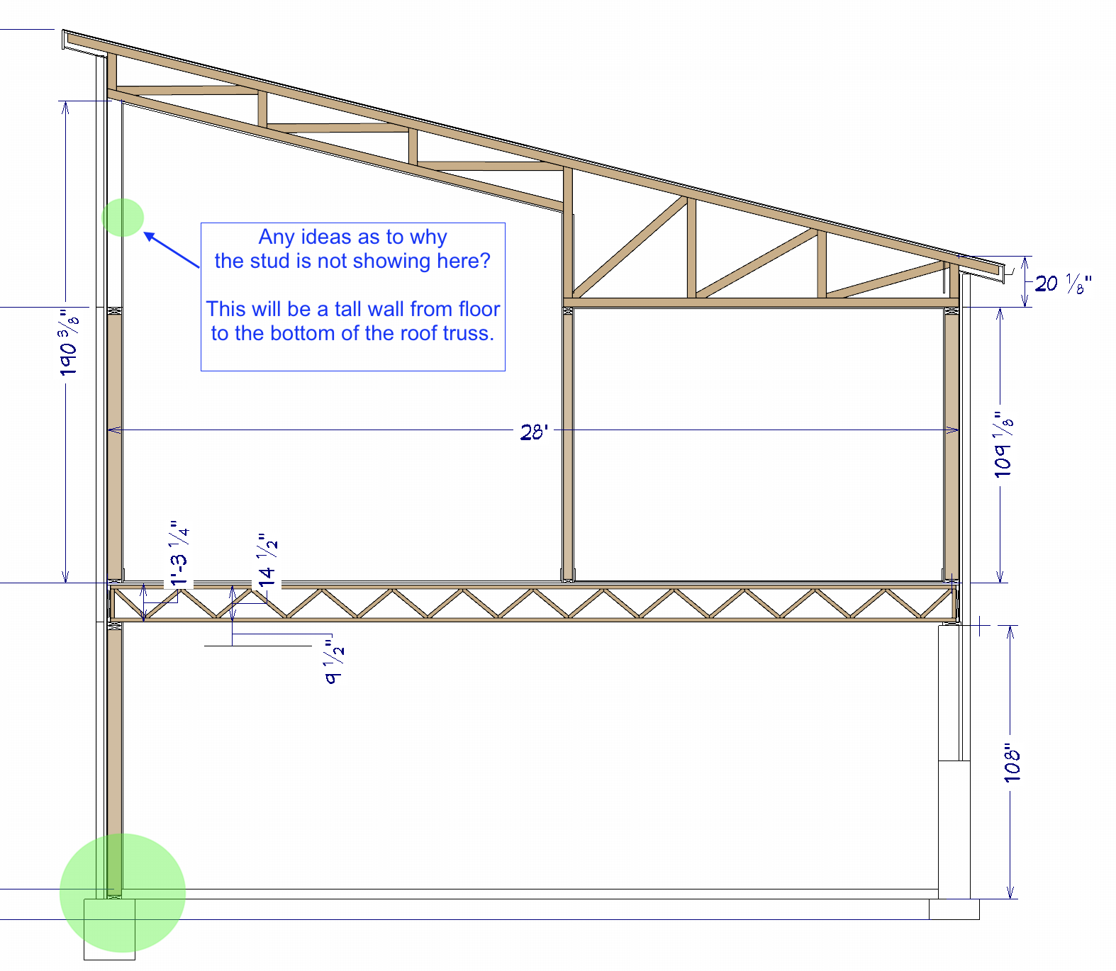

DefinedDesign Posted yesterday at 02:29 AM Share Posted yesterday at 02:29 AM On 4/6/2026 at 6:46 PM, Renerabbitt said: also see video Hi @Renerabbitt I was able to watch your video in another browser. Thank you so much. I scrapped my other plan and started over, following your suggestions. I set the walkout wall to “Stop at Floor Below,” created the two breaks on the east and west walls, and removed the pony wall. However, when I follow the steps to check and uncheck the monolithic slab, I am not getting the same results. Here is before Checking monolithic slab: Here is what I get after checking and unchecking monolithic slab: If you or @Alaskan_Son would like to investigate the plan and possibly point out what I might be missing, I would appreciate it. In addition to the issue above, I am also having a problem with the tall wall not extending to the underside of the roof truss. Grateful for any feedback. Redraw Bplan.zip Link to comment Share on other sites More sharing options...
