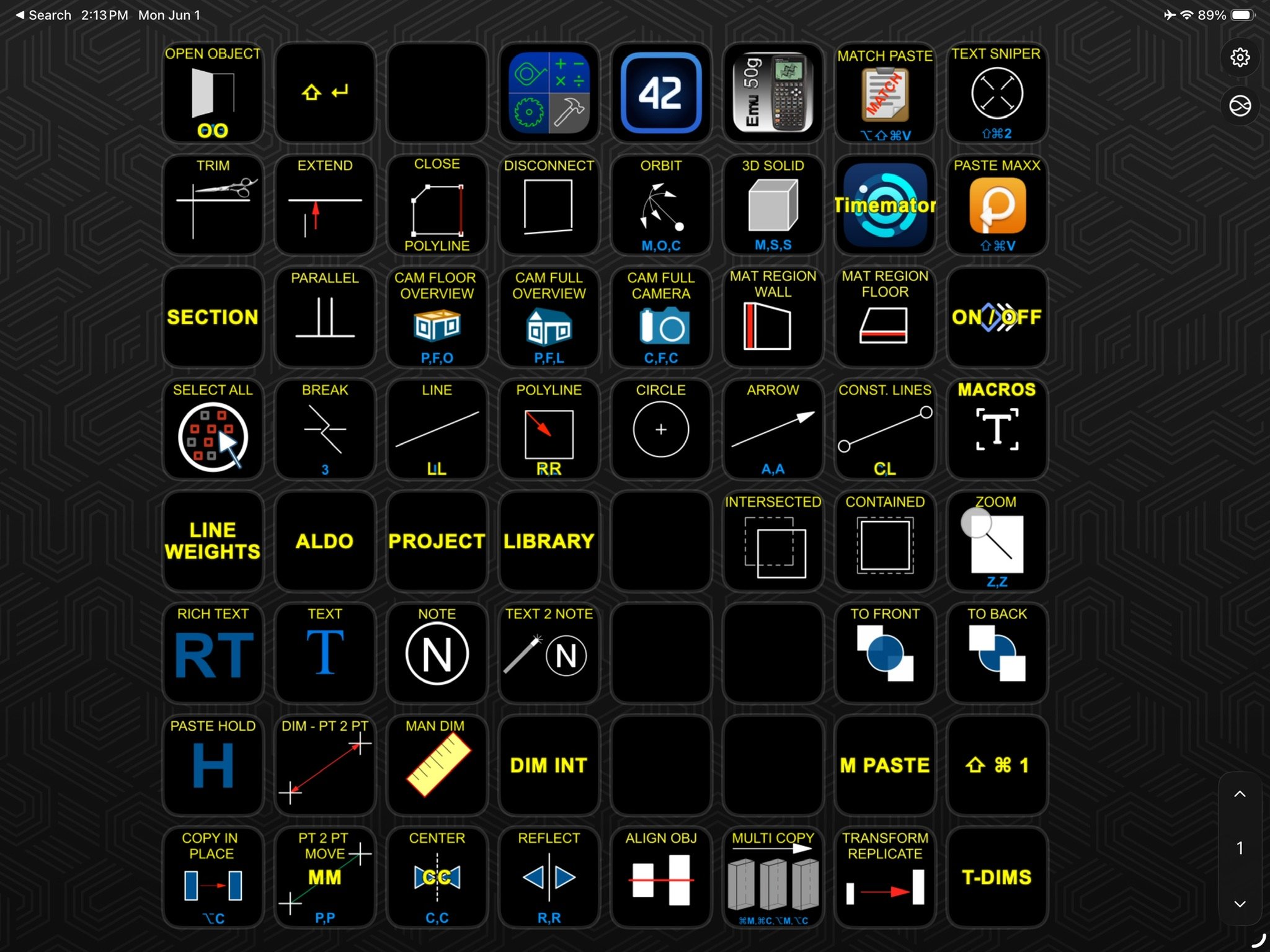

QualicoreHomes Posted November 11, 2022 Share Posted November 11, 2022 With this system, are your still pressing 2 or 3 buttons to go from one action to another? For example; If I'm on the "main" screen and I want to draw an exterior wall it be one button to go to walls and then one more to select which type of wall. Then if I want to draw a door in that wall I would have push the back button to go to the main screen, the opening button and then the type of door, so that be 3. Do you find you are pushing a lot of buttons for one action? Are the hot keys not faster as I don't have to go back to the main screen etc? I would be sold if there was one big screen/device with all the commands that I need on there. Link to comment Share on other sites More sharing options...
Joe_Carrick Posted November 11, 2022 Author Share Posted November 11, 2022 1 minute ago, QualicoreHomes said: With this system, are your still pressing 2 or 3 buttons to go from one action to another? For example; If I'm on the "main" screen and I want to draw an exterior wall it be one button to go to walls and then one more to select which type of wall. Then if I want to draw a door in that wall I would have push the back button to go to the main screen, the opening button and then the type of door, so that be 3. Do you find you are pushing a lot of buttons for one action? Are the hot keys not faster as I don't have to go back to the main screen etc? I would be sold if there was one big screen/device with all the commands that I need on there. Your analysis of how the system works is correct. It's both unfortunate and fortunate that there isn't a Stream Deck with hundreds of buttons. More buttons would make a much larger unit and it would cost proportionally more The graphic buttons can process any place from 1 - 100 (or maybe more) in a single button press. Chief's Hotkeys can have 1-4 keystrokes (and if using Ctrl, Shift, Alt) there are even more than 4 Remembering complex Hotkeys is always a problem. Chief has the potential to have over 1000 Hotkeys - assuming you wanted to replace all the Toolbar icon mouse picks with Hotkey assignments. The StreamDeck buttons are much easier to see and understand than Toolbar icons. That's true even without Tooltips which can in fact be added. In the final analysis, Even with the "Back" button it's still a lot faster. I tend to draw all my Walls first, then Doors and Windows, etc. 1 Link to comment Share on other sites More sharing options...

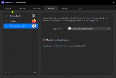

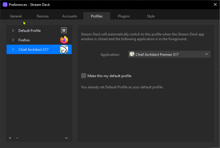

5FT-20Designs Posted November 13, 2022 Share Posted November 13, 2022 Nice setup Joe. I need to create default profile for all my programs; but it won’t be so extensive as yours. Chief is my default now. Link to comment Share on other sites More sharing options...
Joe_Carrick Posted November 13, 2022 Author Share Posted November 13, 2022 31 minutes ago, 5FT-20Designs said: Nice setup Joe. I need to create default profile for all my programs; but it won’t be so extensive as yours. Chief is my default now. Create a Default Profile that includes a button to launch each of your Apps. For Chief you can have a button that uses Hotkey "win+#" so that if you just make Chief the active App. I have Chief as the 4th App on my Taskbar so that button is Hotkey win+4 Link to comment Share on other sites More sharing options...

ComputerMaster86 Posted November 13 Share Posted November 13 On 11/6/2022 at 9:23 PM, Joe_Carrick said: Here's the latest view of my Stream Deck Setup. I've extensively modified the icons for the buttons to be as close to Chief's Toolbars as I could make them. is there a limit to how many nestled folders the steam deck can have? (A folder inside a folder inside a folder) Link to comment Share on other sites More sharing options...
Joe_Carrick Posted November 13 Author Share Posted November 13 (edited) 36 minutes ago, ComputerMaster86 said: is there a limit to how many nestled folders the steam deck can have? (A folder inside a folder inside a folder) I don't know what the limit is. You can have multiple "Profiles" with at least 10 "Pages" and each button can have 32 actions which depending on the action can have additional "Pages" or actions which include "Folders". So for practical purposes there's no limit. It's extremely flexible in how you set it up. My preference is to utilize multiple "Profiles" even within Chief. Edited November 13 by Joe_Carrick 1 Link to comment Share on other sites More sharing options...
