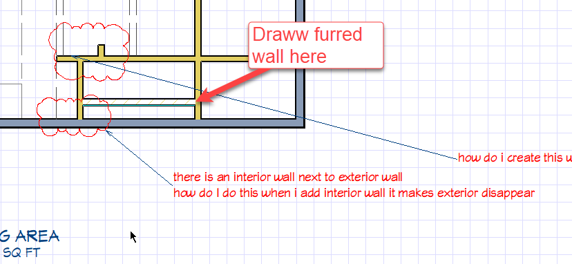

sthieldesign Posted September 9, 2016 Share Posted September 9, 2016 How do I change wall thicknesses? I have a picture posted to what I am referring to. I try and add walls and change thickness but the program won't let me. Does anyone have a trick to override this? Link to comment Share on other sites More sharing options...

sthieldesign Posted September 9, 2016 Author Share Posted September 9, 2016 Thank you, I understand that part but when walls change thickness when attached to each other. My attachment didn't post! Please take a look Link to comment Share on other sites More sharing options...
Gawdzira Posted September 9, 2016 Share Posted September 9, 2016 You will need to post a plan and annotate what you are trying to do. That image does not tell me enough. Link to comment Share on other sites More sharing options...
sthieldesign Posted September 9, 2016 Author Share Posted September 9, 2016 Ok thank you here is my file with notes REEVES GAME ROOM _CHIEF NOTES.plan Link to comment Share on other sites More sharing options...

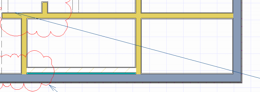

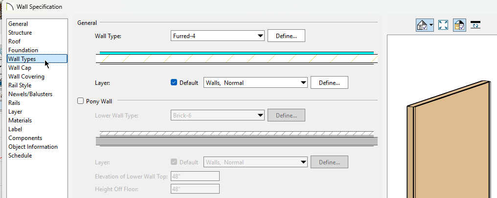

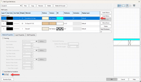

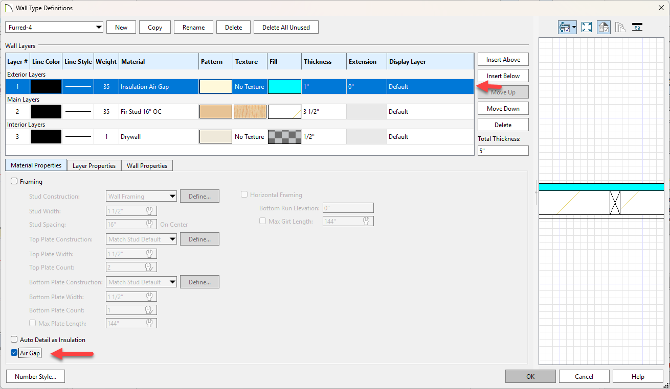

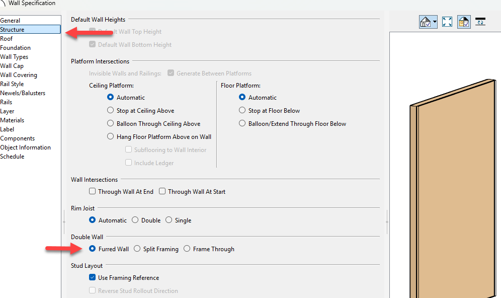

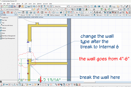

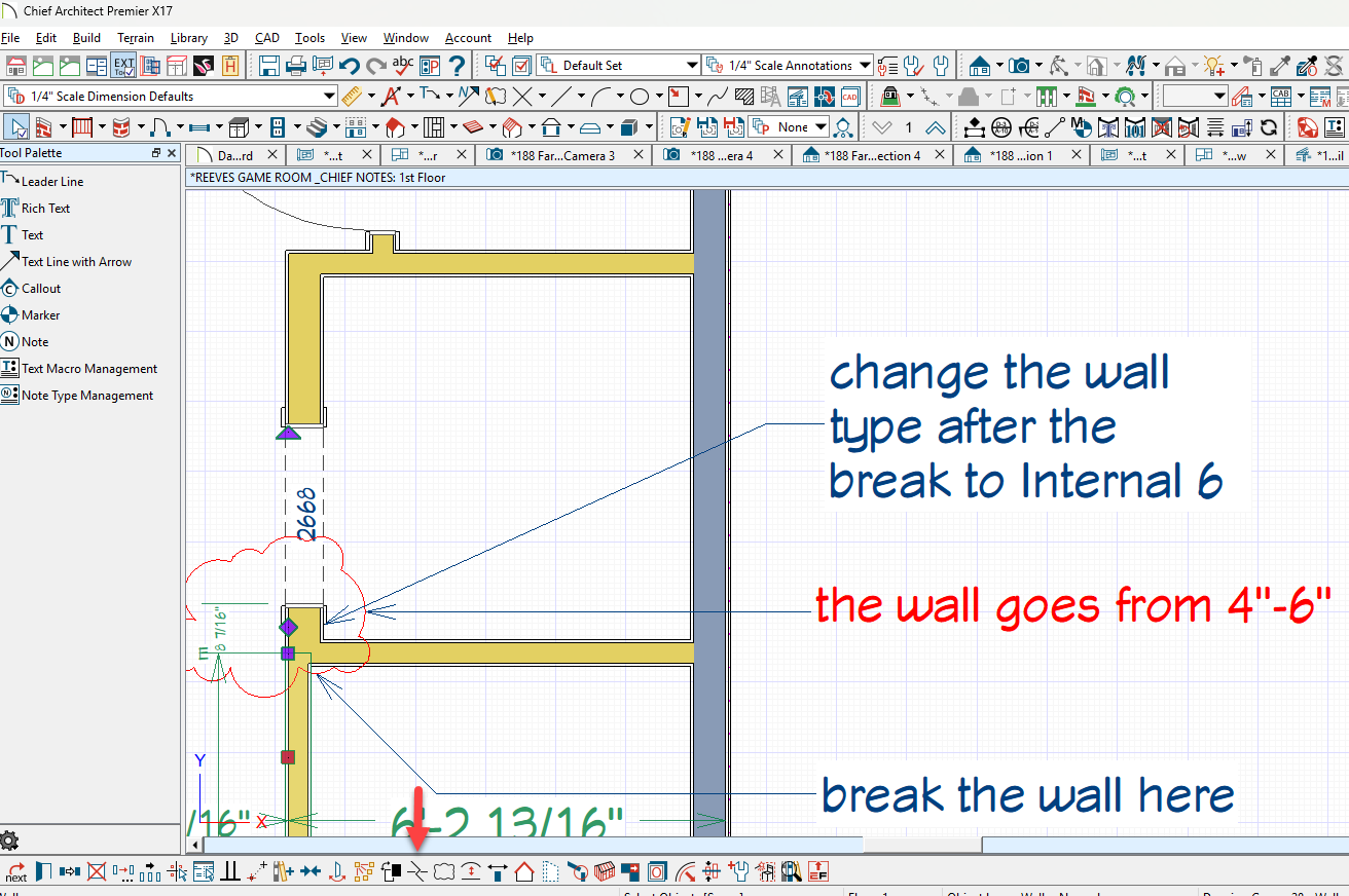

Doug_N Posted September 17, 2025 Share Posted September 17, 2025 On 9/9/2016 at 11:58 AM, sthieldesign said: Ok thank you here is my file with notes REEVES GAME ROOM _CHIEF NOTES.plan 3.67 MB · 324 downloads I noticed that you are running with CA X-14 and unfortunately that is no longer on my computer. Here are the steps to do what you are asking. To change the wall thickness 1 break the Internal 4" wall at the wall junction 2 select and change the wall type after the break to Internal 6 To make a wall that is against another wall 1 Create a new wall type called Furred 4" (you can use any name that is meaningful for you) 2 Delete the drywall layer that is going to be against the other wall 3 Add an air gap that separates the two walls (not necessary everywhere, but may be required by code in some jurisdictions) 4 Draw a section of the wall away from any other wall. 5 Change the structural setting from split framing to Furred 6 Move the wall against the exterior wall. This leaves the drywall in the interior of the external wall, but for most purposes that works for most drawings. Link to comment Share on other sites More sharing options...
