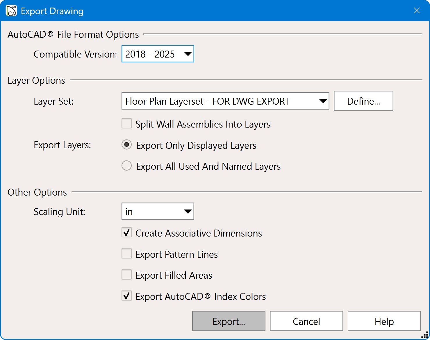

CharlesVolz Posted August 13 Share Posted August 13 (edited) Howdy Gene, Here is what I do. From my notes (no guarantees): Exporting DWG Files (Usually to Engineers): 1. In Plan, create and use the default set named “Floor Plan Defaultset - FOR DWG EXPORTS”, or something similar. a. Display layers that the engineer needs, like main wall layers only, roof planes, doors, windows, etc. b. Do not display layers that the engineer does not need. These are unnecessary items or items that will junk up a 2D ACAD plan like electrical, cabinets, landscaping (terrain item, roads, plants, etc.), architectural blocks, cars (vehicles), furniture (interior and exterior), fixtures (interior and exterior), dimensions, revision clouds, north arrows, etc. c. Turn off the dimensions - whoever's using it will use ACAD dims. 2. Export each floor level - Select File>Export>Export Current View (DWG, DXF)... and continue to the DBX choices below. 3. Export all floor levels - Select File>Export>Export All Floors (DWG, DXF)... and continue to the DBX choices below. 4. DBX Choices. In the Export Drawing dialog box, you have important choices: a. Compatible Version. i. Make sure you select a version that the architect can import, i.e., what version/flavor of AutoDesk software they are using. You can normally just select an older version to be safe. b. Layer Options. i. Select the Layer Set you've tweaked to display what you want to export (this was step 1). ii. DO NOT select Split Wall Assemblies Into Layers. This option creates an unholy mess for the CAD operator. iii. Select Export Only Displayed Layers. c. Other Options. i. Scaling Unit should be inches for sharing with an architect. ii. Select Create Associative Dimensions. iii. DO NOT select Export Pattern Lines. This is another unholy mess. iv. DO NOT select Export Filled Areas. Yet another mess. v. Select Export AutoCAD Index Colors. vi. Click on Export, etc. Notes: 1. Always send them a PDF of the plan (layout) so they can understand the design. 2. You can ask the engineers what layer sets they want and what AutoCAD version they use or need compatibility with. 3. You can open the DWG file in Chief Architect to check it, turn off layers and re-save. Best, Charles Edited August 14 by CharlesVolz 1 Link to comment Share on other sites More sharing options...
