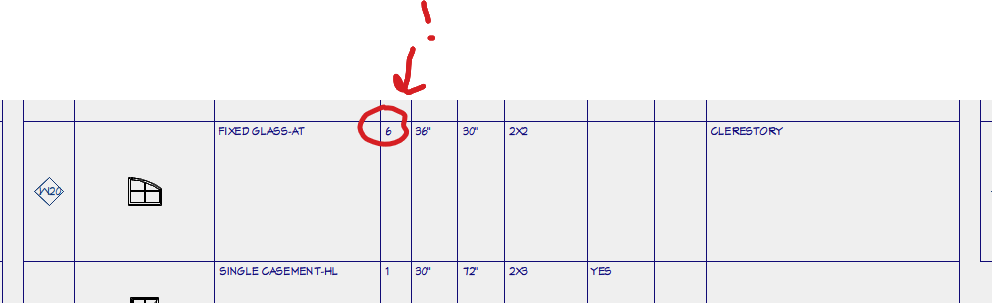

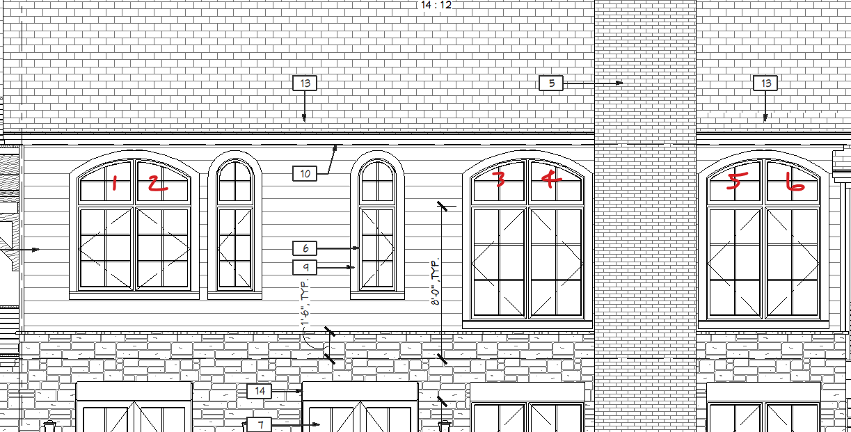

I have 6 fixed broken-arched clerestory windows (1-6 shown below):
These should schedule out as 2 types (left vs right arch) with quantity 3 each.  Yet, my window schedule shows them all as 1 type, quantity 6.  Chief seems them all as one type and does not recognize the mirrored window type.
How do I fix this scheduling error?

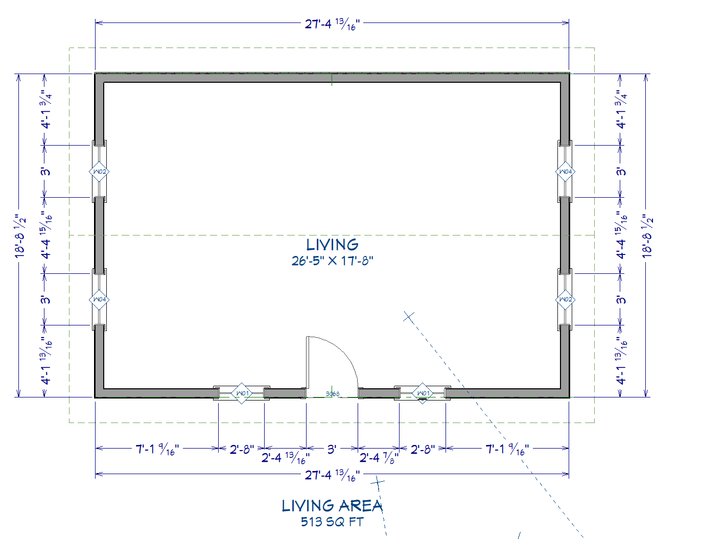

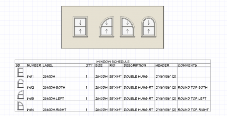

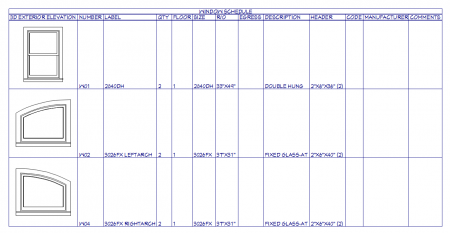

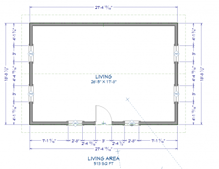

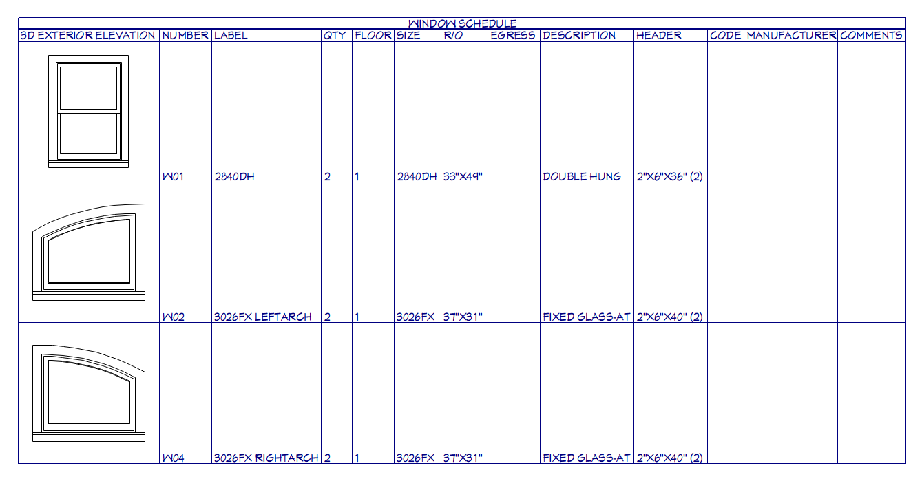

Hi Jim,

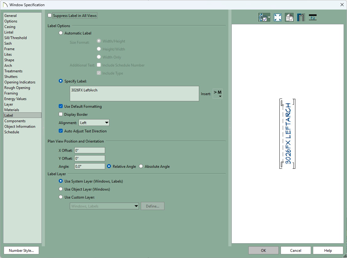

I was looking at this and found if you specify the label and add the text "LeftArch" and "RightArch" it seperates it correctly in the window schedule
image.thumb.png.e06aff44a1424a314500a2c1441bcd65.pngimage.thumb.png.d36398f7b819d38408d9999c45dbc284.pngimage.thumb.png.93c90dc7c79ad9191bcf3e271d6c1362.png

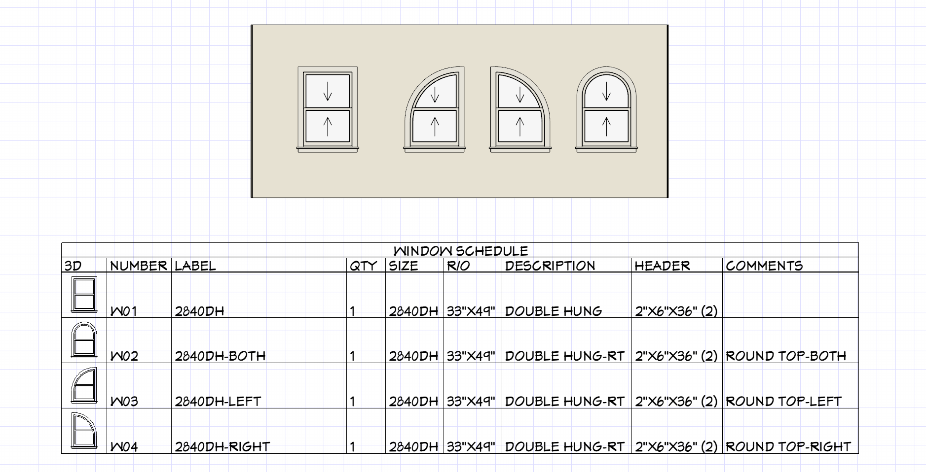

I don't think it's actually a bug because this is the way schedules have always worked in Chief.  Chief will group objects together just based on the text displayed in the schedule.  It ignores what the objects might actually look like.  So if you want your windows to be separate rows in the schedule, you have to add something to the schedule to make them different.
Michael's solution is easy and will work but you could make it more automatic by changing your labels to use the built in macros "%automatic_label%-%arch_side%" or by adding some info to the OIP comments such as "%arch_type_name%-%arch_side%".
  • Upvote 3
Link to comment
Share on other sites
Thanks for the insight.  Your explanation of how Chief schedules things based on text only really explains this scheduling behavior.
