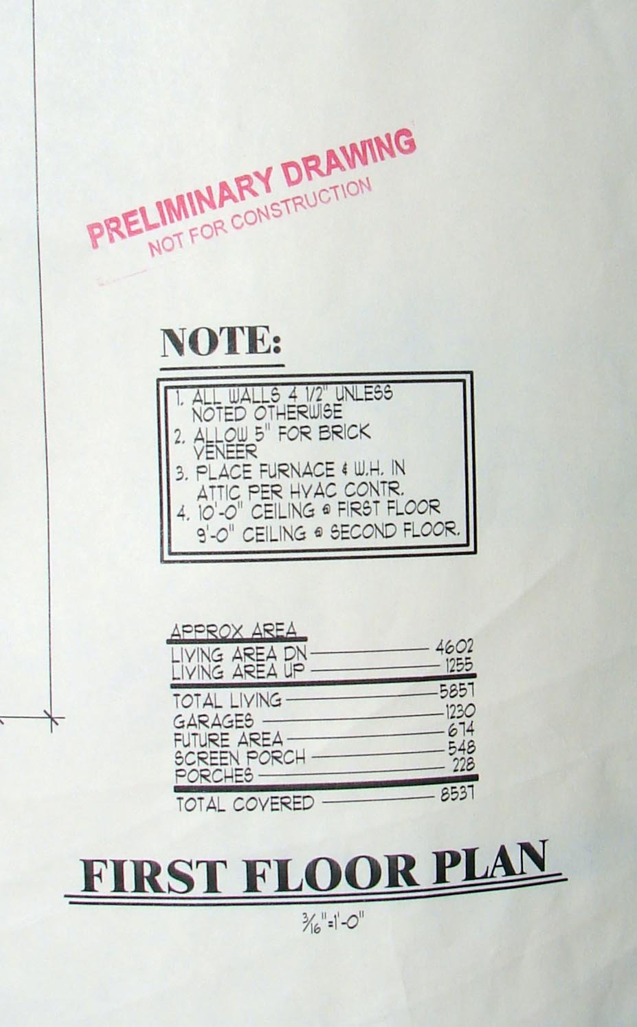

para-CAD Posted February 18 Share Posted February 18 (edited) So back in 1989 through 1995 I exclusively framed houses within 150 miles of Houston Texas. Every single set of plans had a small text box on the very first page, cover sheet that had heated space first floor heated space second floor those two numbers added together and then all the unheated space listed as garage, covered porch and the like. We being lazy framers were caught up in the dollar per square foot game and we were able to look at the very first page and run a quick calculation from those numbers to let the builder know what it would cost for us to frame it. This was when I was a helper and this is how I saw it done. As I moved on and ran my own show I started to study the plans from the roof down to the foundation and I was able to see where the choke points were and add additional pricing to cover the time. I was no longer a flat rate dollar per square foot Framer. If they were putting these kinds of numbers on the cover sheet back then, there’s no excuse for that not to be automated and available without having to buy a macro from someone. I respect and admire the guys that can write macros but some of this stuff should be default in chief itself. I dictated this without proofreading so there may be some confusion Edited February 19 by para-CAD 1 1 Link to comment Share on other sites More sharing options...

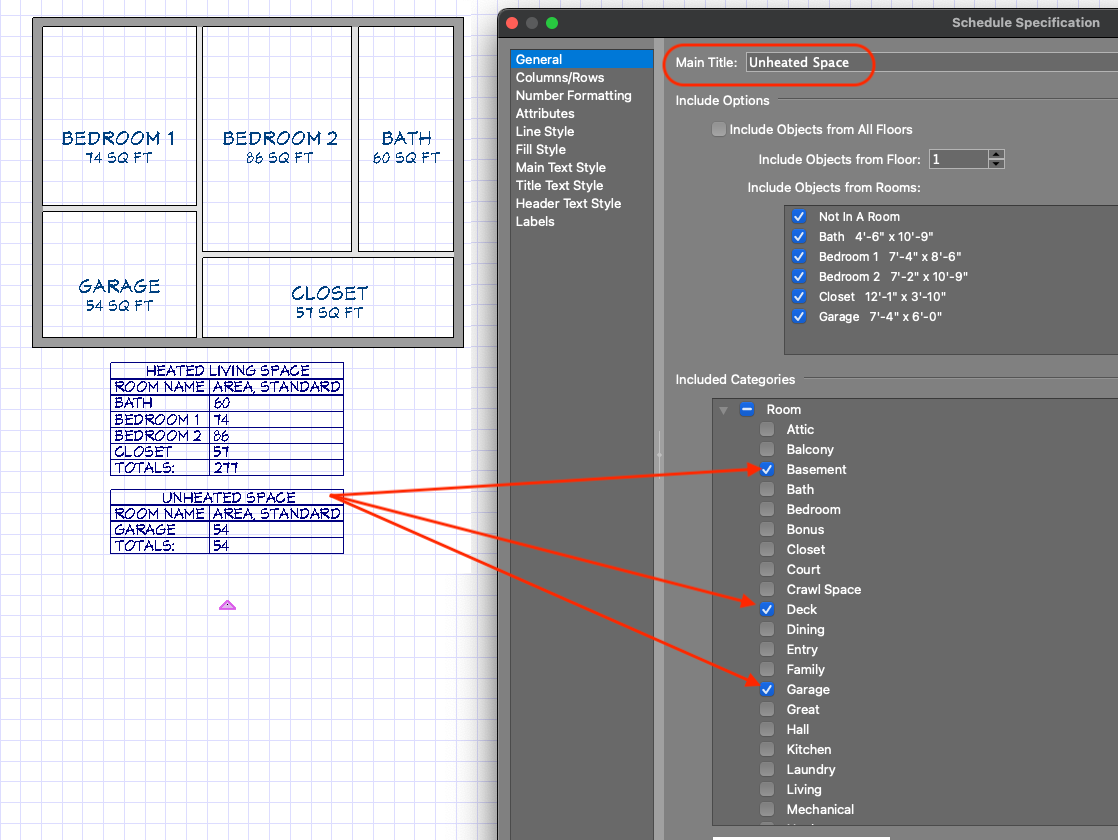

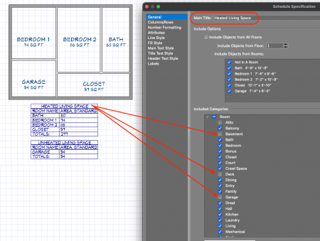

Chrisb222 Posted February 18 Share Posted February 18 20 hours ago, hyldahldesign said: some kind of label or text box in my plan that will add up all of the living area from all floors of my project and dynamically display it for me As Jason said, a Room Finish or a Custom Schedule will do this. And you can use reference display to show it on every floor if desired. Send it to layout. You can exclude rooms individually by unchecking Include in Schedule in the room's specification dialog, or by unchecking the individual Room in the schedule dialog. You can also restrict rooms by Type in the schedule dialog. Show by single floor or all floors. Pretty flexible out of the box, dynamically updates while drawing, but I don't know of any way to combine all heated rooms into a single report without displaying them all individually. You could get creative and crop out the rooms portion in layout if you really wanted to just show the heading and the totals. Here's a dumb little example from X17 Residential Template using two schedules: Link to comment Share on other sites More sharing options...

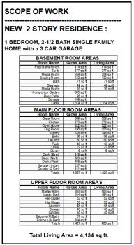

Joe_Carrick Posted February 18 Share Posted February 18 (edited) Here's my Scope of Work It's a Rich Text Box with 3 Schedules (one for each Floor). This is on my Title Sheet. It should give you an idea of what is needed. The Total Living Area is a manual sum of the individual Schedules Living Area columns, but could be calculated in a custom macro. Edited February 18 by Joe_Carrick 1 Link to comment Share on other sites More sharing options...

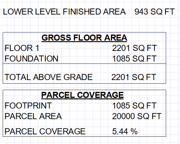

SHCanada2 Posted February 19 Share Posted February 19 18 hours ago, para-CAD said: So back in 1989 through 1995 I exclusively framed houses within 150 miles of Houston Texas. Every single set of plans had a small text box on the very first page, cover sheet that had heated space first floor heated space second floor those two numbers added together and then all the unheated space listed as garage, covered porch and the like. here it is even simpler for the past 25 years. main floor, second floor, foundation optional if there is a reno in the basement, then "finished area" which is usually total less utility room. So i have for my template 2 different ones to pick from plus parcel coverage if needed Link to comment Share on other sites More sharing options...
