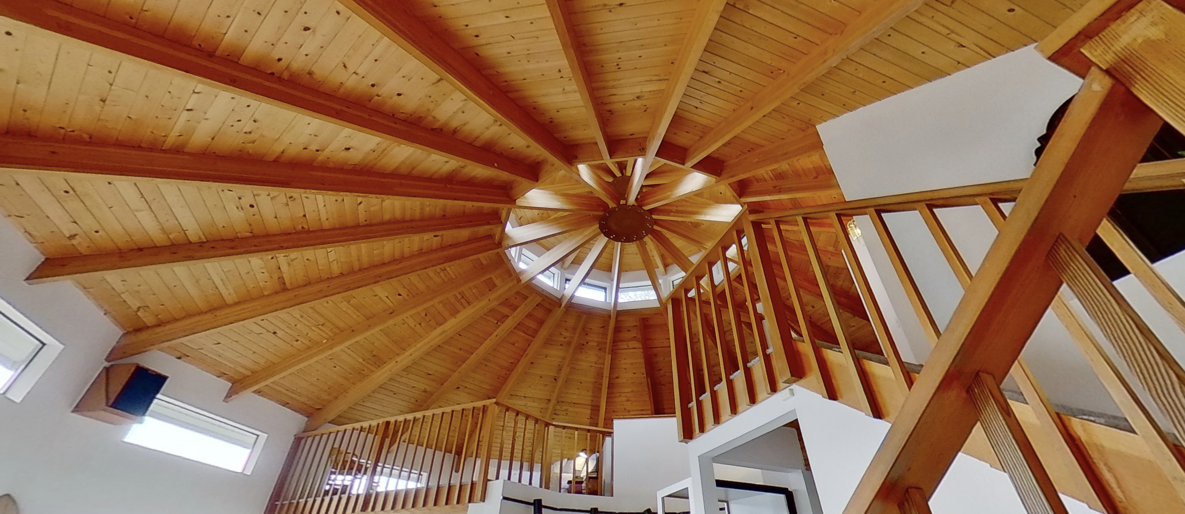

ImNewHere Posted February 12 Share Posted February 12 Hi all, does anyone happen to know how to model a round [12-sided] roof with a raised center cutout, as shown in this here photo? I don't know where to begin with this... Thank you! Link to comment Share on other sites More sharing options...
para-CAD Posted February 12 Share Posted February 12 (edited) Create it in sketchup then import it into chief as a symbol..........but you need EXACT sizes, pitch, and dimensions to make sketchup useful in this instance. Loom is cool. https://www.loom.com/share/eebe1a80e68f48e4932879d46a4eecb1 Edited February 13 by para-CAD 1 Link to comment Share on other sites More sharing options...
JKEdmo Posted February 12 Share Posted February 12 Looks like the floor plan is a polygon. There is a Polygon Shaped Room tool in the Build menu drop down. Try that. 2 1 Link to comment Share on other sites More sharing options...
CharlesVolz Posted February 12 Share Posted February 12 Set up your roof defaults, draw the room exactly how you want it. Use CAD lines to snap walls or the Build> Wall> Polygon Shaped Room tool. Turn on roof autobuild setting. Note that manually building roofs like this is problematic as they do not snap together correctly. 1 Link to comment Share on other sites More sharing options...

Mark3D Posted February 13 Share Posted February 13 Here is a rough go at it i placed some cad to use as snap points when drawing walls Round roof.plan 1 Link to comment Share on other sites More sharing options...
