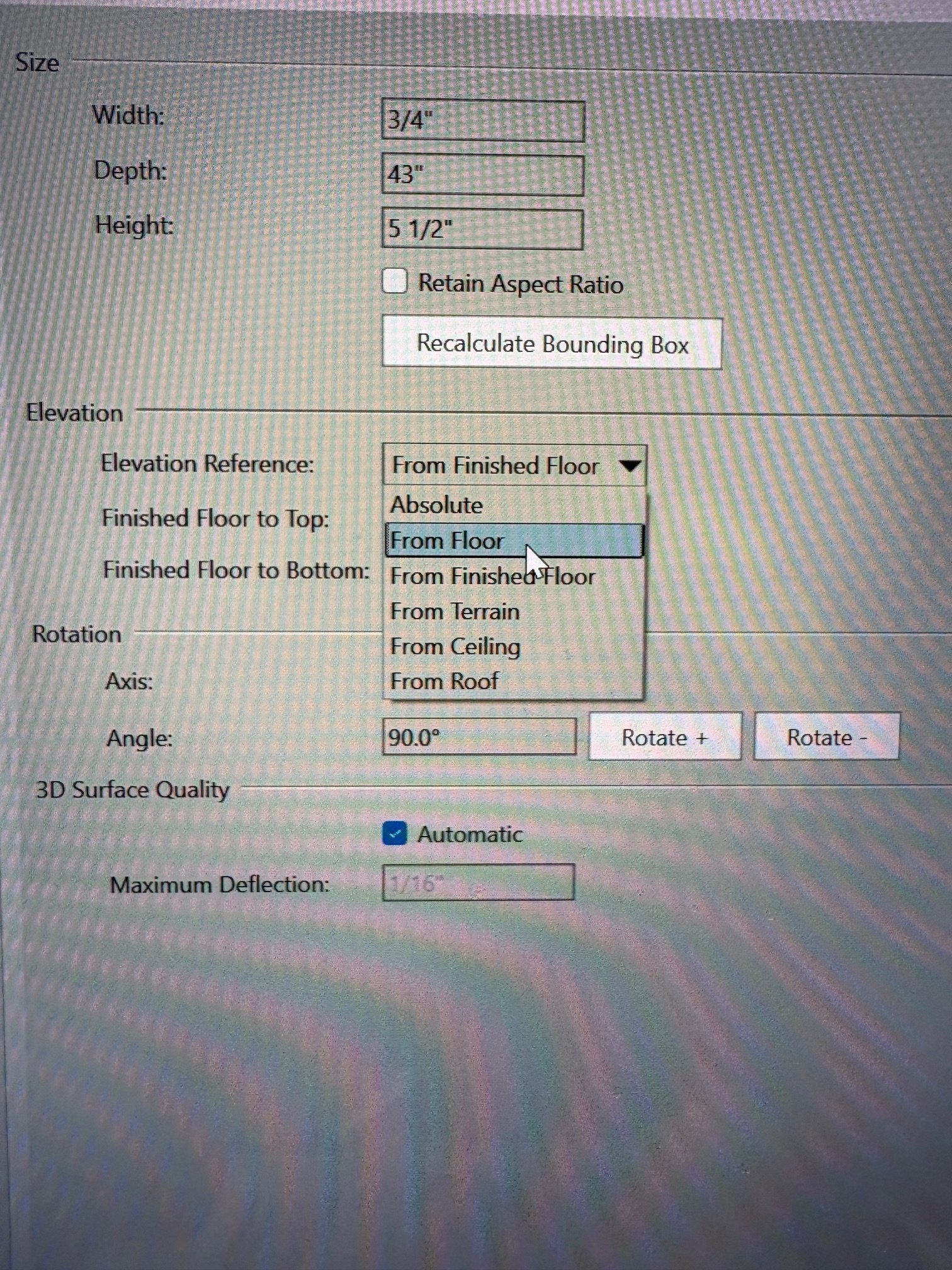

DrawingABlank Posted February 4 Share Posted February 4 Great! An additional tip that will help when pasting... The hot-keys for paste and hold are Control + Alt + V. Also for others having difficulties, after pasting, double check out the elevation reference. You still may need to adjust the height depending on the elevation reference for the 4000mm. Link to comment Share on other sites More sharing options...
