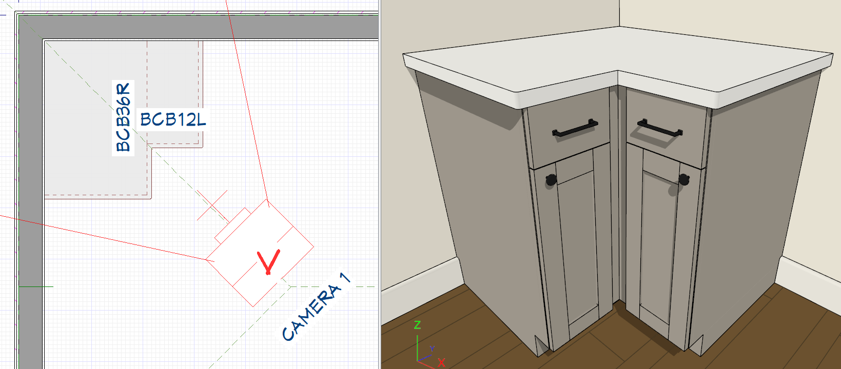

DBCooper Posted January 9 Share Posted January 9 If you want separate control over the 2 faces, you might have better luck using a "blind corner cabinet". You can do this with a 12" cabinet butted up against a 36" cabinet . 1 Link to comment Share on other sites More sharing options...

DBCooper Posted January 9 Share Posted January 9 (edited) Quote I can't figure out what I might have done wrong. You haven't done anything wrong. You can't customize the left and right front faces on an L-Shape corner cabinet separately. The program will always match them. If you need them to be different, then you need to use two cabinets. Edited January 9 by DBCooper Link to comment Share on other sites More sharing options...

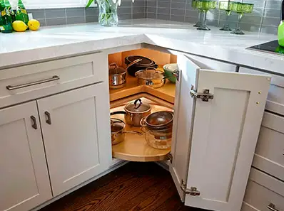

Joe_Carrick Posted January 9 Share Posted January 9 A corner cabinet typically is made with 2 doors attaced to each other opening in one direction. with a lazy susan inside. Having the doors that way makes it easier to access the contents. 1 Link to comment Share on other sites More sharing options...

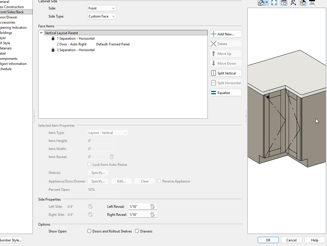

GeneDavis Posted January 9 Share Posted January 9 @ImNewHereChief's default arrangement, when specifying a corner cabinet, is for the doors to be hinged together and opened using the single knob shown in the screenshot here. The hinges used are 135 degree blind-corner type. I do this for all the corner cabs I do, and this setup is seen in almost every kitchen cabinet showroom you tour. You never came back and stated what you were after, so I am showing here that Chief defaults to this type of action. For other types, you can do things with two cabinets like others mention upthread. 1 Link to comment Share on other sites More sharing options...
