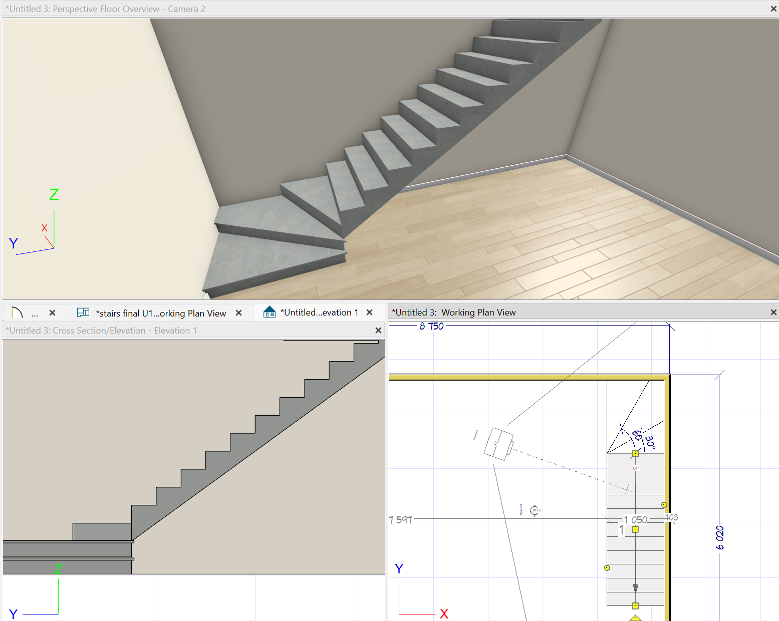

gelbuilding Posted May 3 Share Posted May 3 For stairs, the tread overhang can be adjusted using the style option. However, for the winders at the bottom, which I created using landings, no style option is available. All three winders are constructed from landings, and notably, the first winder connected to the main stairs has no overhang. Is there a workaround solution for removing the overhang on the landing? Link to comment Share on other sites More sharing options...
DBCooper Posted May 3 Share Posted May 3 It works for me. As long as the landing is connected to the stair, it should pick up the settings from the stair. Not sure why it doesn't work for you so you might want to post your plan. Link to comment Share on other sites More sharing options...

gelbuilding Posted May 6 Author Share Posted May 6 I’m still unable to get this to work. Please look at the CAD drawings provided by the architect. They used ArchiCAD, but it seems they couldn’t properly construct the stairs and may have drawn them freehand. Stairs CA.zip Link to comment Share on other sites More sharing options...
Mark3D Posted May 6 Share Posted May 6 I fixed it zoom in on your landings they are overlapping each other. stair winders sample M fix.plan 1 1 Link to comment Share on other sites More sharing options...

DBCooper Posted May 6 Share Posted May 6 Well technically, George didn't ask about code. He only asked why his landings didn't pick up the stair settings. Mark gave him the right answer. Apparently, Chief doesn't like having landings stacked on top of each other. It only likes landings butted up to each other. See the picture below showing stacked landings vs. butted landings. It would be nice if stacked landings worked automatically but you probably need to send Chief a feature request if you want that to change. 1 Link to comment Share on other sites More sharing options...

gelbuilding Posted May 6 Author Share Posted May 6 Hi Mark, Thank you for your help. I have a few questions regarding the stair: If the landings are aligned, will the stairs function as a single unit, with the winder overhang automatically adjusting to the stair configuration? How can I ensure the top of the stairs aligns with the top of the wall and integrates seamlessly into the room, Below, winders built in Australia. Link to comment Share on other sites More sharing options...
Mark3D Posted May 6 Share Posted May 6 1 hour ago, gelbuilding said: Hi Mark, Thank you for your help. I have a few questions regarding the stair: If the landings are aligned, will the stairs function as a single unit, with the winder overhang automatically adjusting to the stair configuration? How can I ensure the top of the stairs aligns with the top of the wall and integrates seamlessly into the room, Below, winders built in Australia. 1. yes see my file i just adjusted the landings and then all worked 2. They should unless you have changed the stairs automatic setting but i think more information is needed as to your exact problem like screen shot or the file also with this question i am not a expert with stairs someone else may have a better reply 1 Link to comment Share on other sites More sharing options...

gelbuilding Posted May 7 Author Share Posted May 7 Mark, I zoomed in to the landings but dont see the overlapping your suggesting. Link to comment Share on other sites More sharing options...
Mark3D Posted May 7 Share Posted May 7 13 hours ago, DBCooper said: Well technically, George didn't ask about code. He only asked why his landings didn't pick up the stair settings. Mark gave him the right answer. Apparently, Chief doesn't like having landings stacked on top of each other. It only likes landings butted up to each other. See the picture below showing stacked landings vs. butted landings. It would be nice if stacked landings worked automatically but you probably need to send Chief a feature request if you want that to change. Yours are attacked as shown in this post Link to comment Share on other sites More sharing options...
