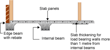

mthd97 Posted October 2, 2025 Share Posted October 2, 2025 (edited) Ages later. An absolutely awesome tool added to CA for internal footing beams to go under monolithic slabs. When it comes out from under the slab it creates a wall on top, I am not sure for what purpose but there must be a logical reason for that. Edited October 2, 2025 by mthd97 Link to comment Share on other sites More sharing options...
